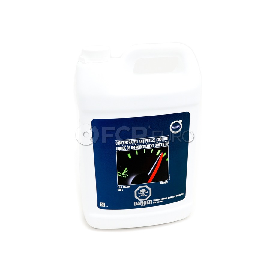

Go to FCPeuro.com and order some of this.This is what is guaranteed to be correct in your Volvo.

And send back one jug every 30,000miles of50-50 mix, and use the other to top off cars until they reach the change point.Blacklab467 wrote: ↑11 Nov 2023, 16:45 Go to FCPeuro.com and order some of this.This is what is guaranteed to be correct in your Volvo.
No way I’m letting any coolant in my cars stay for 100k or even 50k for that matter.
