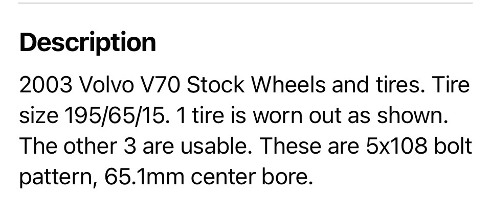

But these six spoke wheels are so doggone hard to find. There are a few off of 850s that look similar but wouldn’t be a perfect match. So, I’m half wondering if anyone has any they’d be willing to let go and half wondering if you guys think these wheels I found on Marketplace would work (and if you think they look good):
By my rough google search, the cars have the same bolt pattern and hub bore, but again, would be real nice to have a full set of matching rims (used, in crap condition is fine. As long as tires can hold air).

I am running P2 Volvo rims on my 00 V70R. P2 wheels are the same lug bolt pitch and hub diameter. The difference is usually the offset.
P80 rims are typically in the 43mm offset although I have seen some with a little less. P2 I have seen from 43-49mm offset. That means the rims sit further into the bod y of the car. With a P80 the main thing you have to watch for is with tires on the rims, make sure the rears are not rubbing on the parking brake cables and the fronts binding on the inner fenders, typically at the front of the tire on full lock.

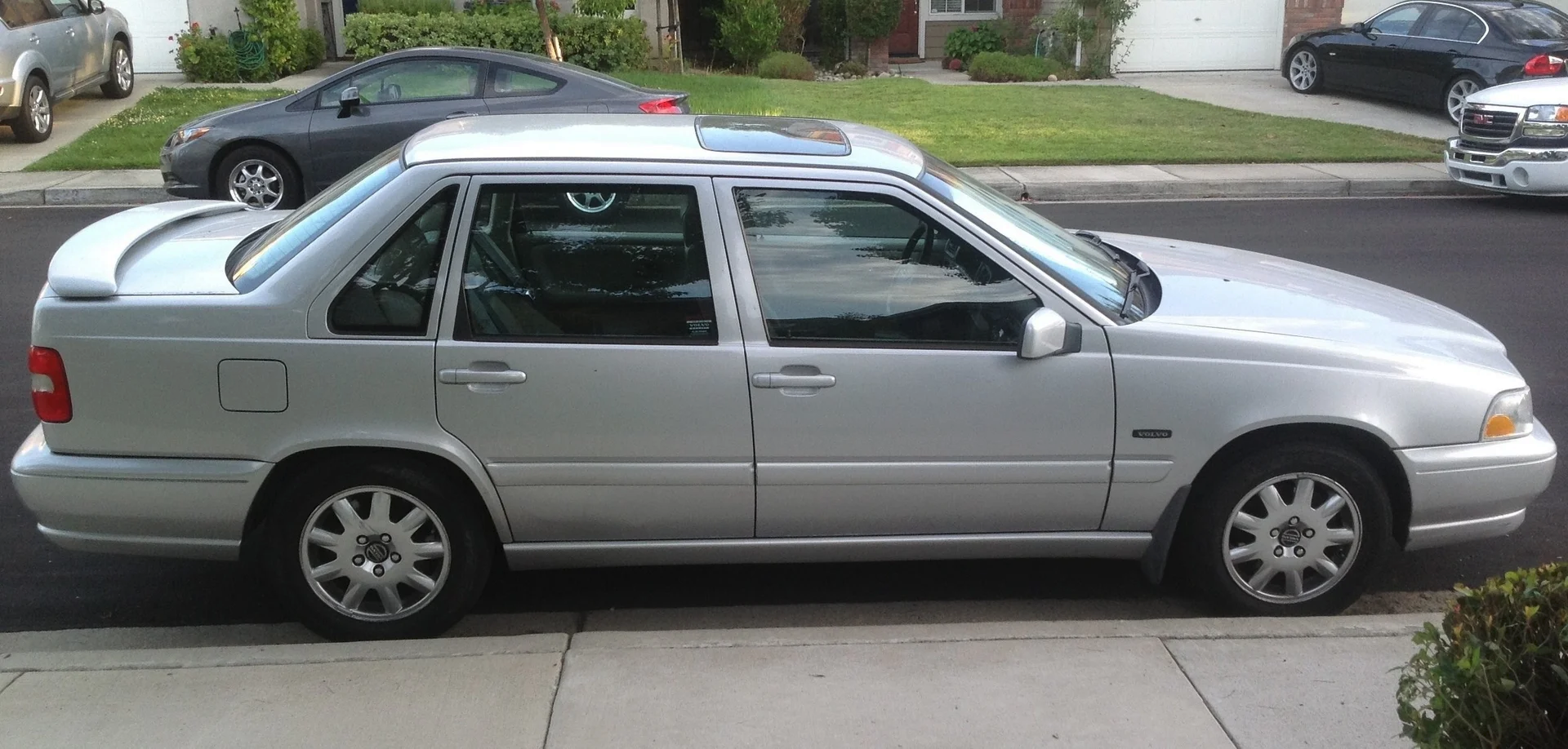

Those 15's came on my 00 S70 SE Base but I've replaced them with 16's from an 07 S60 2.5T. Plan to use the 15's on another car. I really like the V70 rims on the 98 S70 T5 owned from 2012 - 2014.
P80 & P2 rims are interchangeable in terms of center bore. Everything else is a matter of tire size, offset and rim width.
You can compare the rims here.
https://www.wheel-size.com/size/volvo/s ... egion-usdm

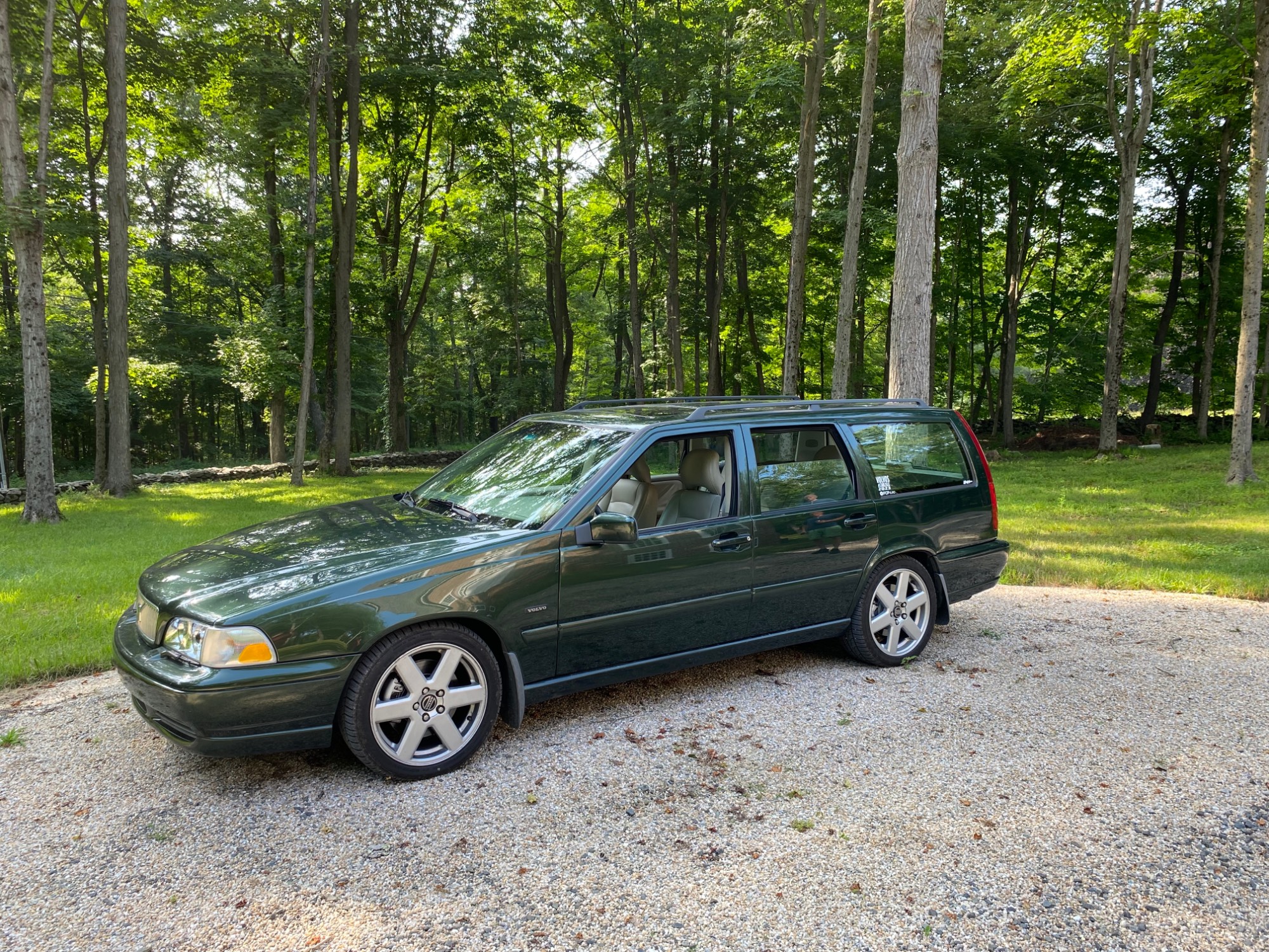

Yes, P2 wheels fit just fine. Here’s my ‘98 on 17” Neptunes (off an XC90):
I do have a crap but round and airtight set of 15” Naiads that I’d let go for next to nothing if you’re in the Northeast or upper Midwest
