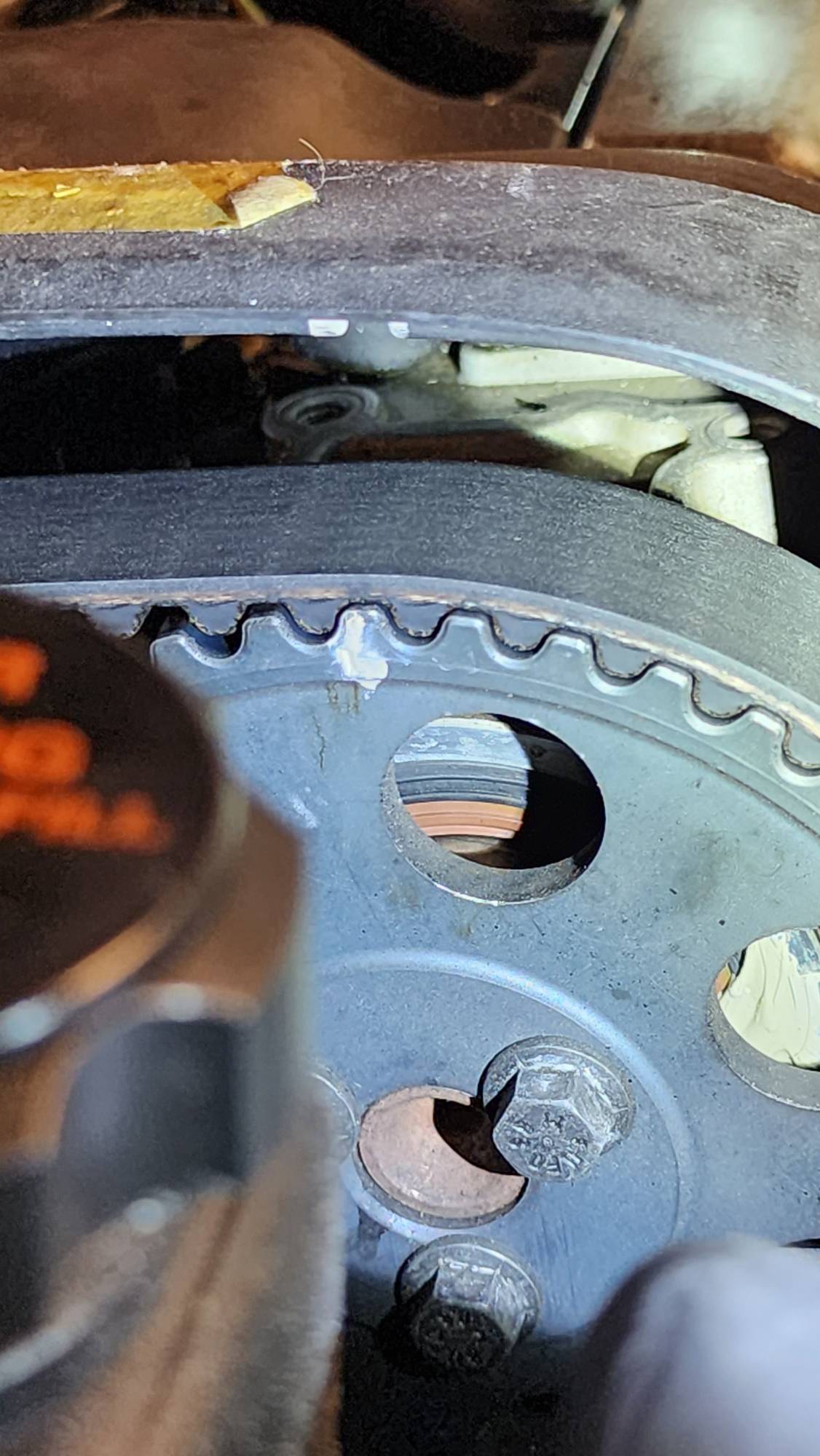

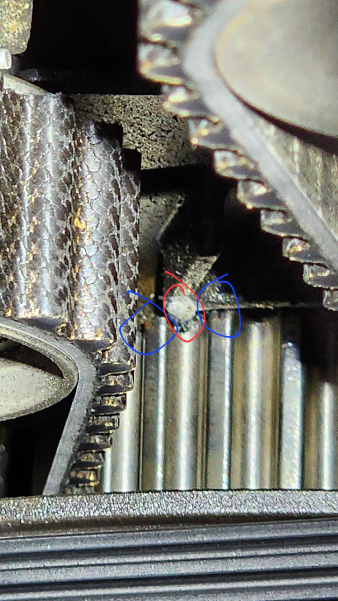

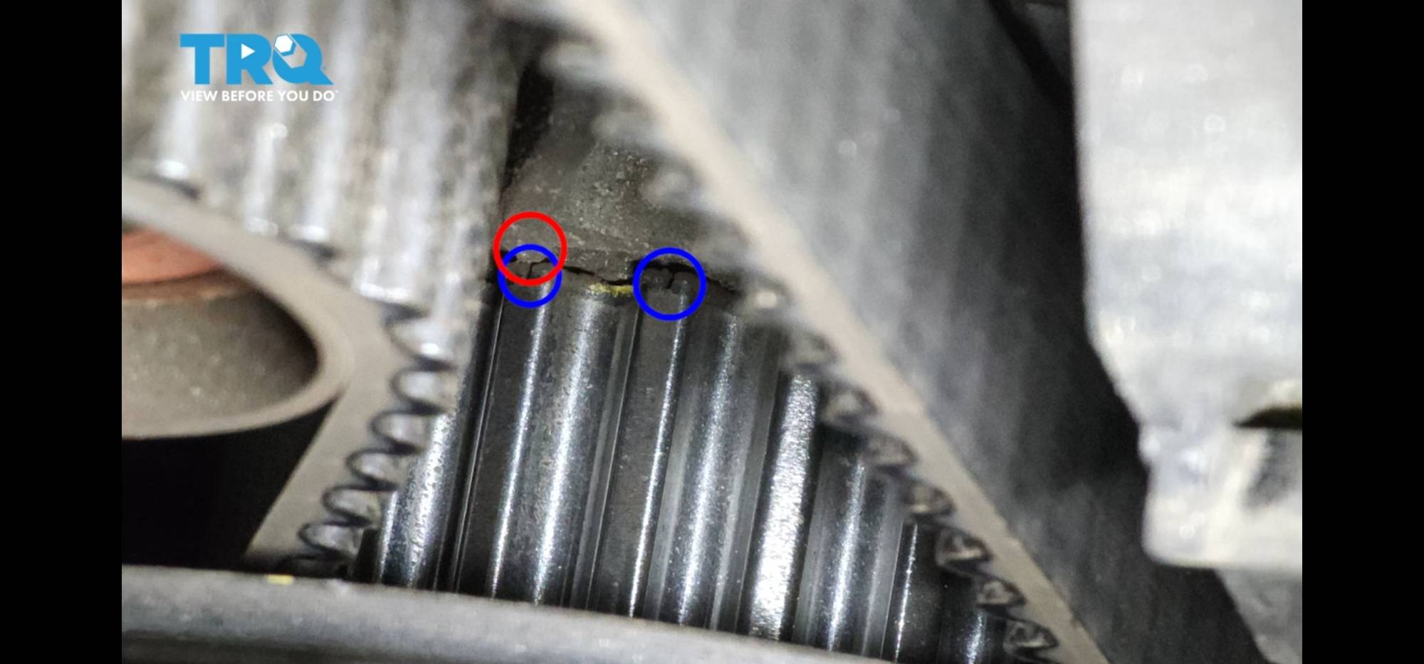

I just physically checked timing and it looks to be in time compared to whats in the TRQ timing belt change video.abscate wrote: 23 Nov 2023, 05:41 See my thread on ECM 644A, probably will show below in ‘ related threads’

- Posts: 36147
The VVT have to be within onectooth, with the VVT unit clocked correctly to get the valve timing right. It’s not just lining up the marks
