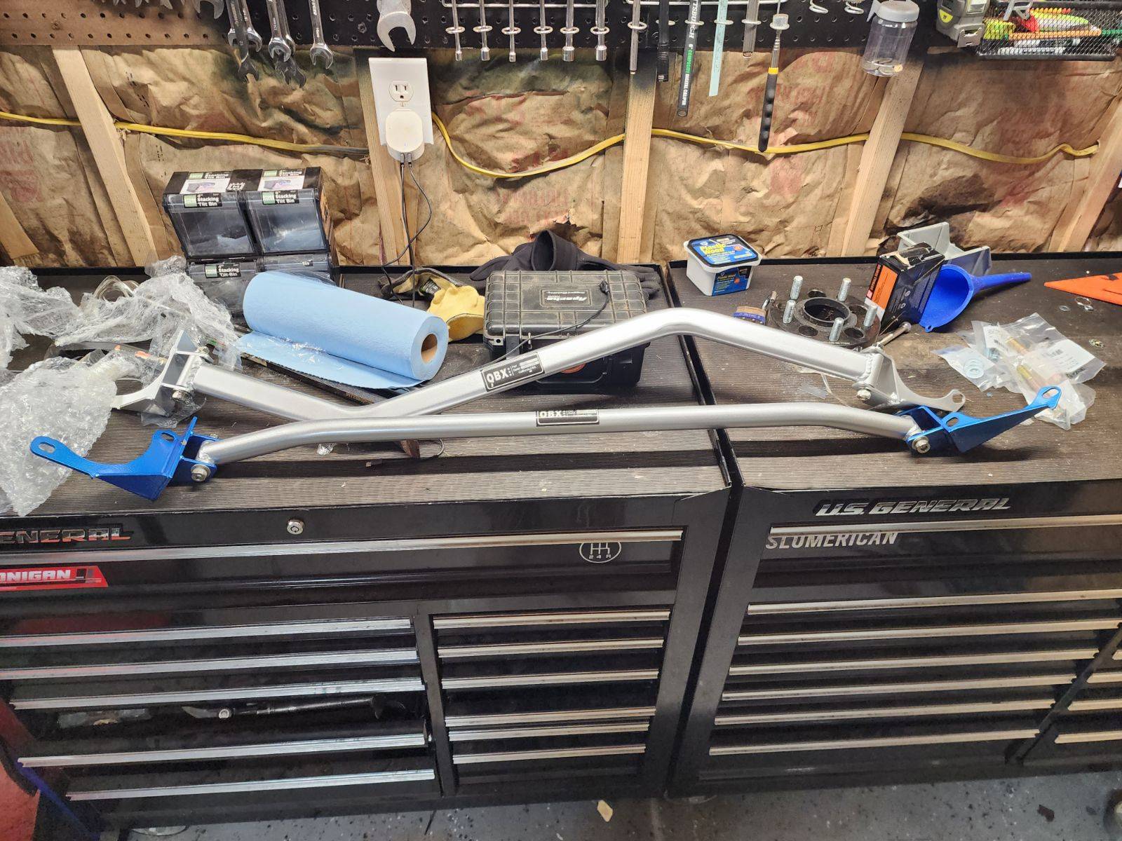

I took advantage of some sale on Walmart the other week and got both LHD and RHD OBX front strut bars. I think it was like 200ish shipped for both

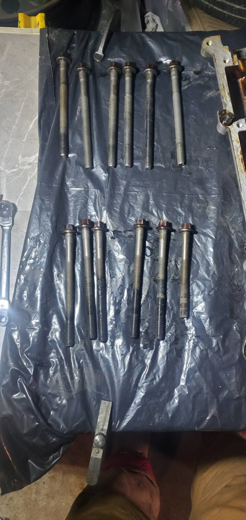

So far the cascade of events being rusted fuel line causing low fuel pressure which caused a backfire which blew out the exhaust manifold which happened to be RTV'd in place and needed the cylinder head to come off as well as to replace some valve stem seals which has led to a broken head bolt. On the bright side, it's on the very front of the engine so it's the easiest to access.
