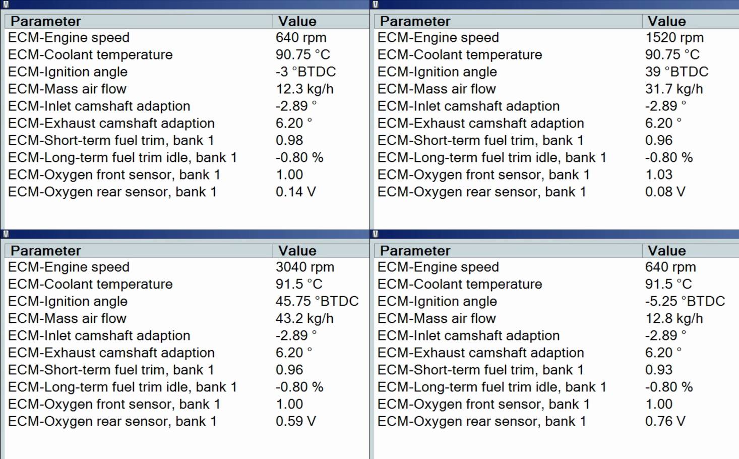

Looked at some things in VIDA while parked
What am I looking at here? Seems like some conflicting data... Exhaust sensors indicate rich condition I think? But LTFT and Equivalence Ratio doesn't?
does it all point to bad O2 sensors? AFAIK they have never been replaced...But I only have service records since ~50k.
Cat going bad? I've gotten P0420 in the past, but not this frequently.
or is this something more serious and complicated?

Since you own DiCE/VIDA, you can read VVT adaptation angles after revving the engine above 1500 RPMs (self-test happens there).
Bosch oxygen sensors in this car have lifetime of 150k km (km, not miles). If you haven't replaced them yet, they are long overdue.

Adaptation angles -3 for Intake; 6.2 Exhaust. In normal ranges I think.
So I guess it's down to O2 sensors then, seeing as they are long overdue.

That O2S sensor is reading mighty suspiciously.
