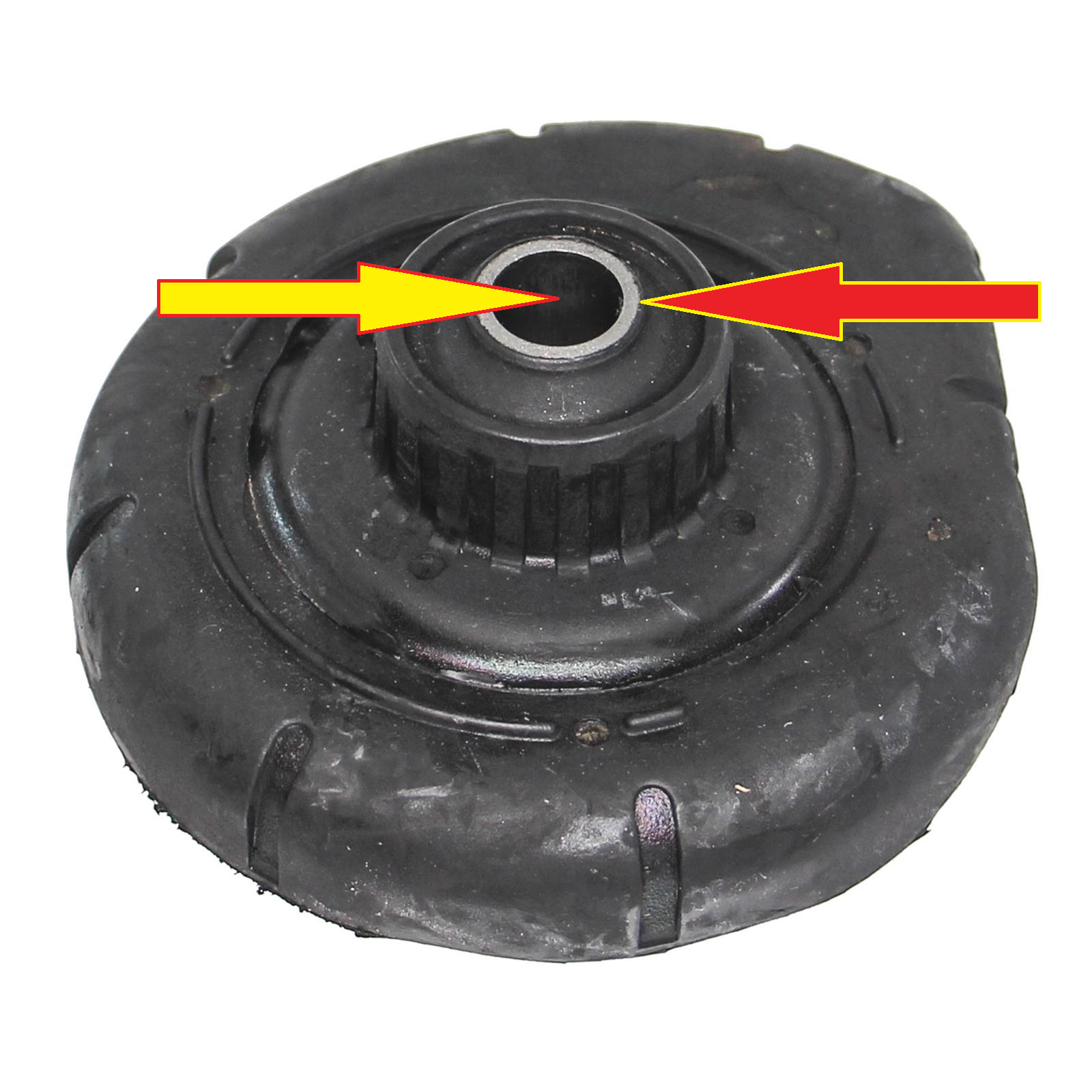

Are you able to spin it 360? You either have a strong hand or the assembly is missing a washer of sorts so it's floating and can move about freely inside the metal collar. That or the collar has separated from the rubber at the very edge so it still looks good. My guesses?

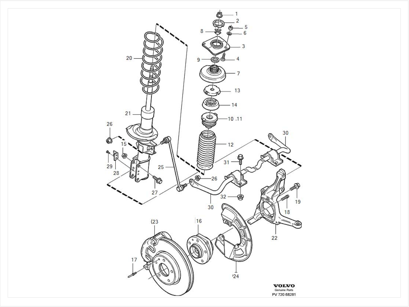

This is from Volvo, 1999 S70 GLT. Be sure all the washers and other parts are all there. The top nut is suppose to tighten the bottom of the strut to the #13 washer against the spring seat / strut mount #7. Per my initial response if something is missing the strut might not be sandwiched tight against #7 and could cause the strut to spin inside the collar. If I'm mistaken someone please chime in.
#13 washer is suppose to stop the strut from going into the hood if the spring seat's rubber and collar separate.
https://usparts.volvocars.com/a/Volvo_1 ... 1ABC91B739

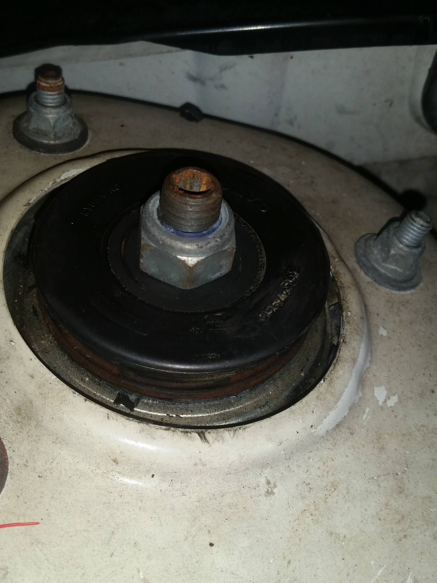

Something looks really worn there. That top of the strut seems way off center compared to mine. Like MoVolvos says, the metal bushing in the spring seat is probably torn loose.
