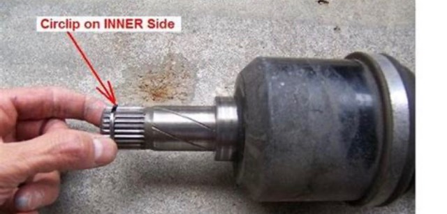

Good on you for giving it a shot. Wheel bearing and CV shaft are both DIY territory. Driver side CV shaft can be tricky with the circlip to get it out and slid/locked back in.
My main concern would be having had something fall into the transmission. Can you verify the circlip is still on your old shaft you removed? Some questions:
Will the shifter move out of park?
Or does the transmission shift but the XC90 just doesn’t move?
If you move the transmission to neutral with the front tires off ground will the wheels spin freely?
Hoped you get it sorted soon.
