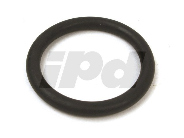

I've installed the Subframe O-Rings on a 2003 S80 T6 to correct the pop / creak noises but haven't experience any noise from the axles yet.
https://www.ipdusa.com/products/8283/Su ... vo-8638585
