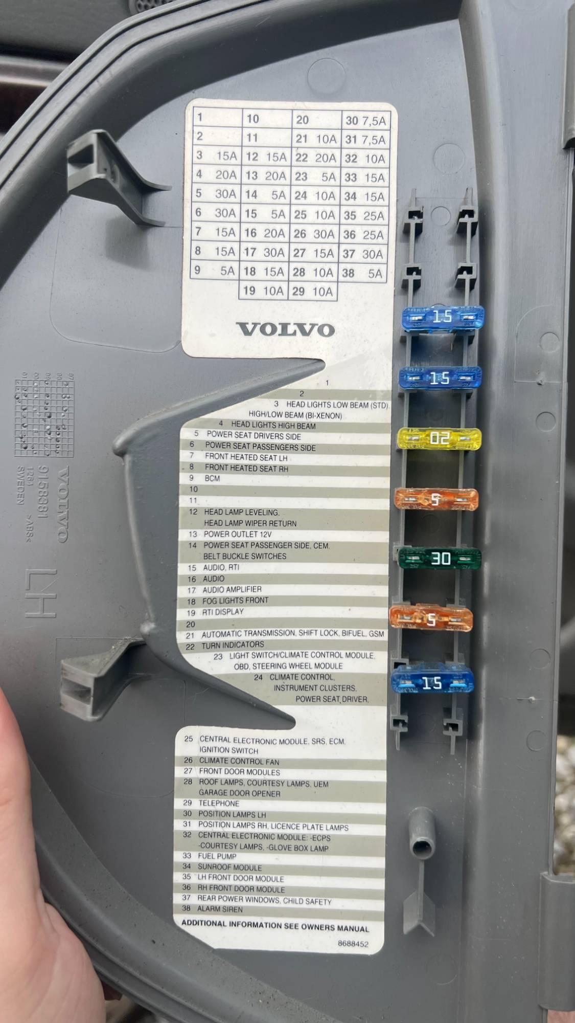

To my knowledge, no. Whenever I put the key in the first position to check for any errors is when I received the SOS beep - which isn't documented as a feature this car has anywhere online or in Volvo's documentation.volvolugnut wrote: 26 Jan 2024, 07:54 Sounds like this is the emergency flashers and the beep is the relay to drive them. Perhaps with some other cross wiring issues. Has the emergency flasher button been accidentally pressed?
I have the battery pulled and on a charger/maintainer until I determine if this is a parasitic draw. My thought process is leading me towards the alarm module - I never lock the doors because it is known bad and would drain the battery if I activated it. I'm curious if, after I get to the module and disconnect it, if this will resolve my issues.

If you are referring to the siren module in the front right wheel well you should be getting an error message about it. If its like my 2000, you should be able to pull the 5amp fuse on the drivers side of the dash to take it offline.

No error message unless I arm it, but I don’t do that. Is the fuse tied in with any other system? Like an ignition immobilizer or anything?JBaldy wrote: 26 Jan 2024, 09:28 If you are referring to the siren module in the front right wheel well you should be getting an error message about it. If it’s like my 2000, you should be able to pull the 5amp fuse on the drivers side of the dash to take it offline.
The 5 amp fuse I'm referring to is for the Siren module only and is labeled as such. This is the module that has its own internal battery that can take a dump on the PCB rendering the whole thing useless. Would have to spend a couple hundred to replace it or if you are lucky and the board is salvageable an improvised replacement battery could fix it. Lots of youtube videos about that. With the fuse pulled I do get a Siren error message.

Fair enough. My siren is known bad, that's why I don't lock the doors because it will drain the battery. It seems that a severely bad/damaged siren module can cause parasitic draw.JBaldy wrote: 26 Jan 2024, 11:35 The 5 amp fuse I'm referring to is for the Siren module only and is labeled as such. This is the module that has its own internal battery that can take a dump on the PCB rendering the whole thing useless. Would have to spend a couple hundred to replace it or if you are lucky and the board is salvageable an improvised replacement battery could fix it. Lots of youtube videos about that. With the fuse pulled I do get a Siren error message.

So, I have an issue that's beyond the fuse - because the fuse isn't installed for the alarm module.JBaldy wrote: 26 Jan 2024, 11:35 The 5 amp fuse I'm referring to is for the Siren module only and is labeled as such. This is the module that has its own internal battery that can take a dump on the PCB rendering the whole thing useless. Would have to spend a couple hundred to replace it or if you are lucky and the board is salvageable an improvised replacement battery could fix it. Lots of youtube videos about that. With the fuse pulled I do get a Siren error message.
