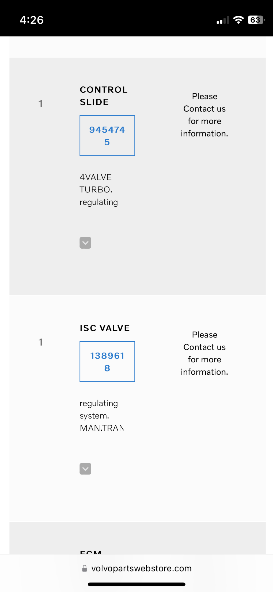

Two part numbers found

Interesting, that first part number if you check it on FCP is not for a white block. Only listed for a red block. The ones I pulled were both from P80's, but both were NA motors. One was from a 97 850 NA the other from a 98 S70 NA.
A noticeable difference to the part number you list as the 1389618 is if you look at the inlet and outlet they are at 90 degrees to each other. The ones I pulled are opposite each other also but parallel. The version 1309618 would not work with the pipework.
https://www.fcpeuro.com/products/volvo- ... 40-1389618
This is are ones I have: 9454745
https://www.skandix.de/en/spare-parts/e ... e/1009892/
Checking their listing this only fits P80's and 960/V90/S90 RWD cars
