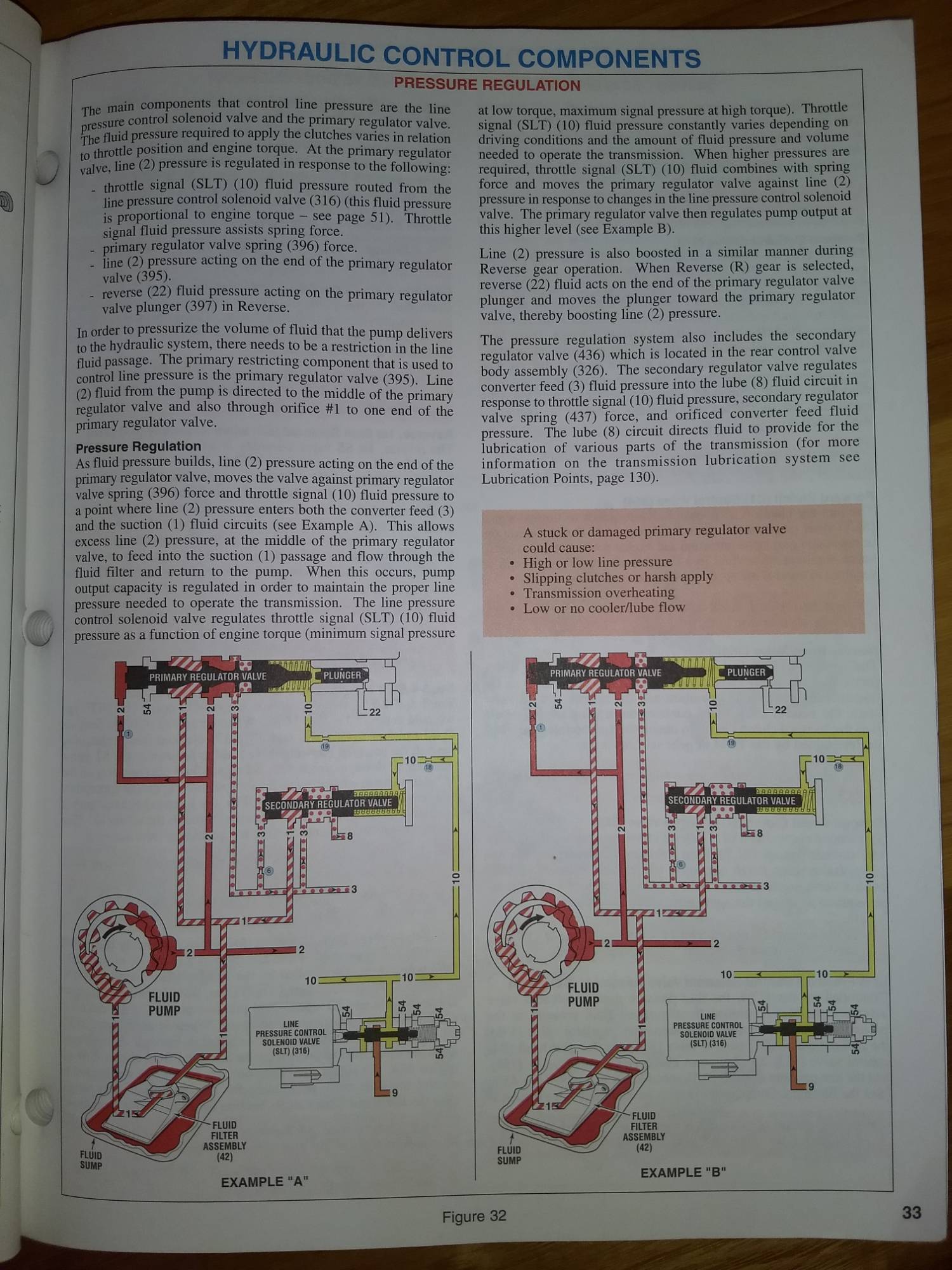

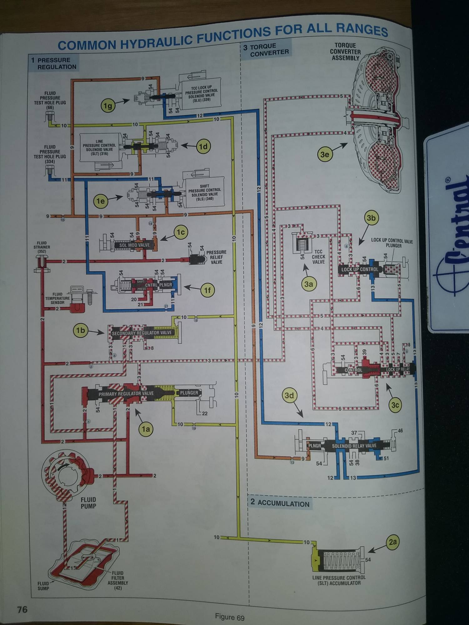

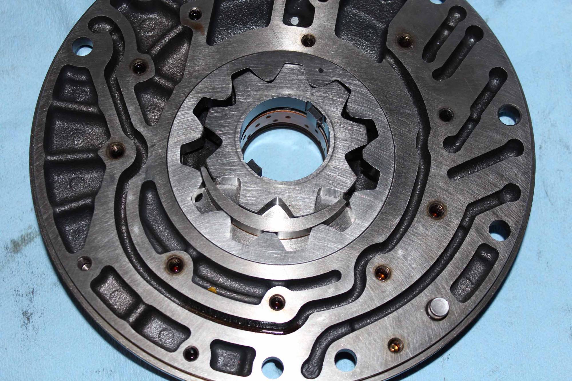

I've attached a couple of pages from the manual VTL has, which shows the primary pressure feed circuits in the valve body. The pump is pretty straight forward, if there's nothing wrong with the fluid inlet suction through the filter (not clogged, both seals in place) the pump should suck fluid though the filter inlet path and if the inner pump gear keys are not sheared off the pump should output fluid to the valve body. Inside the valve body there's the main pressure and secondary regulators that feeds all the circuits.
Because you've inspected the pump and found nothing obviously wrong and the fact that the valve body was "full of dirt" I'm leaning towards a problem with the valve body. The valve body should have absolutely no amount of debris in it and I'm not sure what the dirt is in you've mentioned. No doubt you cleaned the valve body but the fact that it was full of dirt to begin with is not a good starting point and you'll need a known good valve body to get the transmission working again.
It's not clear to me, did you rebuild the original transmission in the car that originally had a no drive condition and all plates toasted?
From VTL's manual, pump and primary, secondary regulators
Pump, any problems with the pump or inlet suction path should be obvious.
51sn oil pump with gears installed.jpg (398.46 KiB) Viewed 143 times
