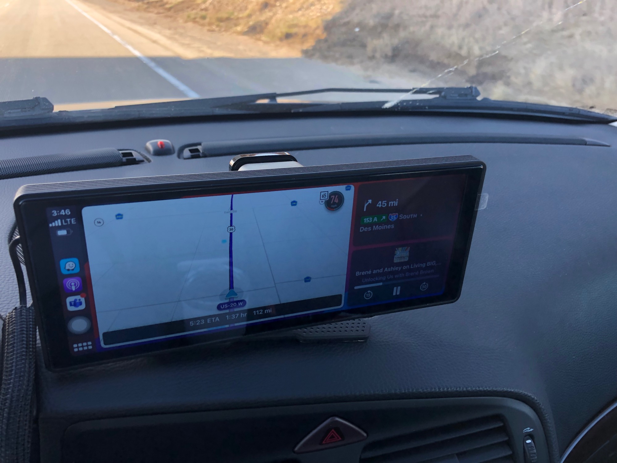

In an effort to add some technology and comfort I splurged a whopping $100 on an Apple CarPlay display for my 08 S60. Hooking up the backup camera seemed a bit over the top but I figured I was this far so might as well. Wiring to the trunk lid only had less than a foot to spare, running audio through Aux. Ran cords from dash under the steering column and tidy’ed with some sheathing. Power is though rear seat console socket…didn’t find a fuse in the panel with switched power, that sound right?

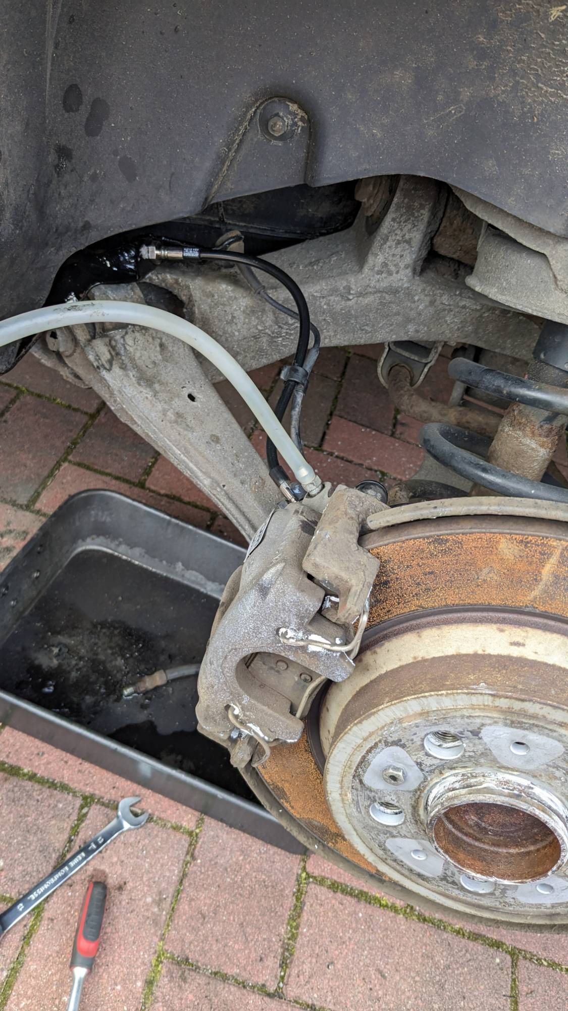

My Volvo S60 got a new hand brake cable, because I assumed it was seized. It actually wasn't the cable but the lever which spreads the two brake shoes. Since everything was apart already, I installed the steel braided brake hose, which was laying around since January... of last year

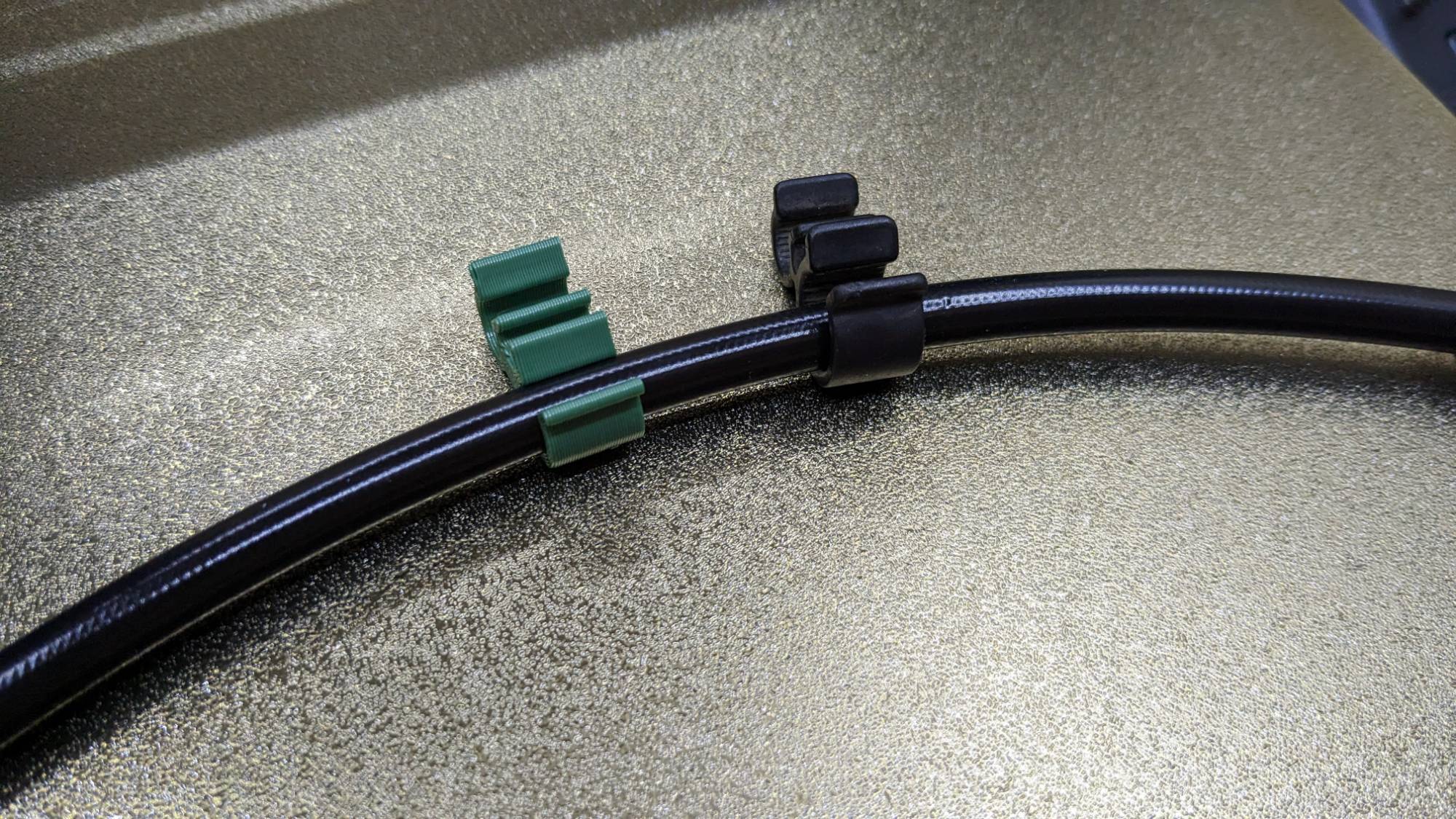

Everything went well (except that the installation of the hose in the bracket was an absolute pain due to severe lack of space), but the retaining clip for the ABS wire on the brake hose doesn't fit anymore. The steel braided hoses have a much smaller outer diameter than the original rubber hoses.
This is a perfect task for the 3D printer and first I replicated the original retaining clip (part number 3523937), which is no longer available from Volvo and then modified it to fit the steel braided brake hose
Maybe someone finds this useful as well, so I published the models on Printables: https://www.printables.com/model/792847 ... ip-3523937
In the future I want to replicate more clips which are no longer available. The next one is probably 9470430, which is the clip holding the wire of the O2 sensor to the brake hose.
