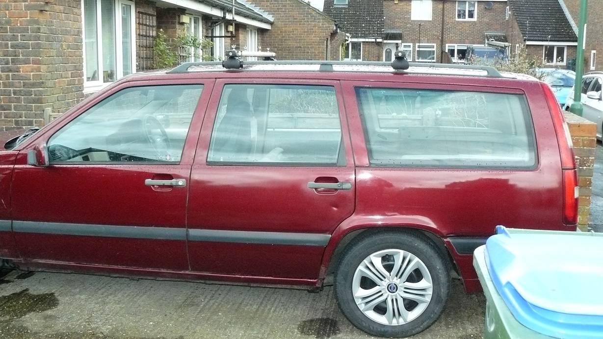

hi all well i been racking my brains trying to stop water getting in this damn car ,so far i have removed and replaced all the seals on the roofbars and replaced the door seals but still i have water getting in high up,ie headlining and the little plastic coin tray next drivers seat are soaking wet,thankfully ive not yet fitted the replacement headlining because ive been ill and weather has not helped.
are these known for windscreen leaking? i have tried some seek and seal to no avail.

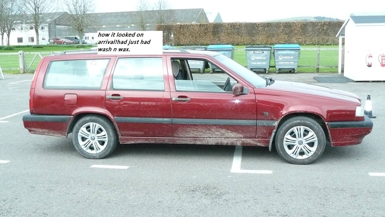

if anyone can help id be grateful,heres a couple of pics of the old girl halfway through a polish then it rained!cheers all.

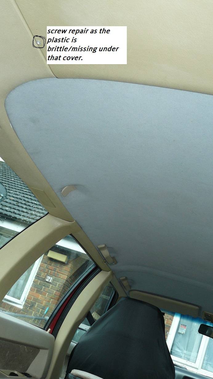

hi all well at long last it seems to have stopped raining!so i have made a good start on replacing the horrid wet smelly baggy headlining on my old 850se,only badly broken one piece of the brittle plastic trim though several pieces where broken and only held together with the various fastenings and as soon as you undo them bits of plastic fall down!
after a jigsaw puzzle i worked out where the bits came from and have done my best to superglue them back in place. i have ordered some new soundproofing stuff as all the original has come unstuck and hanging.

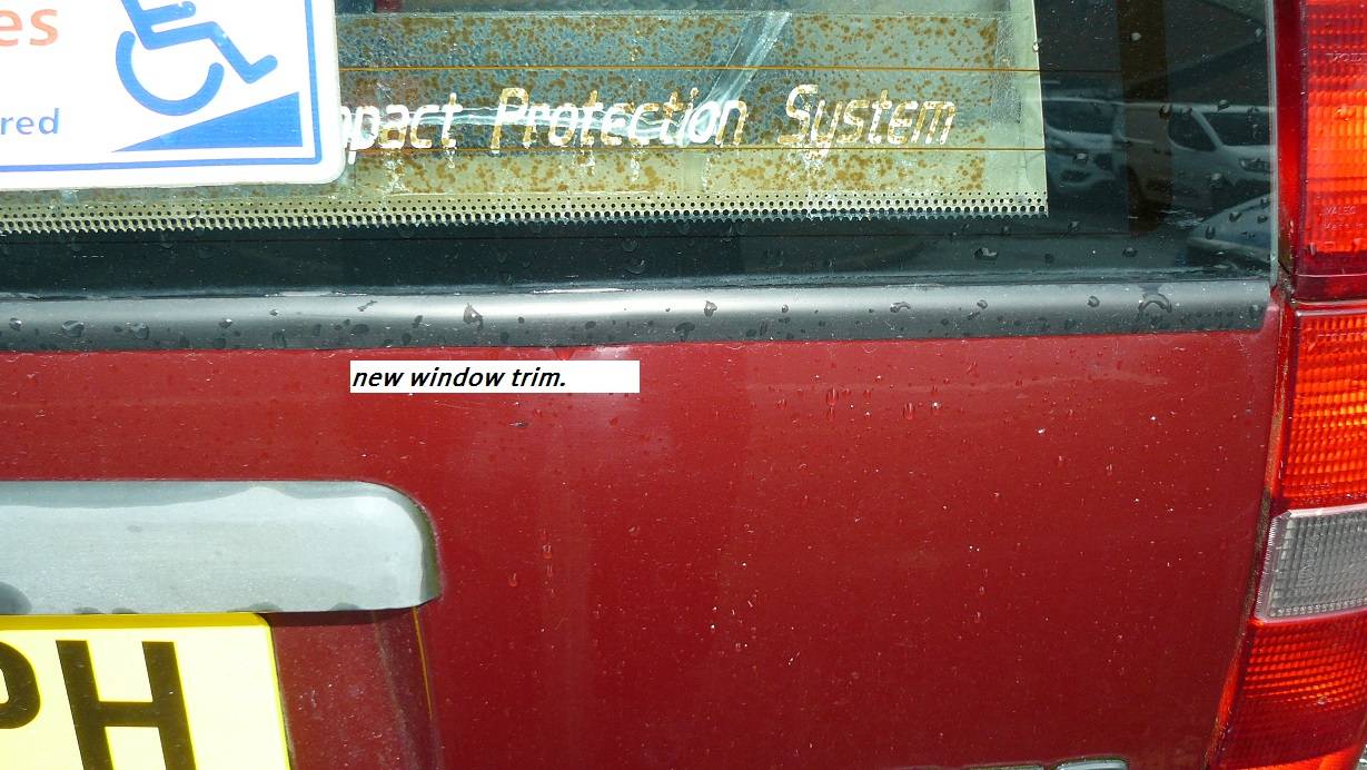

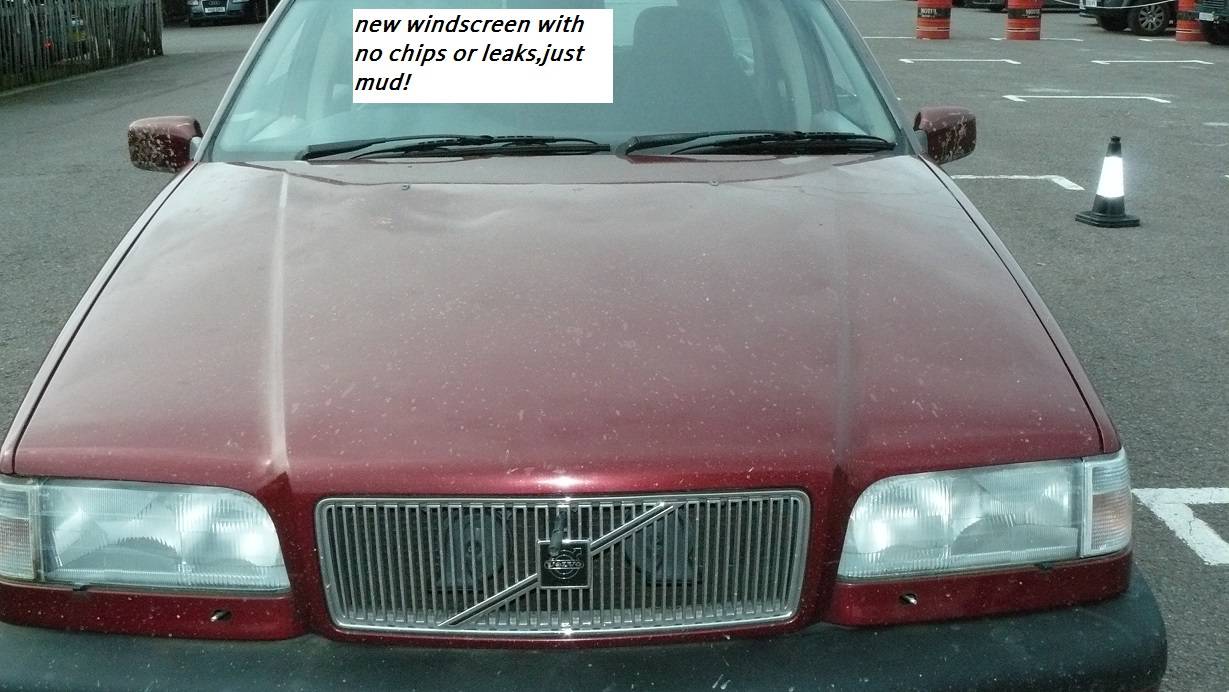

just add the windscreen was the main culprit of the water ingress and since its been replaced and i left a dehumidifier on overnight for a couple of days it was dry enough to not be too horrid to work on,the dust from the sponge is awful bad and dust and copd do not mix well,mask n95 and full face goggles,i will not die atleast till its finished!

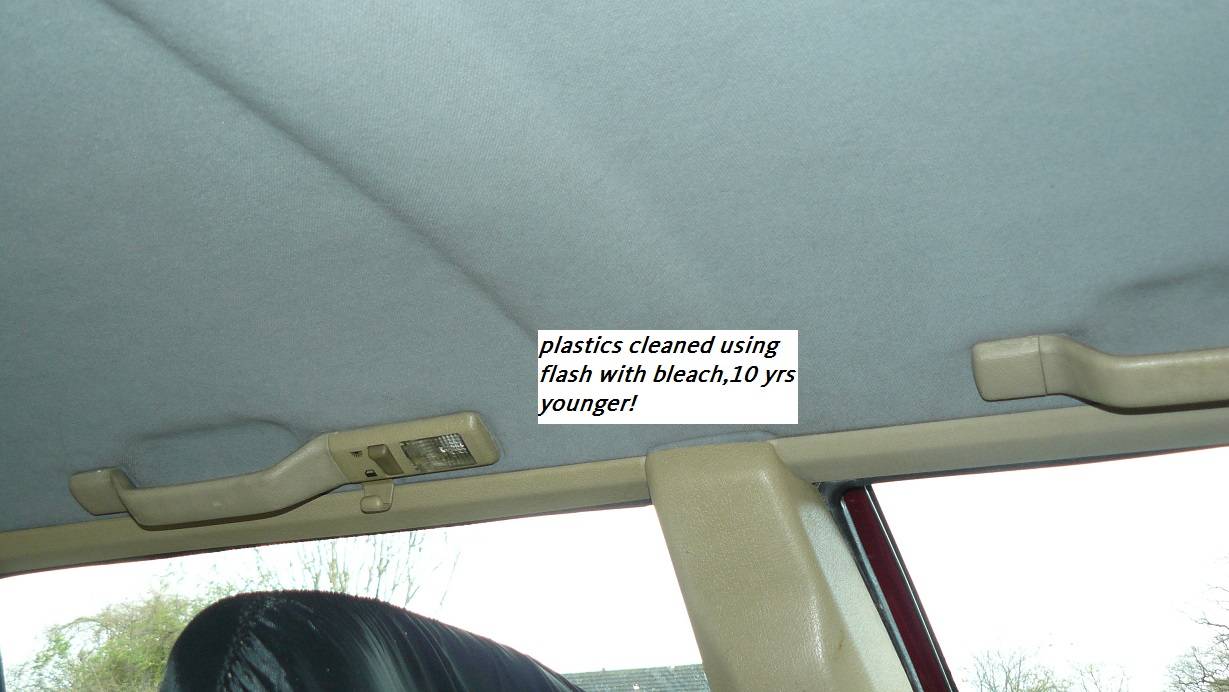

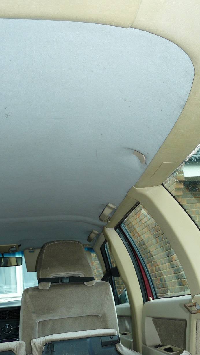

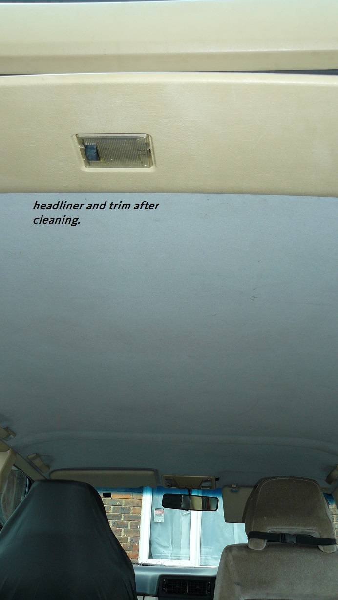

hi all well the car is done!a nice new headlining from a mk1 v70 its a sort of grey colour but fits perfect,i did have to reglue the front portion along the windscreen edge but evo stick and some of the missus clothes pegs and left overnight to proper dry seems to have done the trick nicely,the original was beige colour but as i got the handles and different colour courtesy lights along with lots of useful plastic trim retainers etc fitted to suit.
i spent a couple of hours gluing myself to various broken plastic mounts and finding certain colour plastics do not bond with superglue but bond to the main trim plastic very well,also found out it is not a good idea to use toilet tissue to wipe up spilt superglue as it starts smoking and gets nearly hot enough to ignite!

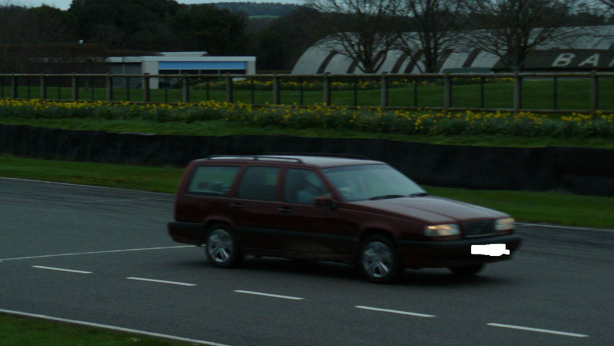

hi all well yesterday was spent speeding around in the old girl and apart from a new squeek i think from the ns front wheelbearings the car survived undamaged!and even though it is just a 2.5 10valve with 140bhp when new,30 yrs and 160 thousand miles later some of the horses have died but it can still be a car you can drive your granny in or drive to goodwood and tear around having a great time!its very dirty in the pics due to poor signage at the goodwood circuit i ended up driving the wrong way and ended up in a muddy field full of diggers and mud,turning around proved difficult and some wheel spins before finding some grip made it look more like a rally car!
i did take some rather poor pics of my mate steve driving my volvo,love this old car!

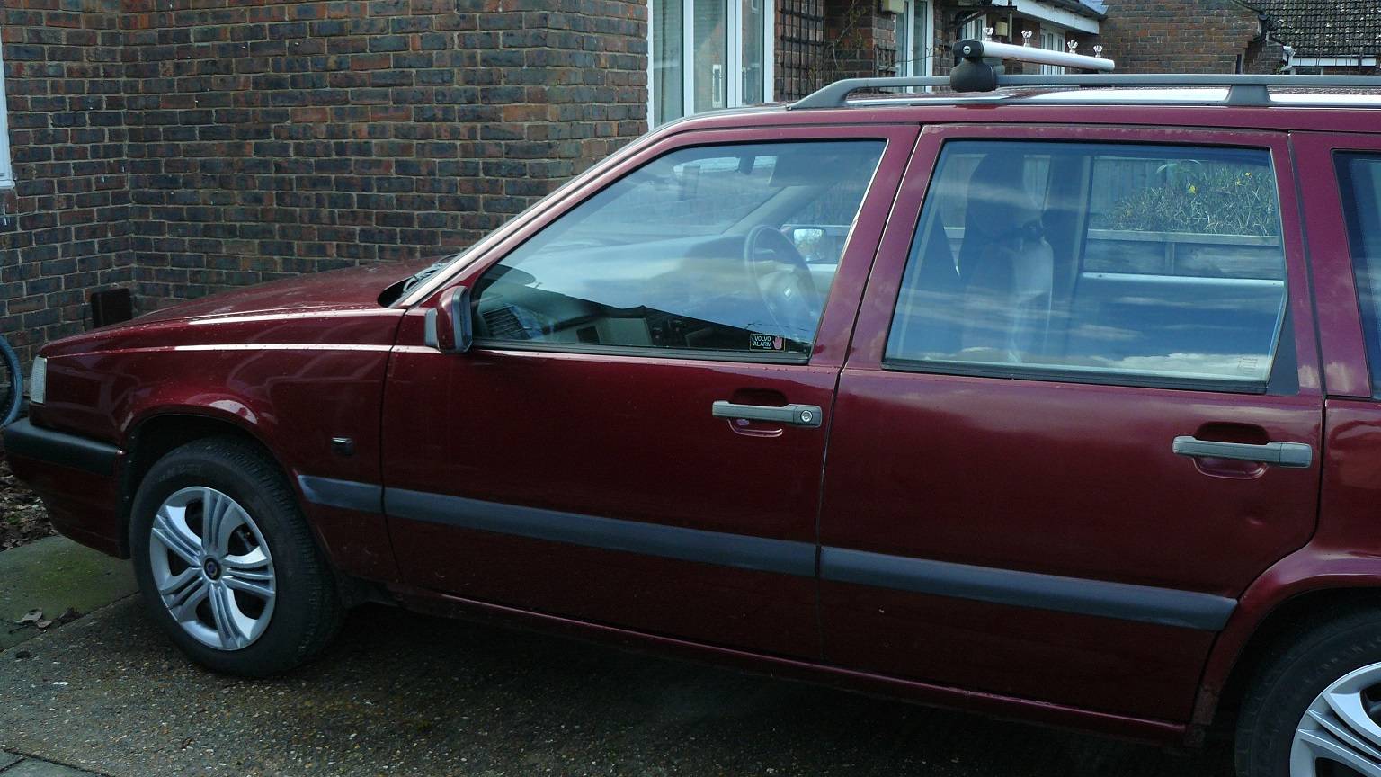

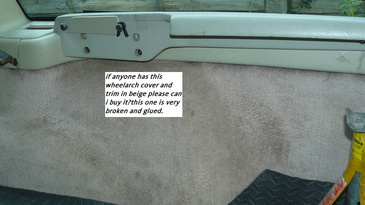

hi all i took some pics today of the old girl after much hard work and some expense but now i am happy with the car mechanically and interior all bar one panel have been cleaned and repaired all and have a clean non wet and baggy headlining for the first time in 3.5 years ownership,gone from wet floors due to heater matrix leak and wet headliner due to leaking top of the windscreen to nice clean and dry,the missus vax carpet washer and a steam cleaner removed most of the coolant stain.
i am still in the market for a bonnet and the trim as pictured and would be happy to collect and pay cash for good condition trim.

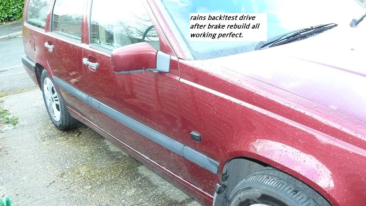

also due to the trackday showing up a sticking caliper on the n/s/f wheel i rebuilt both the original ate calipers with a new set of pistons and seals and gave a coat of vht paint,brakes are now perfect.
next up is chasing my ex boss to do the paintwork!pics for you,bless the humble volvo base.
