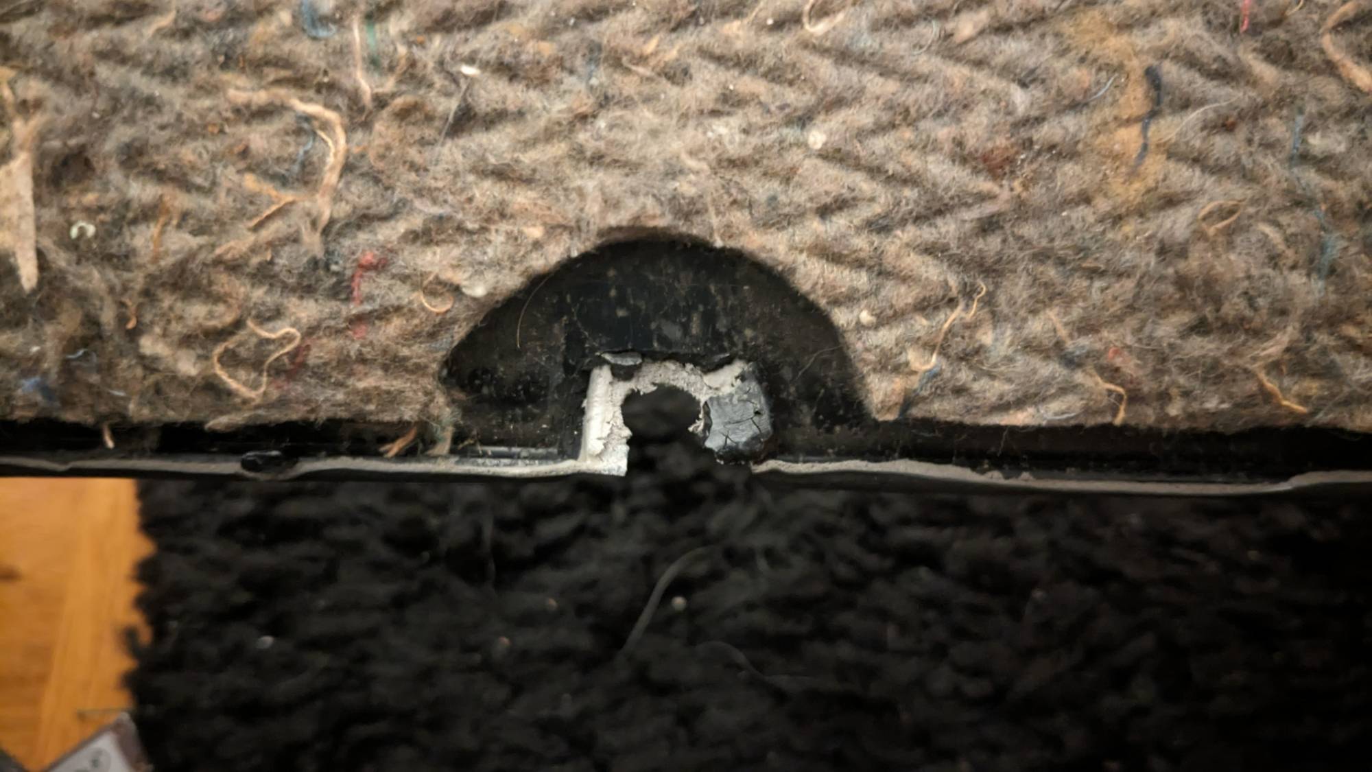

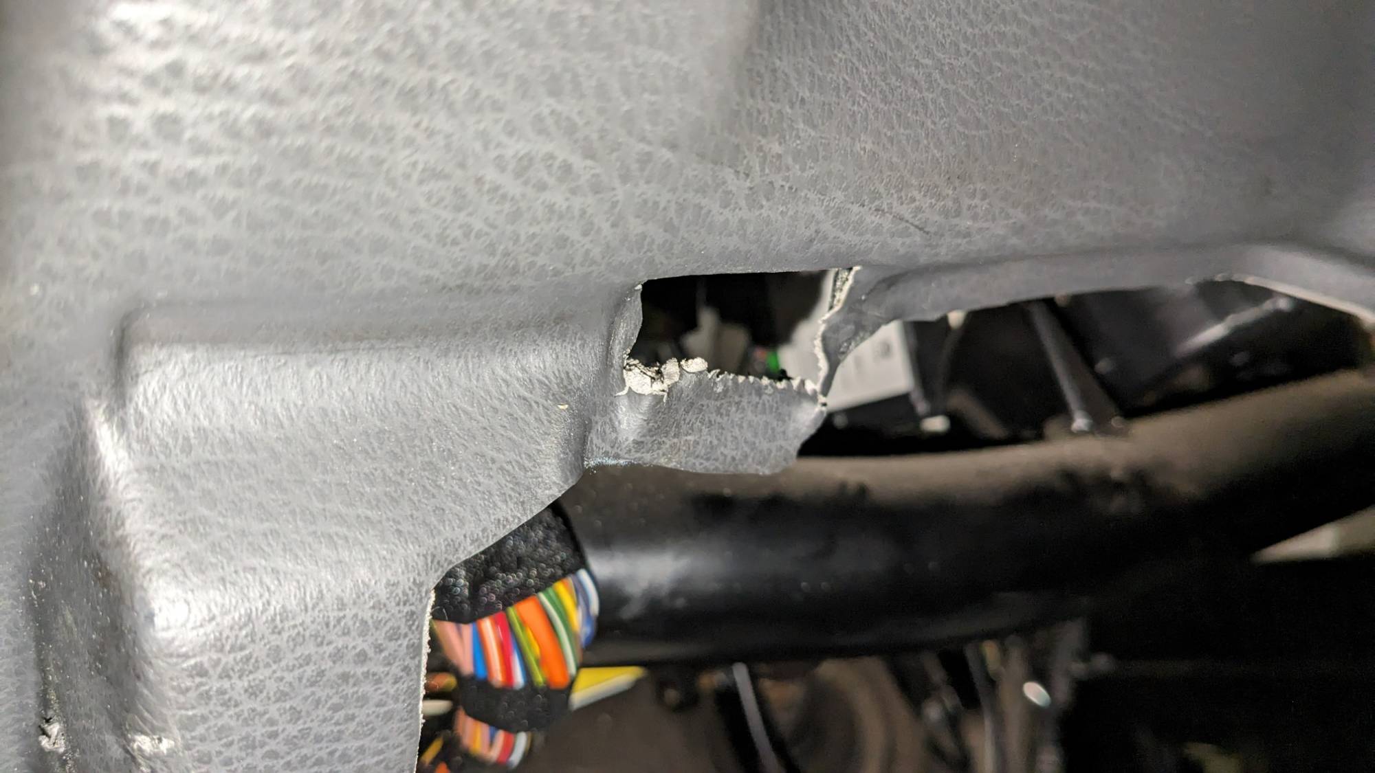

The dashboard kickpanel of my 1998 Volvo V70 I has a broken tab where it should be held in place by a screw under the steering wheel.
While the previous owner "fixed" that by screwing a drywall screw into the side of the kickpanel, I preferred a more lasting repair...

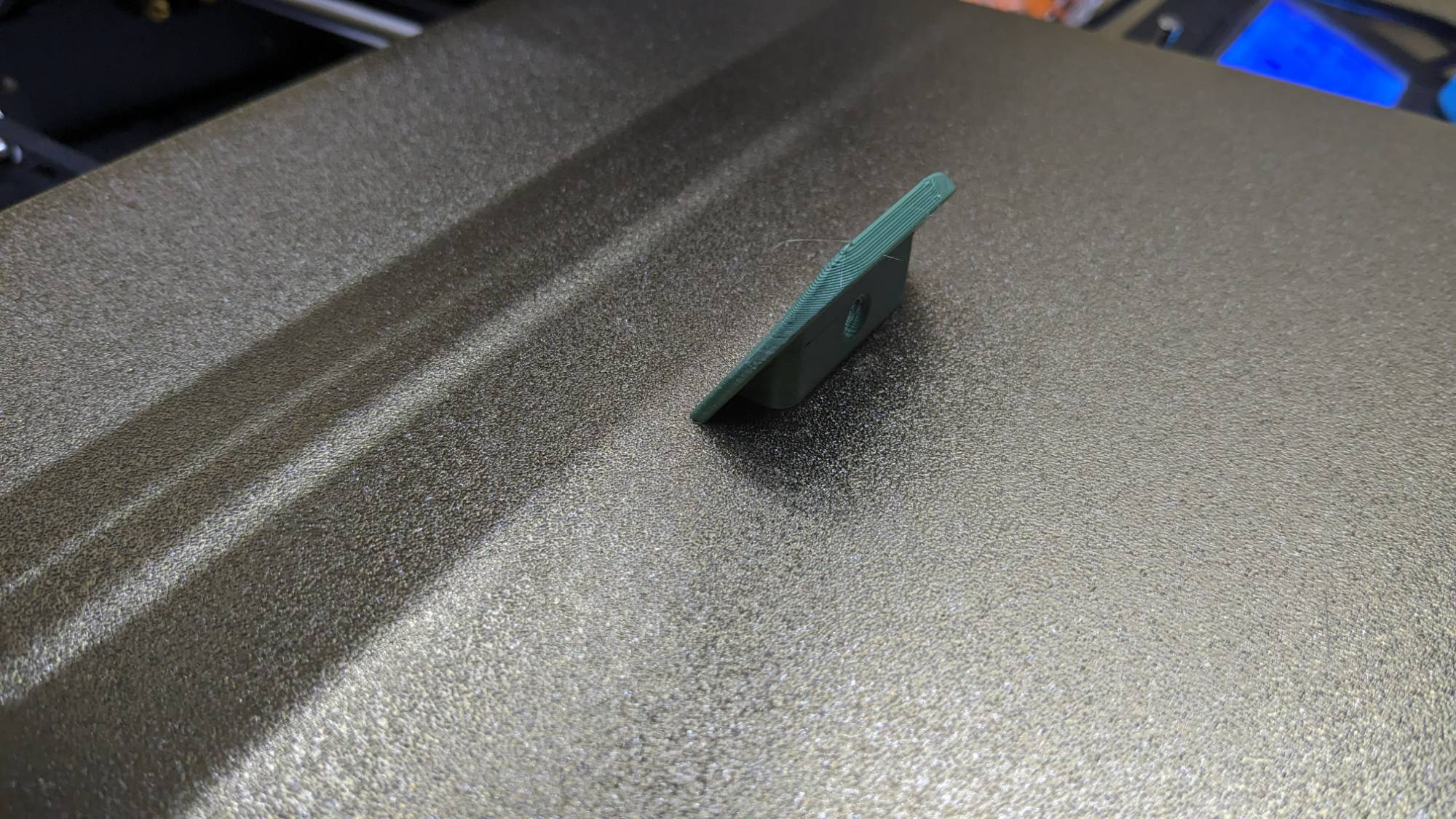

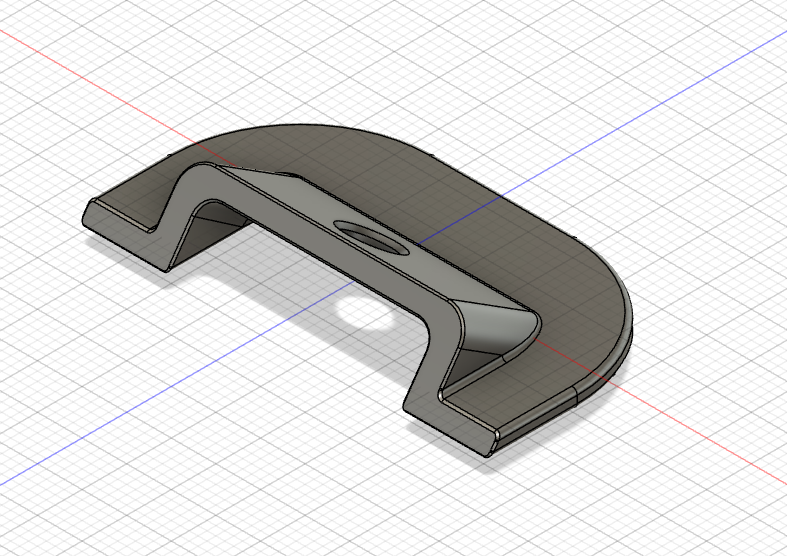

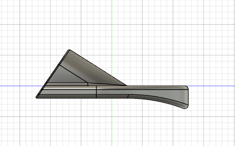

With Fusion 360 I created a 3D model which replicates the missing piece of the kickpanel and has a brim which will ensure a strong glue connection to the panel. In the profile of the model you can see that it follows the slight curvature of the panel as well, ensuring a good fit.

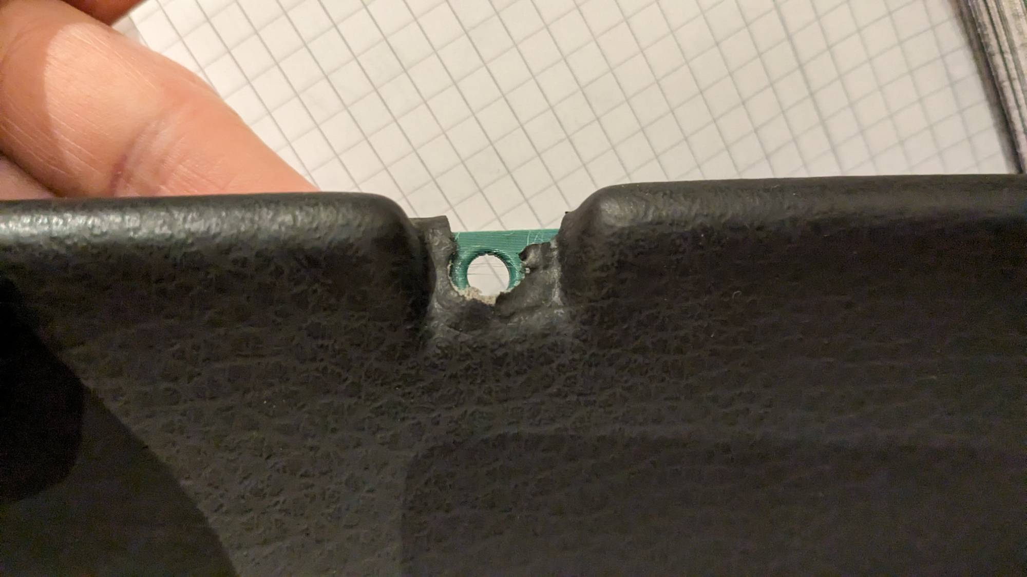

Due to the curvature it had to be 3D printed in a somewhat odd orientation, but it worked. This prototype is PLA, but the final version will probably be printed from ABS or PETG. PLA will start to become soft at around 60°C, which a black car (as mine is...) can reach on a very hot and sunny summer day.
As you can see, it fits very nicely on the kick panel and I'm sure it'll be a very strong repair.

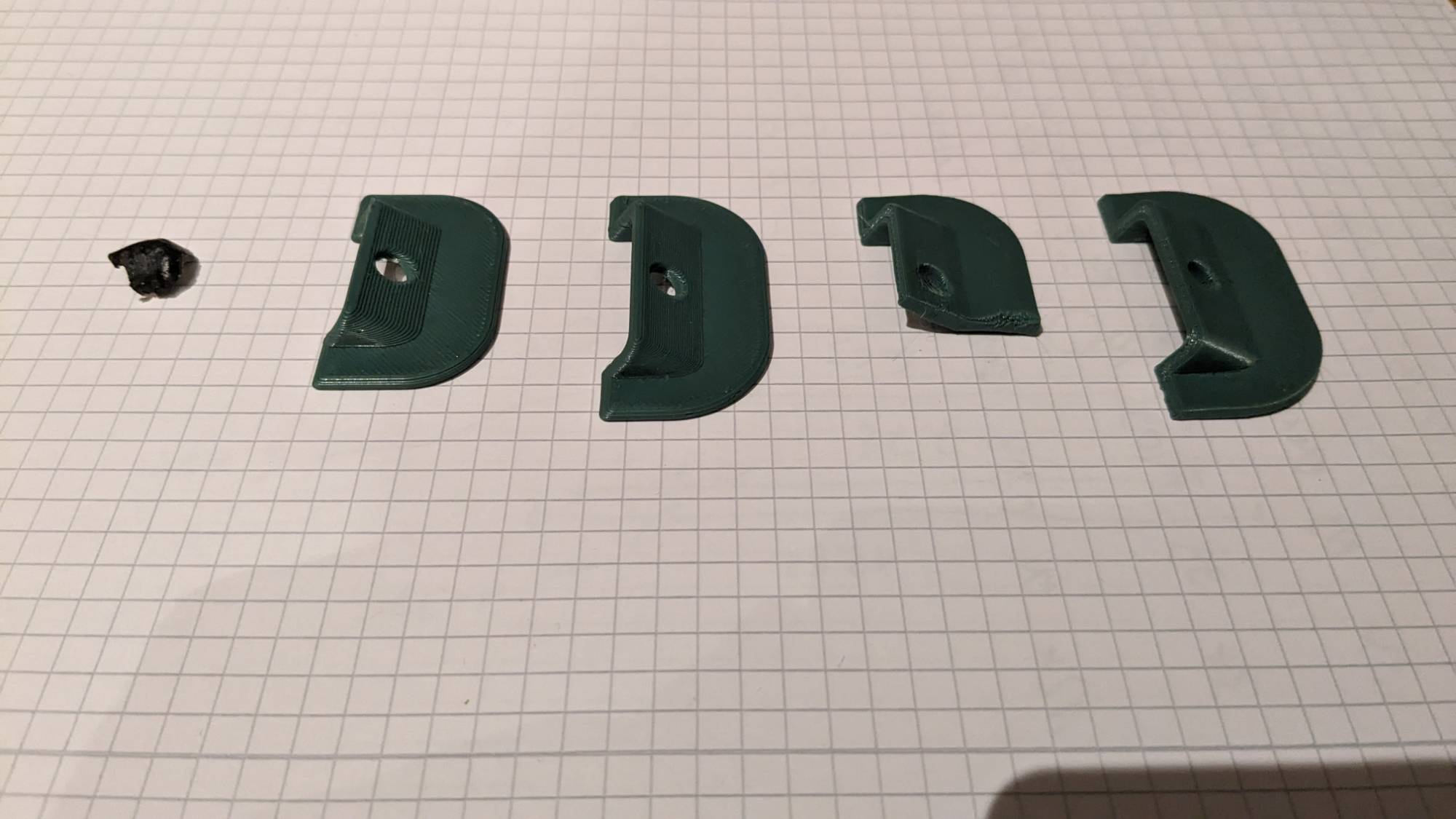

Of course, something like that is not designed first try, so this is the evolution of this repair part.
Leftmost is the little piece that was furtunately remaining on my kick panel, so I could get some reference dimensions from it. The first version was too small because I mixed up the inner and outer dimensions. The second version fit quite well, but didn't have the curvature yet, so the contact area was not good yet. The third version is a cutaway to see if the model curvature fits the actual panel. The last part is the final prototype :)

Simple answer is yes it is a common issue along with several other plastic parts like the corners of the glove box.
I just did a similar repair using bits and bobs I had kicking around. Small strips of metal behind those 2 outer tabs for one. The advantage I had was that the whole dash was out anyway to repair the normally broken lower dash section firewall mounts. I used JB Weld black plastic for the repairs and it has worked well.
Your solution though is truly magnificent and many thanks for doing this and sharing! I could see others looking for this part and whatever solution you come up with for the 2 tabs.

crasbe wrote: 25 Mar 2024, 18:40 Is that a common problem with Volvo V70s that this tab of the kickpanel breaks?
Or were the previous owners of my car just hacks who ripped the panel out instead of taking it out carefully?
If it's a common issue, I can publish the model files for the repair part.
This is amazing! Every one of my P80 vehicles had this issue. I’d love a copy of the file, if it’s not too much trouble.
I'd also love this file! This is a super common problem, I've tried to fix mine many times in many ways, but this is the best looking and appears to be the most effective.
