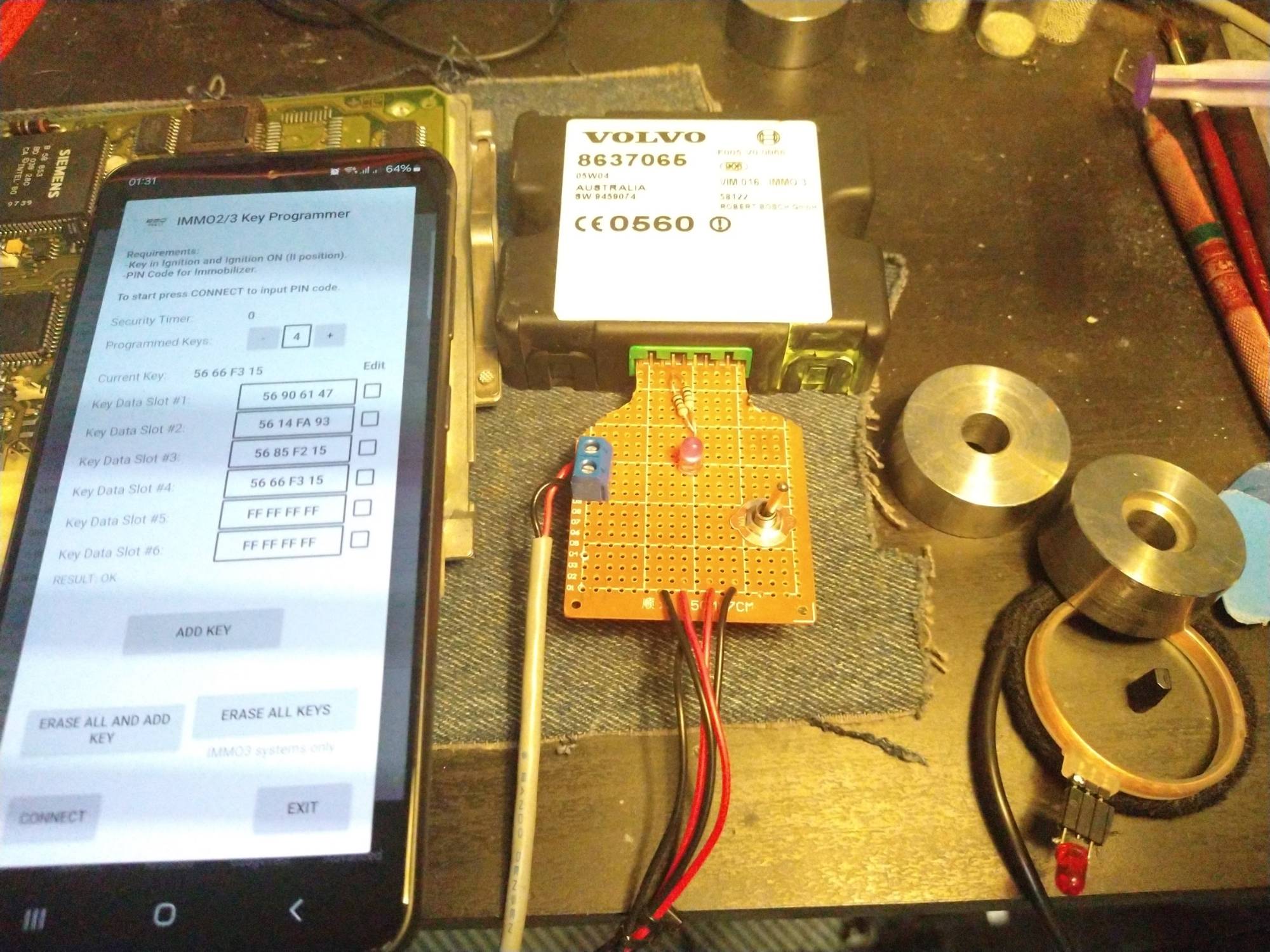

Well i guess world first then?
Added fourth chip in memory.
Under part number year and week. 05 year and this is from C70.
P.S. just joking about world first as Volvo did license functionality for third parties too SnapTools, Autel etc... but sure you jump once again PIN code requirement if not use Vida as it gets that information automatically from Volvo Servers when you do subscription.
This is absolutely not the only way and locksmiths prefer go direct ( faster when not know PIN nor not knowing how generate keys without IMMO memory so that IMMO accepts them when doing OBD learning ) way making keys using tools to generate working key etc..

I made myself chip from blank with my own tools and did read PIN.jmartin919 wrote: β12 Apr 2024, 19:42 Aleksi, I think you're saying you programmed a 4th key for a 2005 C70. Where did you get the key and did it come with the PIN?
I do it for fun price 30eur + how many chips for people locally.
I can make chips what IMMO accepts directly or to be programmed into memory but i need still read the IMMO. Volvo only can (UPDATE: NOW I CAN MAKE TOO) make ready programmable keys without taking off IMMO3 module for 40 and 70 series as they have data in their servers.
Mostly they don't (bother). For locksmiths its not necessary for to doing the job when if they cut the key and program chip themselfs and so i have not yet seen any third party locksmith tool to show ex. PIN code or to Add Key in memory.. Why? Their key generator tool makes key directly for them from old existing key data by press of a button to new blank chip and call it the day as new working key or keys so they dont need to do OBD stuff.
What i seen locksmith tools they dont just bother on these Volvos with more functionality in their tools.
But to get PIN code local dealership here asked me come there with car owner proofs to there to hand over "access" information. In that part didn't talk of pricing*. Third party tools who has too this functionality does just say PIN comes with the new programmable vehicle key when ordered from dealership. When ordering it will be made clear its programmable or not and come with PIN too i am sure... asking doesn't hurt.
*= I was not at this specific moment to actually ask just PIN code but verify Verlog code of the module as i was searching where in IMMO3 module it was saved to be sure i did find correctly. Turns out VIN/Verlog code of module is saved in same location ( "VIN" code is absurd to call it though as its not full one ).
