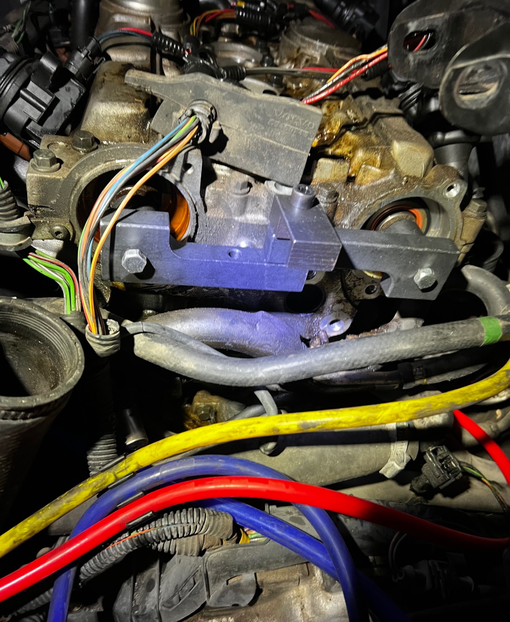

After finding the open exhaust valves but before replacing the ETM I checked the cam timing. I wanted a little more evidence the belt hadn’t jumped and actually bent the valves besides just the lack of kiss marks on the piston.
Camshaft locking tool in place
Crankshaft timing marks

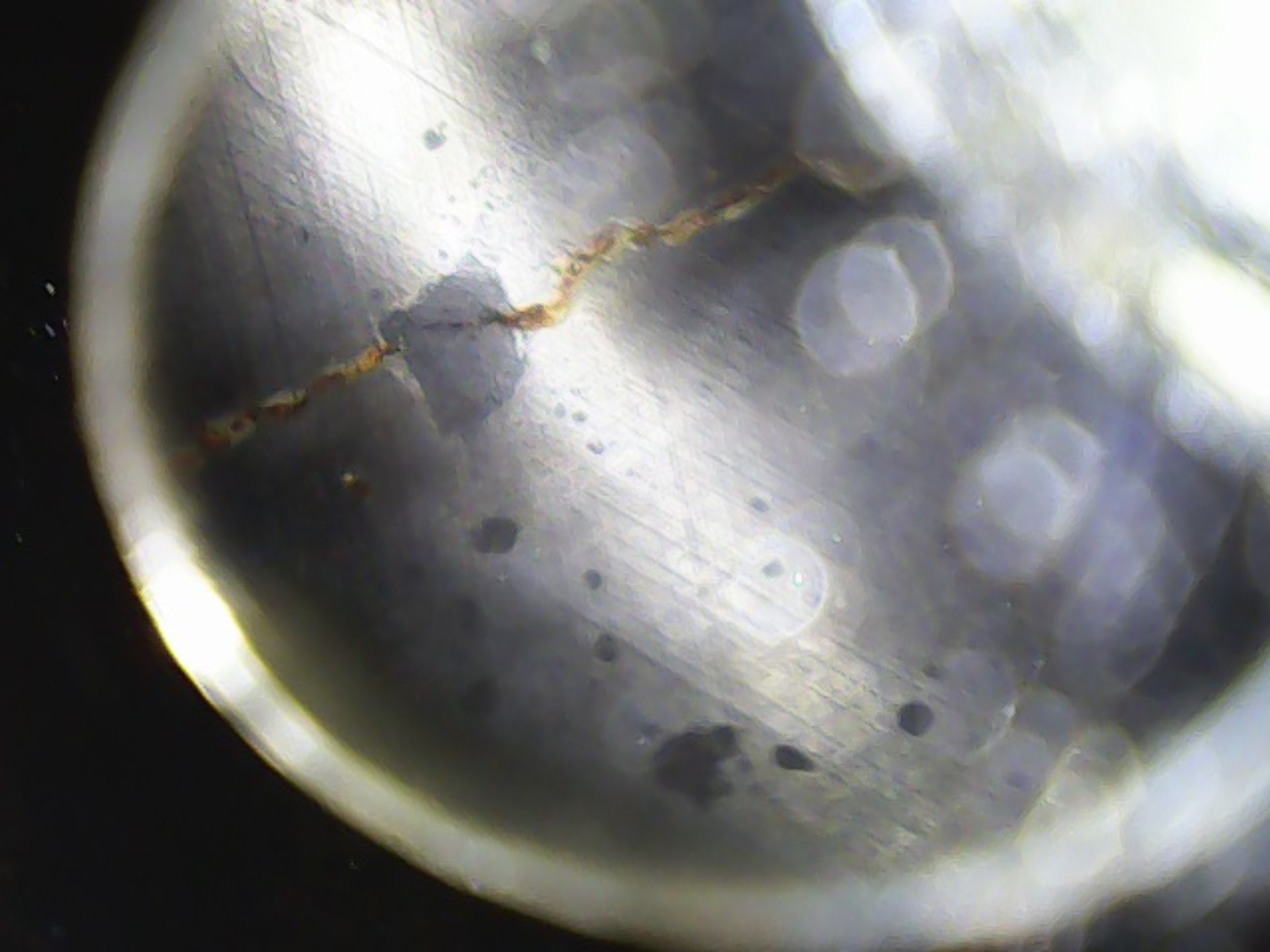

I thought this would be a long thread detailing this S70’s next 100k miles. But it’s not to be. I don’t know how I missed this, but I decided to do another borescope inspection after getting the valves unstuck, servicing the PCV, and getting the engine to start up, albeit running poorly, and found this;
Image_2024-04-14 01_37_15_490.jpeg (232.94 KiB) Viewed 584 times
Cracked liner in #3 cylinder.

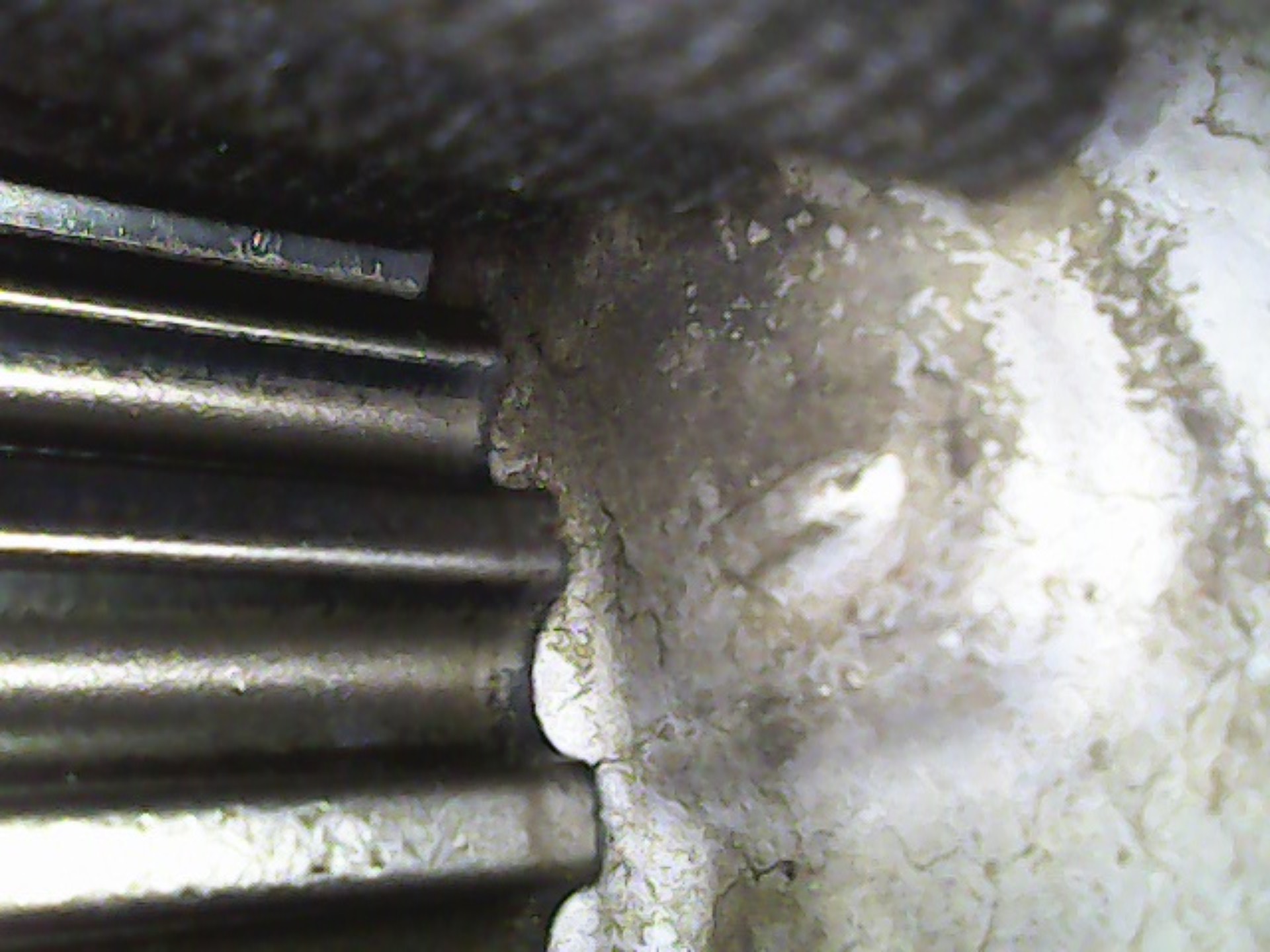

Recently I learned either my borescope is useless, or I can’t see well (or interpret what I see?).
I went ahead and pulled the cylinder head, because why not? I have looked, photographed, videoed and looked again, and I don’t see a crack anywhere. But the head gasket was definitely blown.
I’m going to go ahead and put a head gasket on it and see what happens. I sent the head off to have surfaced and have got it back (another thread- viewtopic.php?t=104425
Maybe wasted effort…
