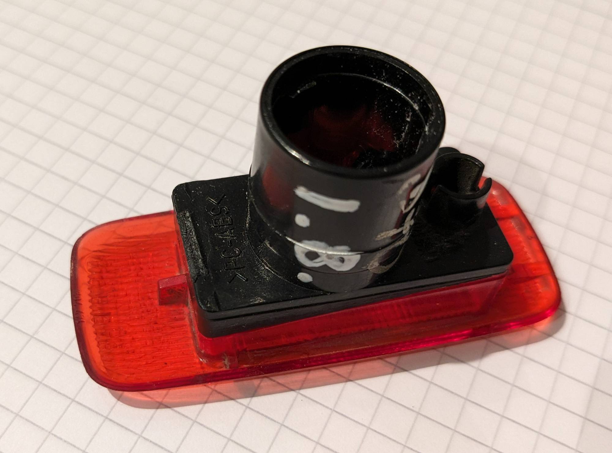

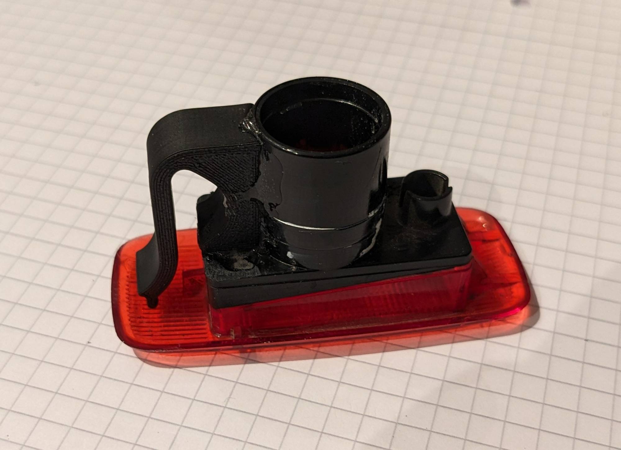

crasbe wrote: 08 Apr 2024, 16:17 Funny, now that you said "all four", I realized that the rear has these lights as well... :shock:
One side is in perfect condition, but the other side was smashed to pieces :shock:
Unfortunately the inner plastic part that is supposed to hold the light has been detached from the door panel, so I might have to take the door panel off to glue it back on. This escalated quickly...
One way or another, I did a test fit (actually two test fits with another one pending) and it did fit quite well the first try but I optimized the shape and added more preload. It wasn't really snug.
And the repair piece got a sexy waist, which makes holding it in place while the glue dries a lot easier (and it looks good... which was the main reason I added it).
By the way: This is how "a small side project" starts to look like eventually :D
Is that UHU Hart Plastik any good? Is it a weld type glue?

Clemens wrote: 09 Apr 2024, 13:09 Is that UHU Hart Plastik any good? Is it a weld type glue?
I can't give you long term experience, but the repair piece I glued on the light last night was preeeeeetty solid on there and it was just two little glue blobs (to be able to get it off again).
It contains Acetone, so if the plastic can be dissolved by Acetone, it probably will create a weld bond?

Acetone sounds good. The safer option to MEK for a lot of plastics.

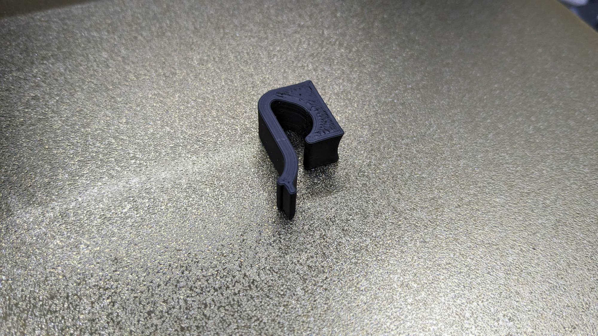

Today I found some time to print the repair clips in ABS and glue them to the lights. As I am satisfied with the fitment, the model is now published on Printables: https://www.printables.com/model/837887 ... 43-9178328
Repair clip fresh from the print bed:
Before:
After:

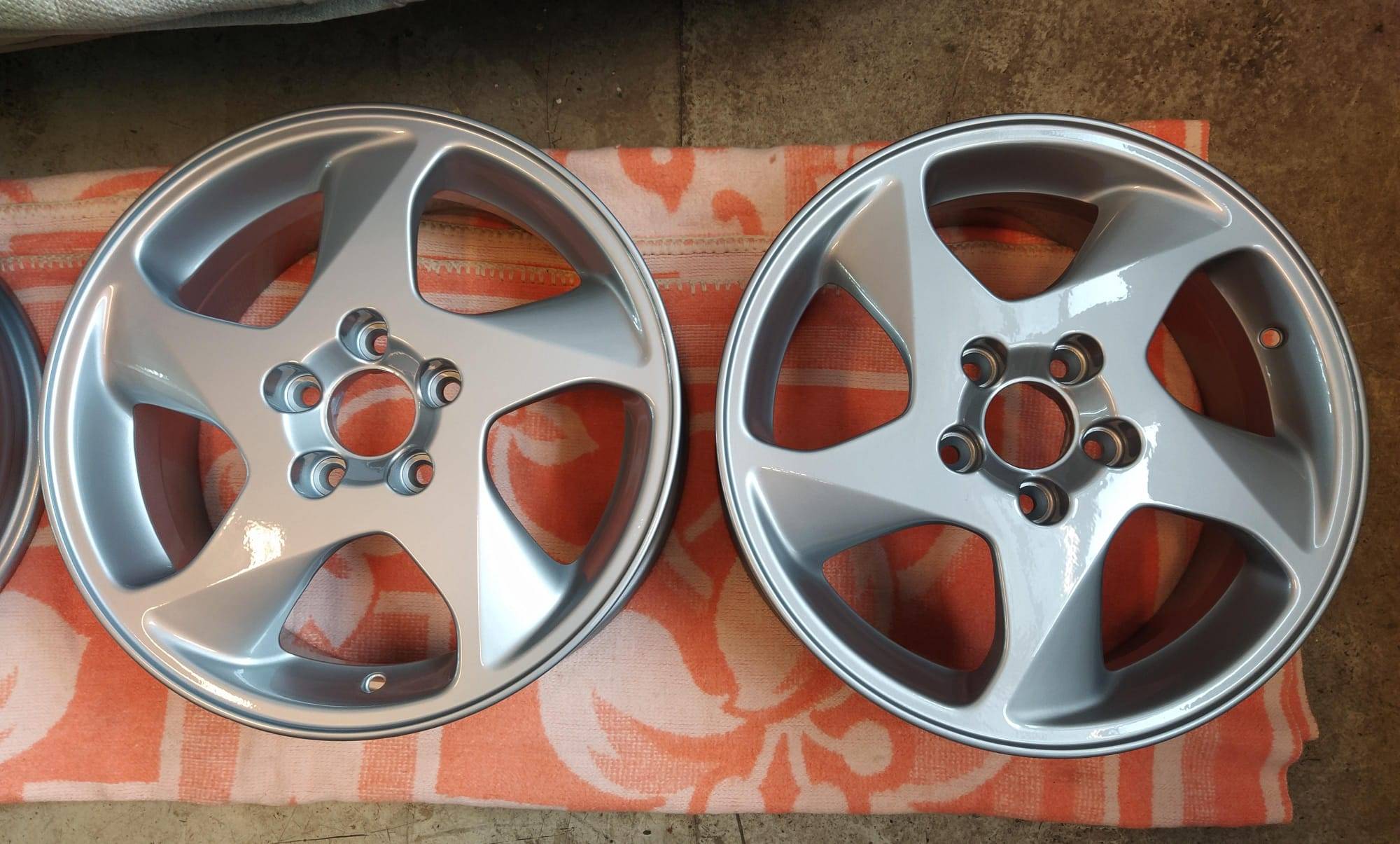

So, today I went by an old buddy of mine in the south of the Netherlands to pick my summer rims for my S70. A while back I decided to freshen up my run down Columba wheels and thought of powder coating them. I'll post some pics when fitted on the car :D

Ocelot wrote: 15 Apr 2024, 07:22 So, today I went by an old buddy of mine in the south of the Netherlands to pick my summer rims for my S70. A while back I decided to freshen up my run down Columba wheels and thought of powder coating them. I'll post some pics when fitted on the car :D
They look great! These are Perfos, by the way :wink:
