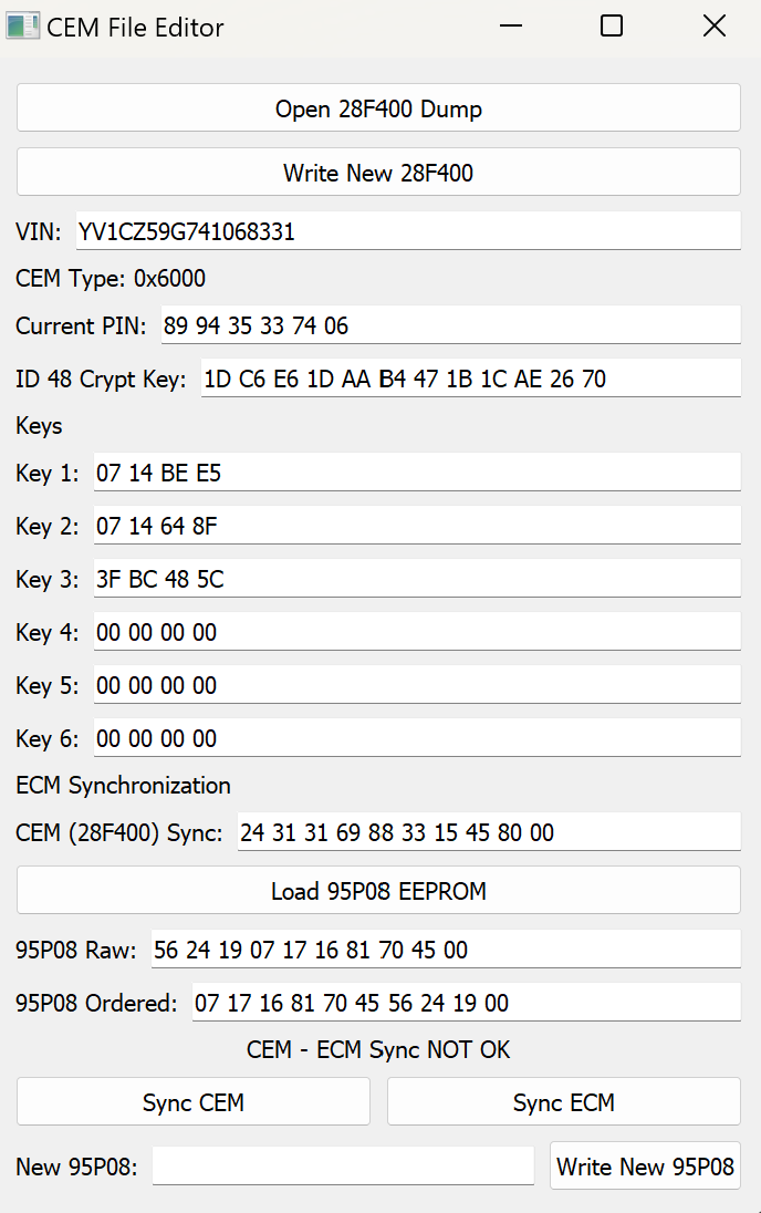

Question for everyone. What info do you know is stored in the CEM?
For now I know where VIN, Keys, Crypt Key, ECM Sync and PIN is. I am making a tool to make it easy to change any of these elements when you already have a CEM dump.
The tool is also able to sync ECM and CEM. Currently this is only for CEM-B (28F400 / 95P08), but, there are plans to make it work with CEM-L and CEM H (M30835 / 95080 or M30855 / 95080 as well)
I will include changing CEM config as well. But, I still need to know where the offsets are for a more complete version. Things like ICM ID offset, ABS ID offset, etc. If anyone would like to share it with me, please do let me know. I'll add it to the tool, and I'll share it here once it is complete.
For now, here is a small screenshot

Skavac wrote: 16 Apr 2024, 14:04 Question for everyone. What info do you know is stored in the CEM?
I am fairly certain there is a mileage stored as well as checksums for at least the ECM programming. Sorry, I would love to know where and I would be very happy to use your tool so I am looking forward to a release, but can't help you more than that right now.
Please support as many CEMs as possible since it is prohibitly expensive for the older cars (and it will be for the more modern ones when they age and devaluate more) to go to a dealer for a CEM replacement once they fail. I realize people currently make money providing this service but we will need a "stone soup" approach for these cars to remain driven in numbers that make commercial support by these people viable. No use sitting on a secret for a platform that isn't on the road anymore, there will always be people preferring a professional to handle something like a CEM replacement instead of doing a DIY.

WhizzMan wrote: 17 Apr 2024, 02:58
Definitely! I will try to support the newer CEMs as well. But, right now, there is a lot of research that are still needs to be doing. I am more than happy to pay (a reasonable fee of course) to someone who can tell me more info about the data in these CEMs.
