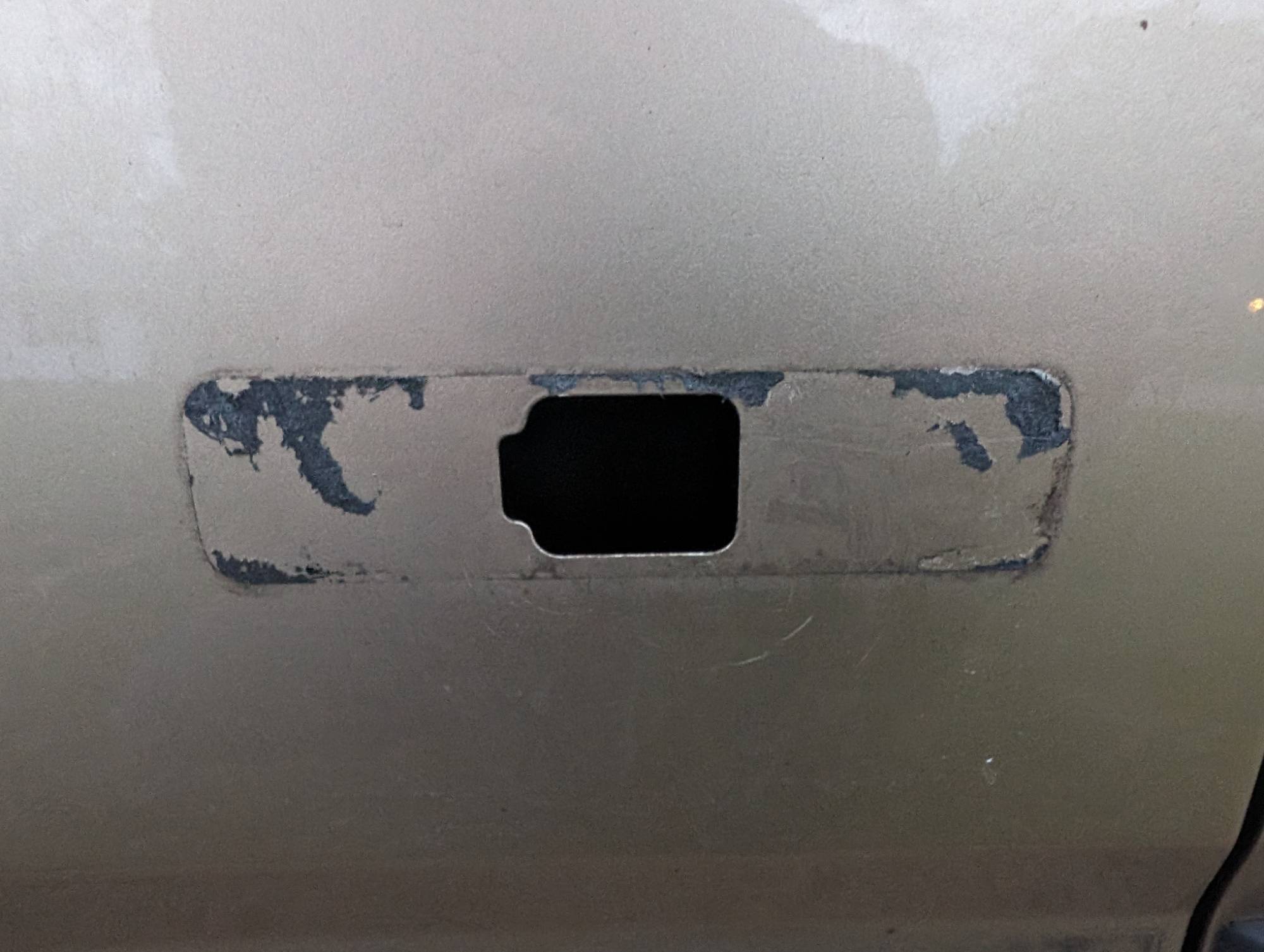

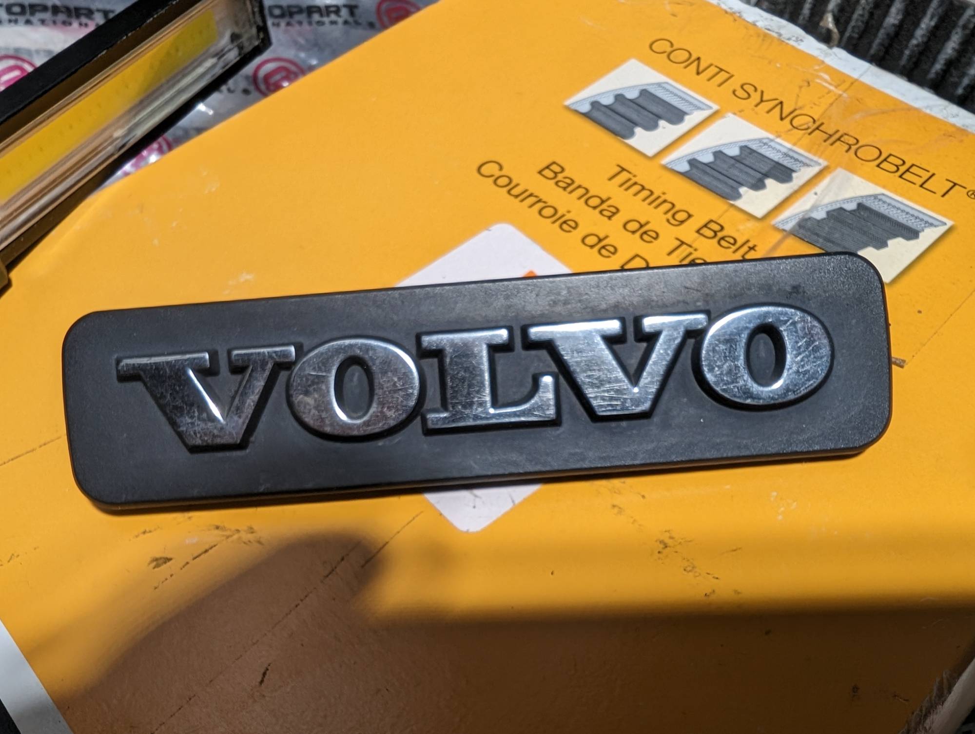

Tonight, I pulled off the Volvo badges. They came off much easier than I thought they would. I used a plastic putty knife that I've had in my tool box for quite some time.
I still need to remove the residue from the foam tape. I already have an eraser wheel. I just need to move the car closer to an outlet or charge batteries.
I was pleased that the emblems were not damaged at all.

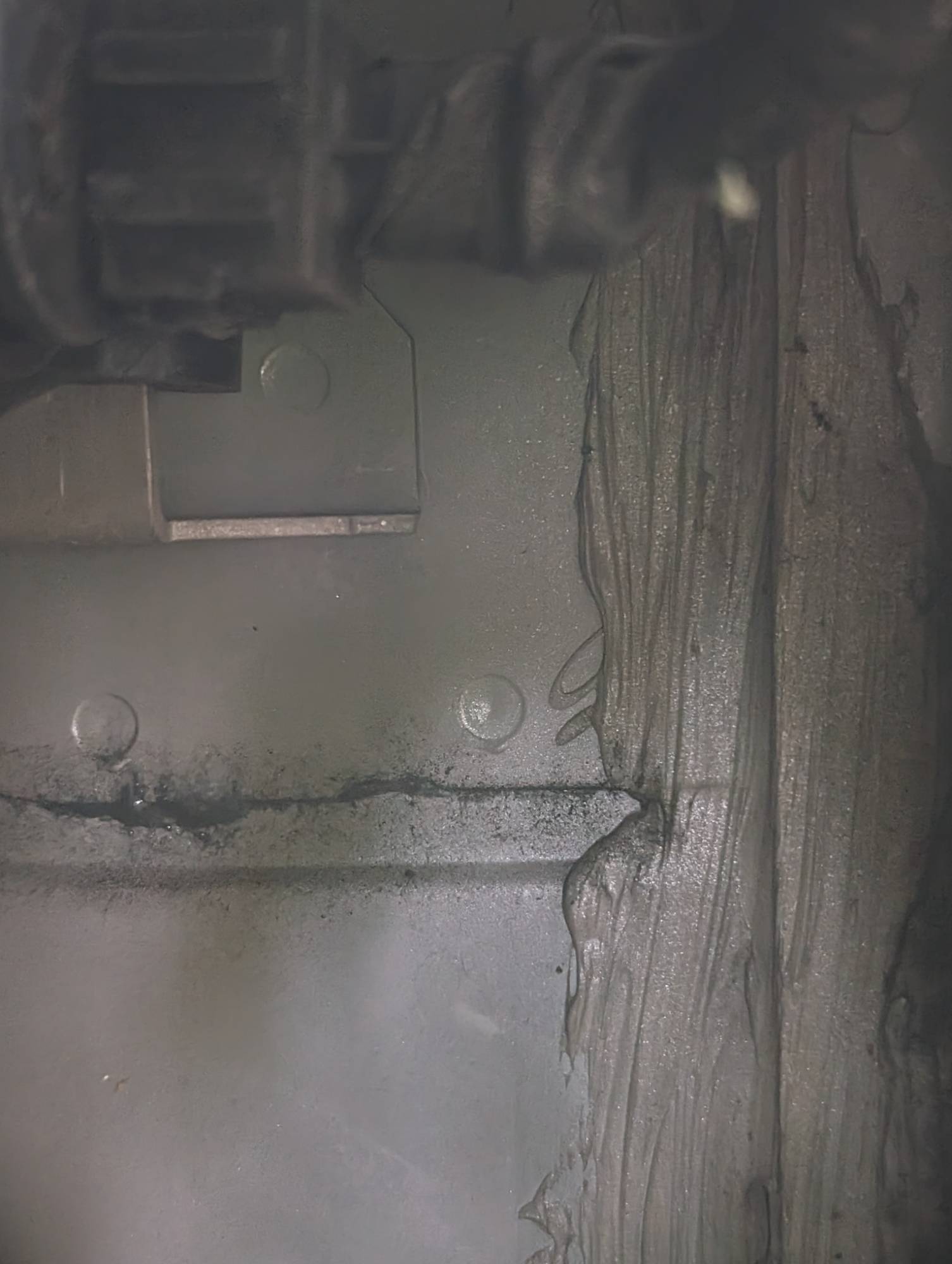

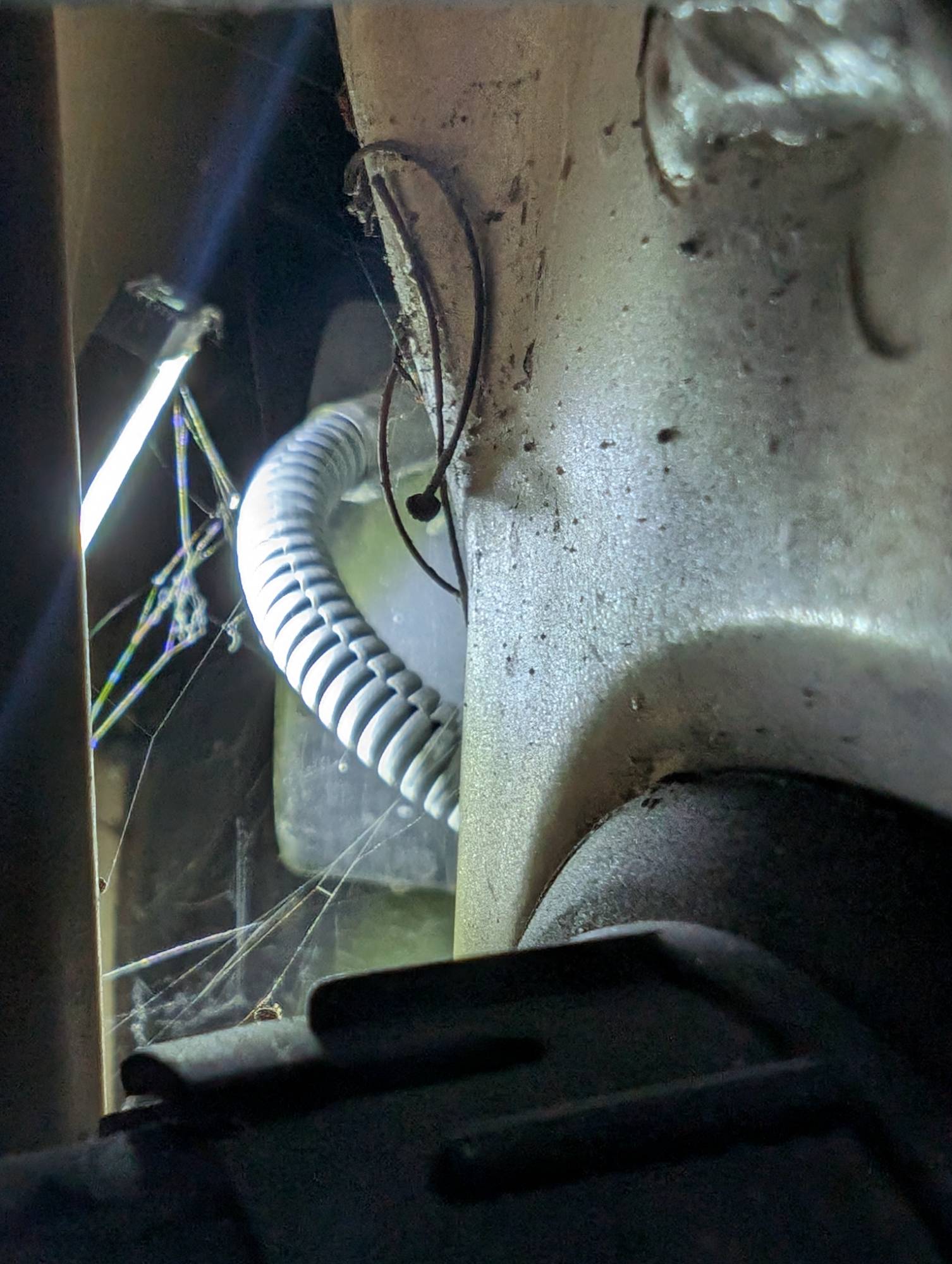

scot850 wrote: 28 Apr 2024, 19:19 Does your car have the wires tucked up behind the fender? The young guy I was helping last year with his 96 850 base had wires behind the fenders. I seem to recall we could see then looking forward between the door pillar and the fender.
That's a great question. I'm not sure. I can see and hook a wire, but it doesn't seem to want to move.
That's my flashlight sticking through the hole in the fender and viewed through the hinge area.
This is taken through the hole in the fender.

Post by scot850 »
Is that RH or LH fender? If it is LH that may be part of the Evap system pipework to the outlet valve. I recall the wires I say were just 2 wires and a connector. I understand not all cars were fitted with wires for some reason. There are those who had retrospectively added wires removed from V/S/C 70's.

scot850 wrote: 29 Apr 2024, 00:09 Is that RH or LH fender? If it is LH that may be part of the Evap system pipework to the outlet valve. I recall the wires I say were just 2 wires and a connector. I understand not all cars were fitted with wires for some reason. There are those who had retrospectively added wires removed from V/S/C 70's.
The pictures are from the left hand side. If I don't find wires, I was planning on splicing into the existing wires at the front turn signals. Is there a better place to do that? Where do the factory wires connect?

Didn't get outside today before work, to work on the 850. The next step is to get the tape residue off with an eraser wheel. I'm thinking that I may try to soften it up with a heat gun first. It's awfully dried and hard.
Hopefully some "cleaner wax" on the paint will make any shadows disappear.
