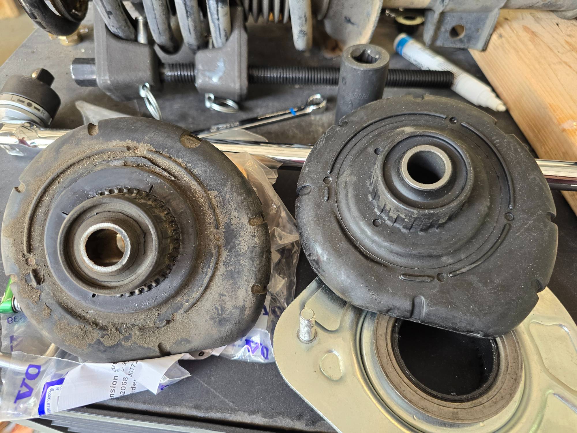

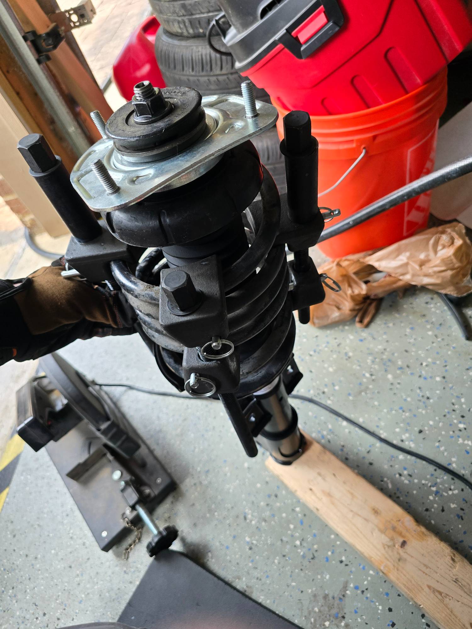

Finally changed out the xc90 struts that have been sitting in my garage for 3 months. This was my first time changing spring as well. I used 2 sets of compressors so 4 total. Despite the added security I was still quite nervous. I had to max out the compressors to remove the spring. Also I didn't have a tool for the cross nut and no amount amount of hammering or misuse of a box end wrench would move the cross nut. So I sacrificed one of my harbor freight sockets. The driver side spring seat had blown through which explains the clunking noise I was hearing. Now on to the blend doors

There are 'star nut' tools out there. Amazon in Canada lists OEMTOOLS version for about $22 CDN ($17 US). I would link it but links from Canada don't work when viewed in US from Amazon.

I've seen several but none were available to me locally same day so I improvised. I have no regrets.

I hear you, and love the improvising! I am fortunate to have the Volvo tool for front and rear as I got fed up fighting this issue.

Custom tools often work better than the actual thing!
