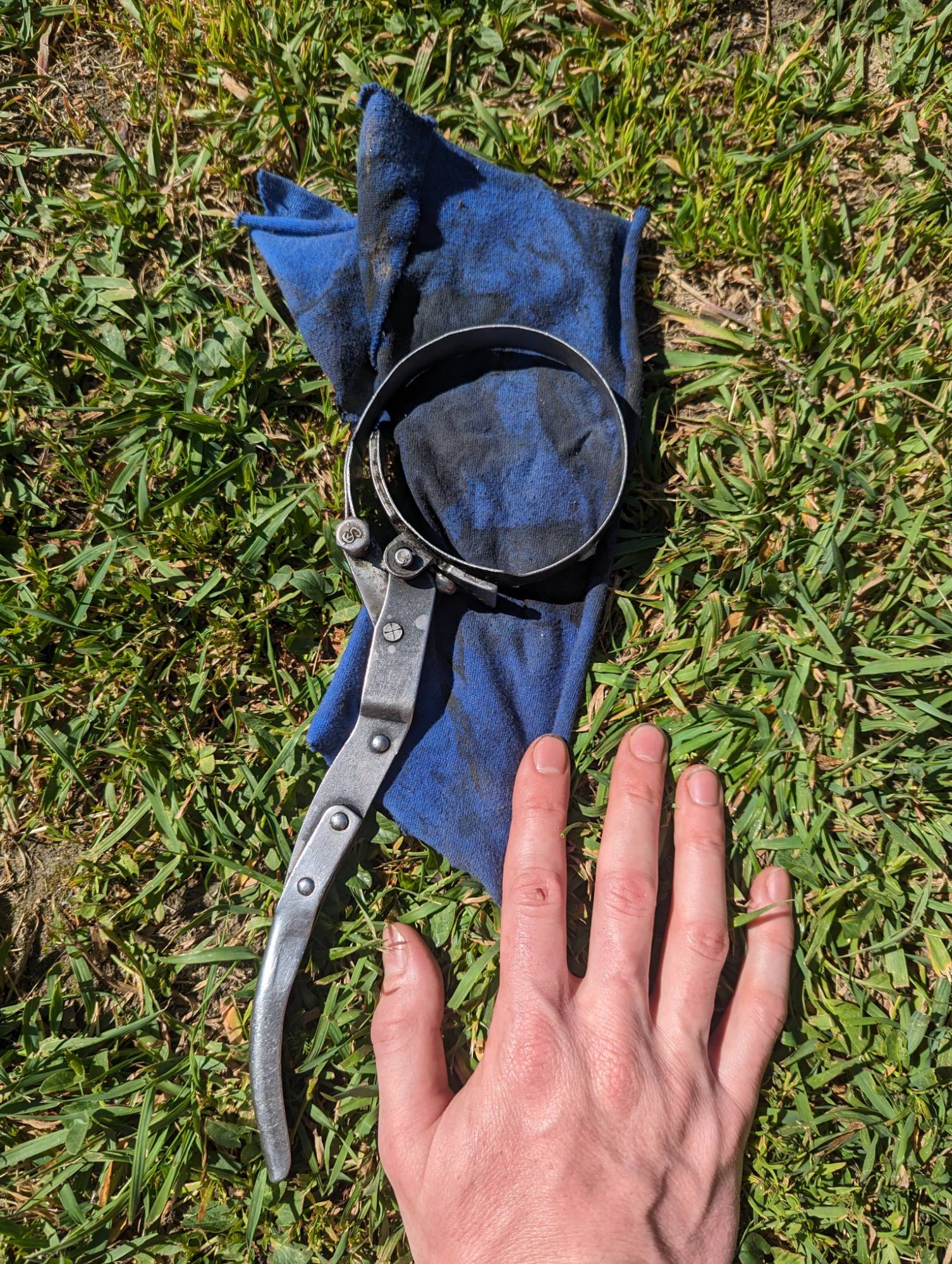

mrtinker wrote: 08 May 2024, 11:50 I have a stubborn oil filter, an insert type filter with the stupid plastic housing that I can't get a good grip on...
A followup & appreciation: the plastic filter housing successfully removed.
Seems like the trick this time was cleaning the oil and grime off the filter housing with some iso alcohol and then using a slightly longer and sturdier oil filter band-type tool borrowed from local mechanic with a rag wrapped around the filter to improve grip.
The longer handle on the tool was key to applying leverage accurately. Also props to my pops for finding the right tool.
-Other attempts included buying a filter wrench(local store didn't have my size), hose clamp and hammer (not enough room to swing), cursing and taking a nap (mentally useful)
Thanks for all the ideas, I also bought the appropriate filter wrench for future oil changes

mrtinker wrote: 24 May 2024, 13:39
It was so much work you fell down in the grass (but managed to take a photo with your last bit of strength). Thanks for your tips.
