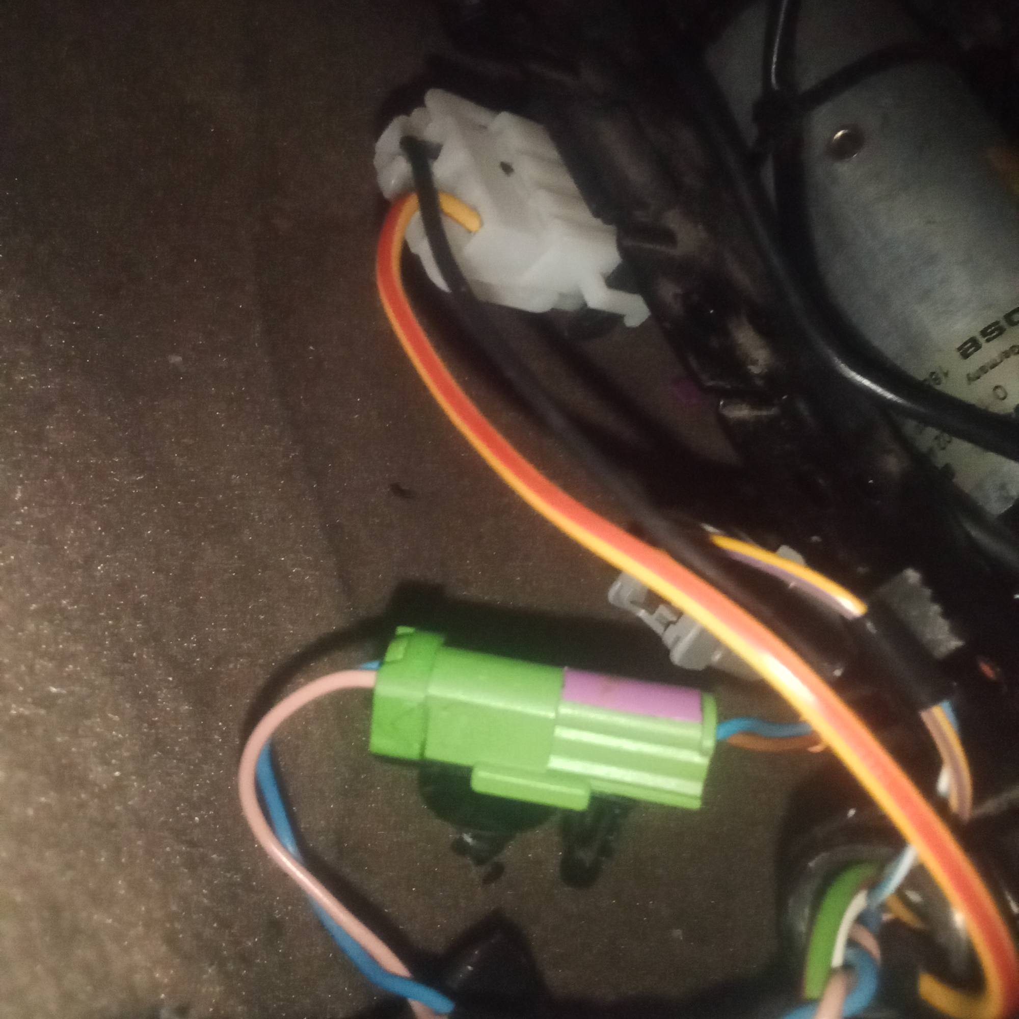

So I'm back on this project. Put in a new (used) airbag module and the only code I get is for driver SIPS. So how do you take this green connector apart?

That purple clip slides up, then the green parts separate to disconnect. They are fiddly

I figured it out. Used needle nose pliers at the opposite end of the purple clip, squeezed the sides of the end piece and that lifts the top catch up so they can slide apart. Using a Youcanic scanner it shows all of the compents to be OK but it won't clear the SRS light. The scanner gives instructions to start the engine, rev to 1500, turn engine off, restart and let idle 20 seconds. That didn't work. I'll give it a week of driving cycles and see if it will clear then. I know the consensous is that only VIDA will clear it but I was assured by Youcanic that their scanner will do it.

To disconnect, I have not doe it that way. On the left hand end in your picture, you can see there is a locating tab on the tops and if you look closely on the sides you can see what looks like an arrow head pointing to the the left. Squeeze hard on both sides and it should lift the plastic over the tab to allow you to slide to off to the left.

Yes, that's what I did.
