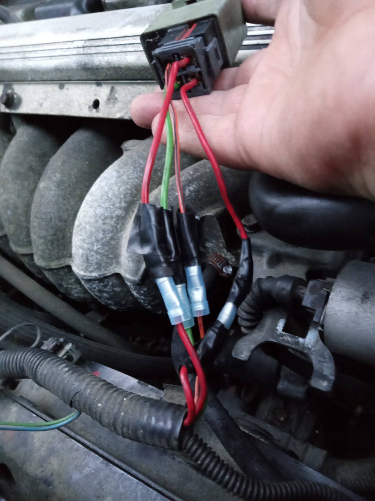

Possible Incorrect Rewiring of Fuel Injection Relay?

Nope. They are both fed from the same location.
