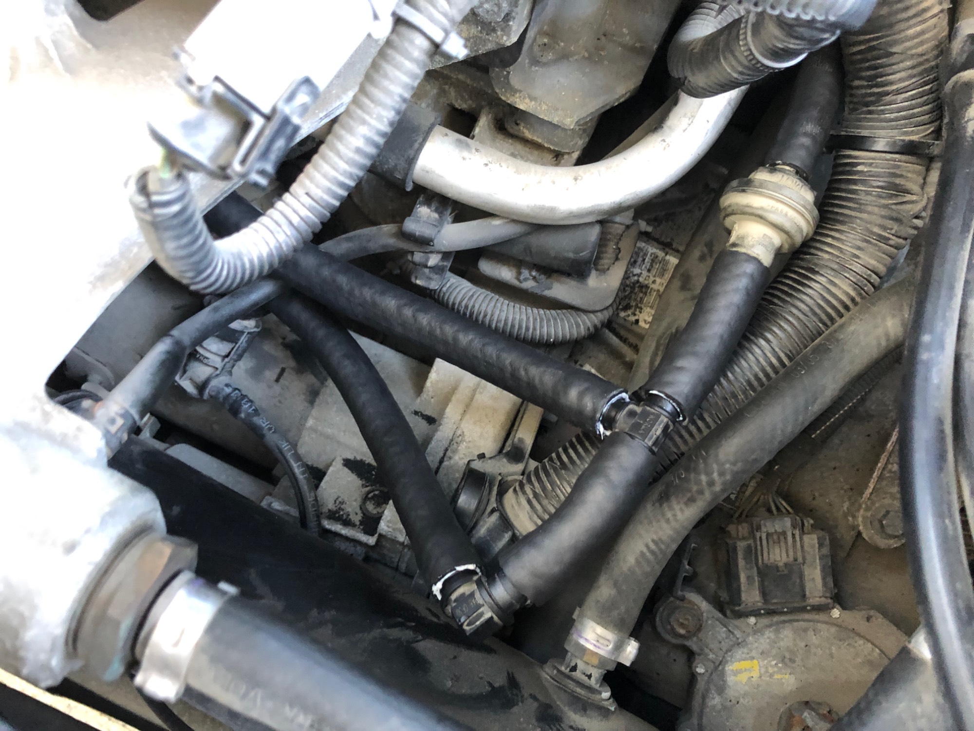

Hoping I got to the bottom of the EVAP codes on the kids 05 XC90. This hose look gone to anyone? I think the Brits refer to this as manky.
All new fitted.
Just for the Oetiker fans.

On the fueling some pumps are more sensitive than others too, will click off early before the tank is full. If you have a regular station and can find a common pump that works stick with it.
No help for you on the vent, maybe see if the parts fiche can give an idea where it might be?
