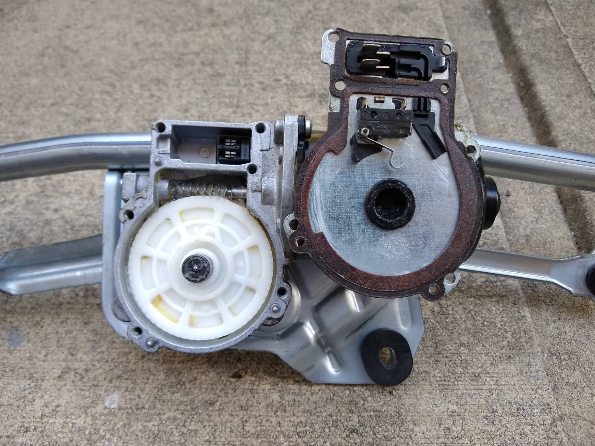

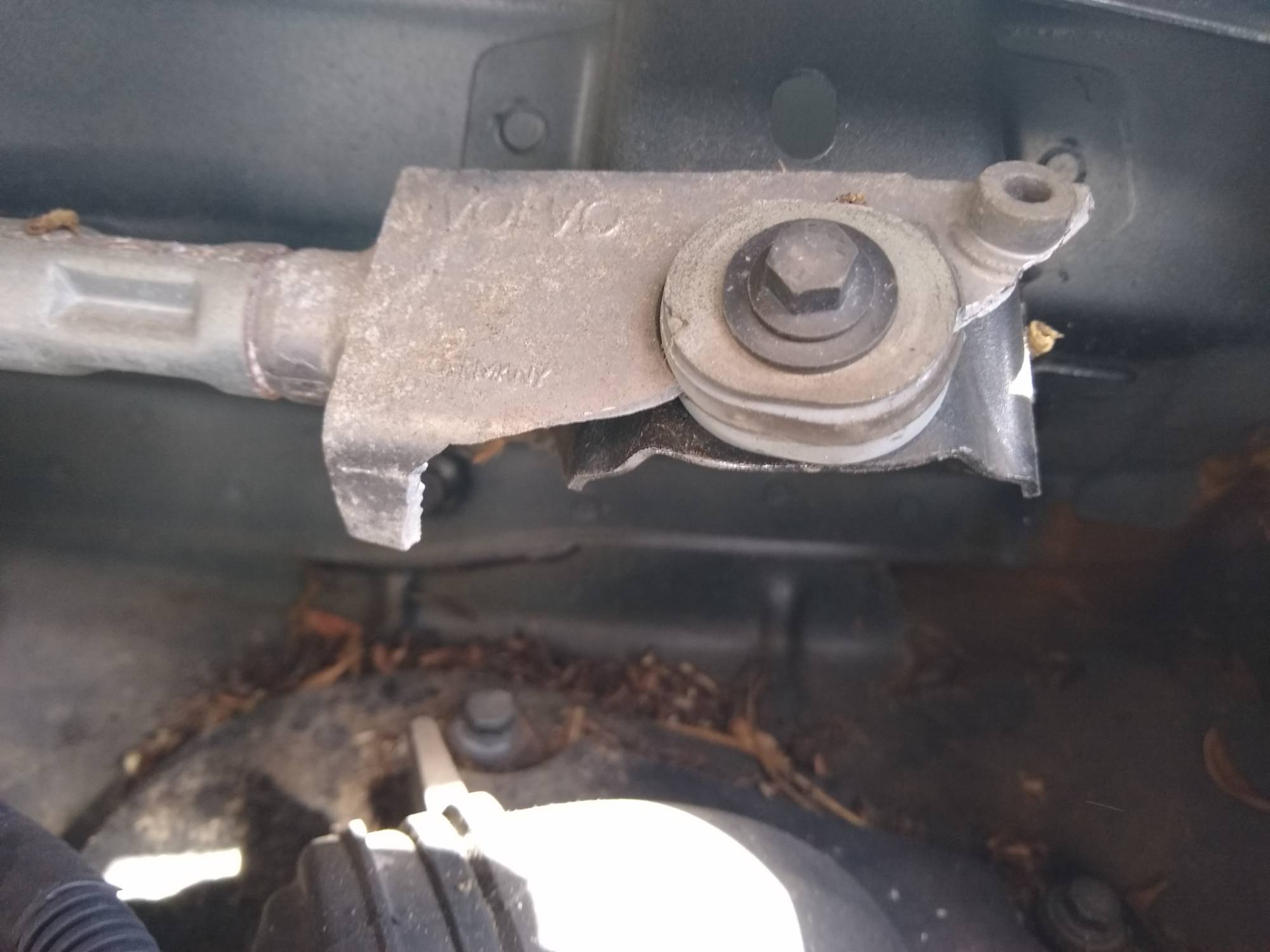

The 2012 SUV was purchased with the driver's side arm not moving. It snapped but not sure how that could have happened though I haven't thought to check the hood. Perhaps someone was upset :shock:.

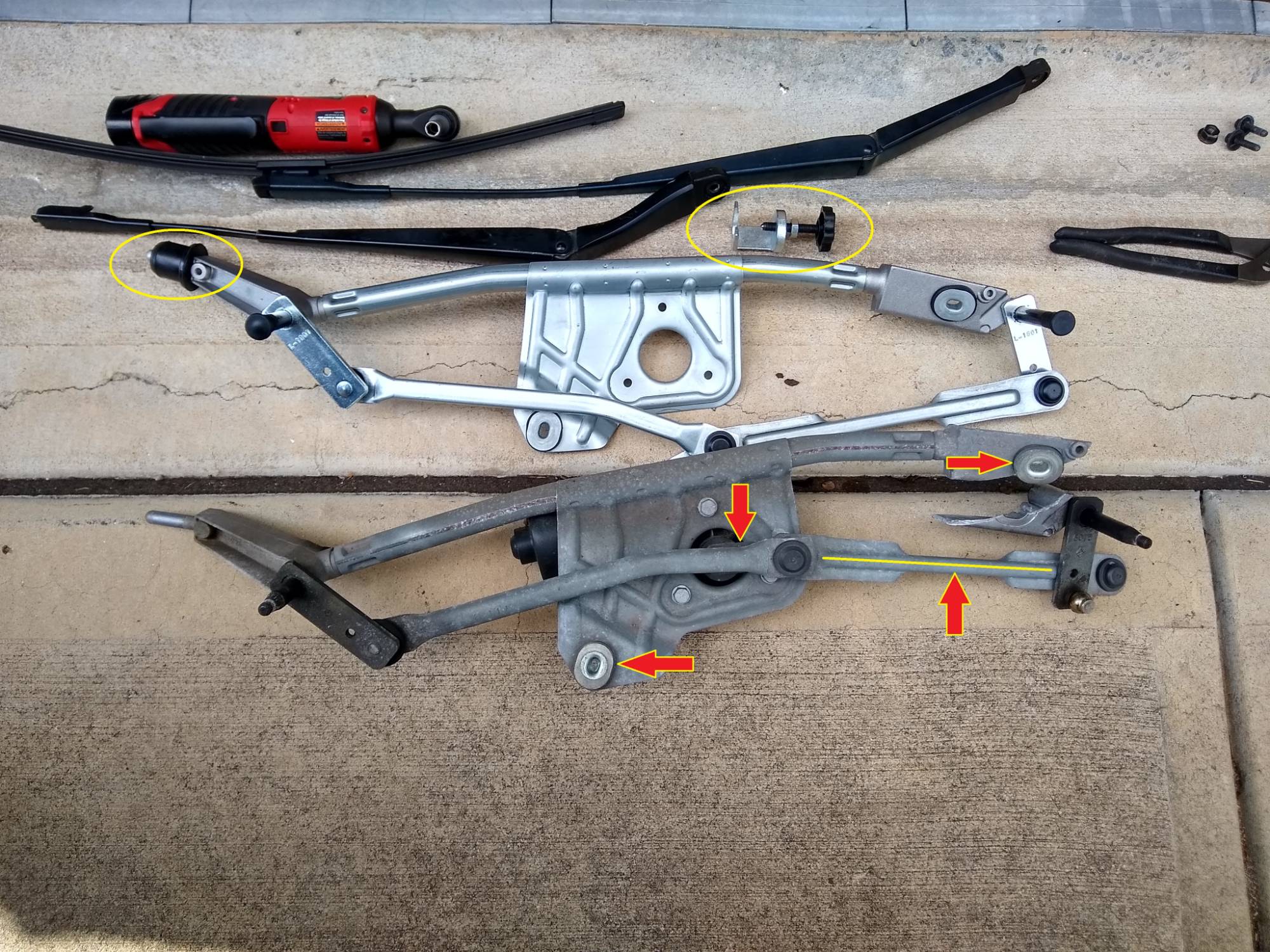

1) Removed cowl cover which was pretty straight forward.
2) Needed a wiper arm removal tool as there was a lot of oxidation on both attachment points.
3) Reused old motor and arm so I didn't have to mark and test the assembly position.
4) Reused another longer arm as the metal was thicker as with the entire old assembly vs new.
5) Reused the 2 old grommets as they felt like neoprene rather than rubber. The new large rubber mount was used instead of the old.

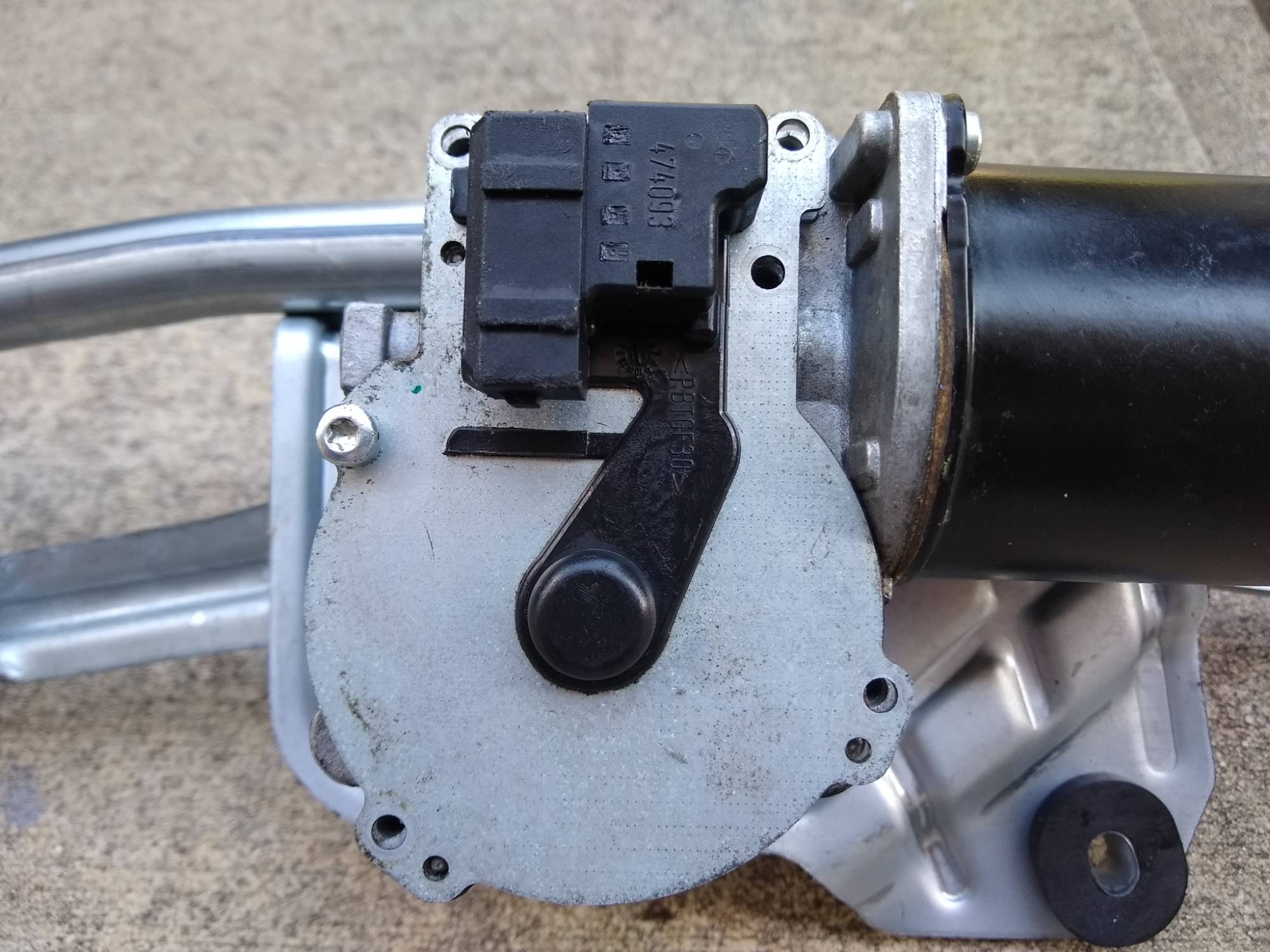

6) Grease the old motor gear and worm drive. There was very little grease inside so just squeeze some silicone grease in the gaps.
(EDIT: Per chiTownV's inquiry the cowl area, it was vacuumed, dusted, wiped and for good measure compressed aired of dust and debris besides clearing the drain lines.

Post by chitownV »
It looks like you missed one of the most important things while in there. To clear out the drains to prevent water from damaging the CEM.
