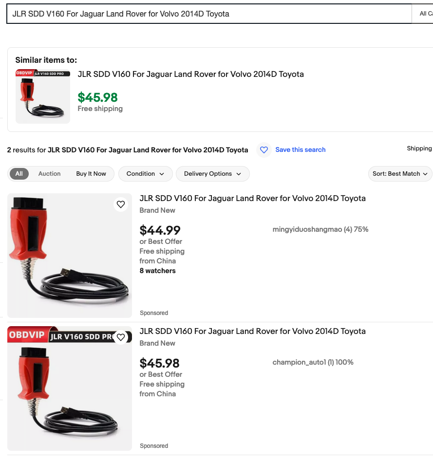

The specific seller I got from ebay no longer sells the item, but the (same?) item can be found from other sellers for the same price https://www.ebay.com/sch/i.html?_id=226 ... ota&_sis=1
The one I got works well with vida. I have not tested too many advanced features, but everything seemed to work.
You will need drivers for it which you can download here: https://d5t5.com/article/generic-j2534
If you are installing vida in a vm, sometimes you can have issues recognizing usb devices. Messing around with usb setting in the virtualbox/vmware I was able to fix it. Try changing the usb version and troubleshooting.
To test the cable outside of your VM, you can download vdash from here https://d5t5.com/article/vdash-volvo-diagnostic and install the driver I listed above and see if vdash connects. If it does, then your cable is good, and something is wrong with your vm configuration.
