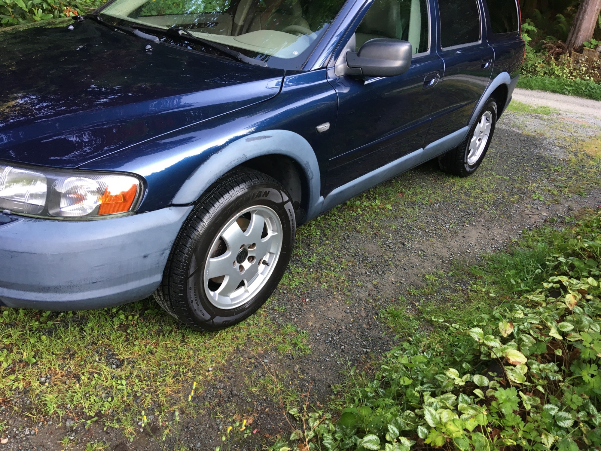

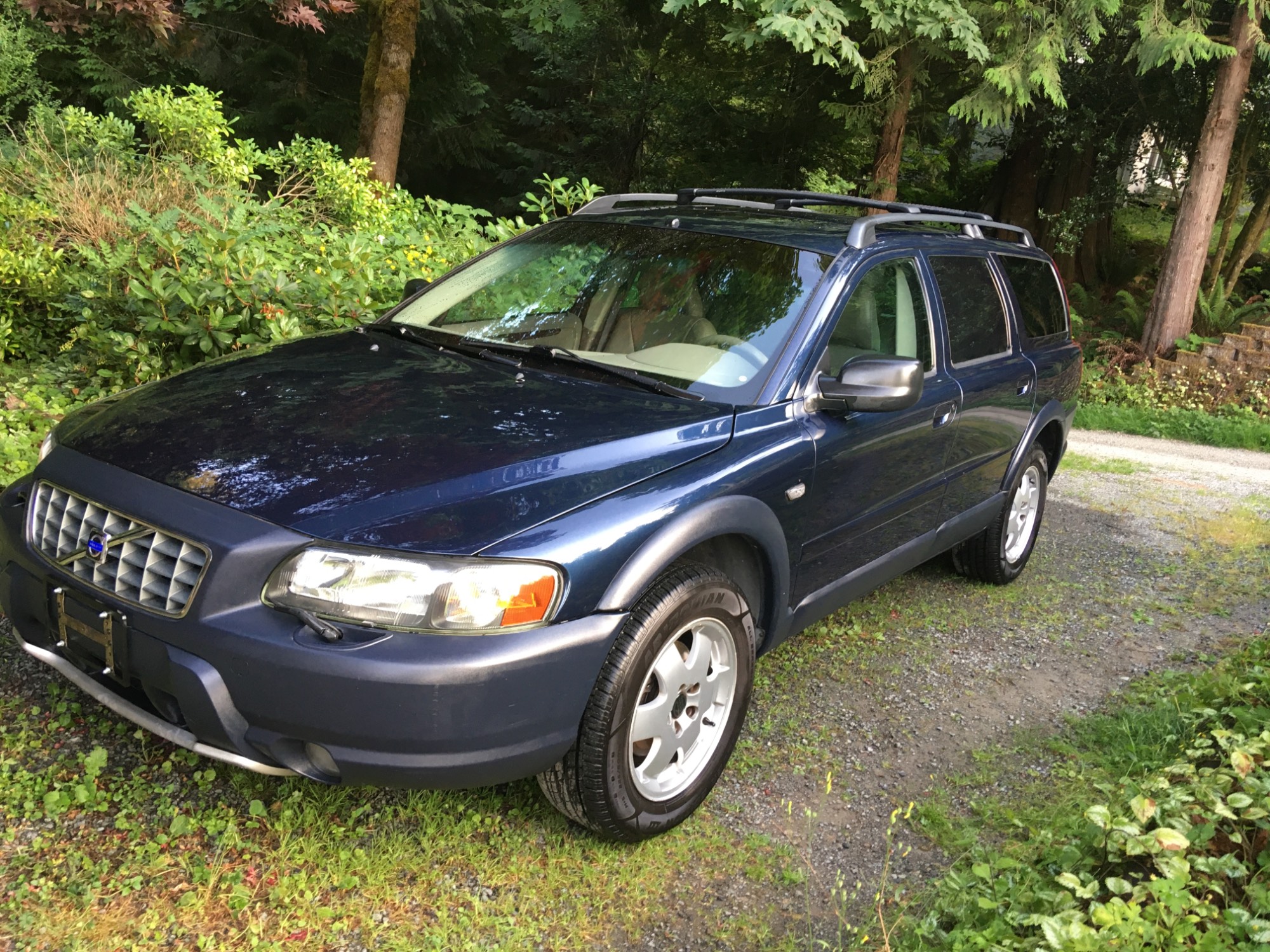

Even more dramatic on my original XC. This car looked just as good 18 months after the photo when rear-ended and totaled (I loved that car, still disappointed and haven’t found one as nice again in years).
Before: After:

.bmdubya1198 wrote: ↑12 Jul 2024, 22:41Linseed oil works really well on the plastic trim!Oro wrote: ↑12 Jul 2024, 19:42 Slowly getting my exterior detailed after long neglect. Today I refinished the lower body cladding and door strips with boiled linseed oil. I’ve done this before and it looks great and lasts a LONG time. Only downside is it takes a long time to dry, so I stuck the car in the garage for the weekend.
The “before” picture is misleading; it looks MUCH worse in person.
Before (looks worse IRL):
After:

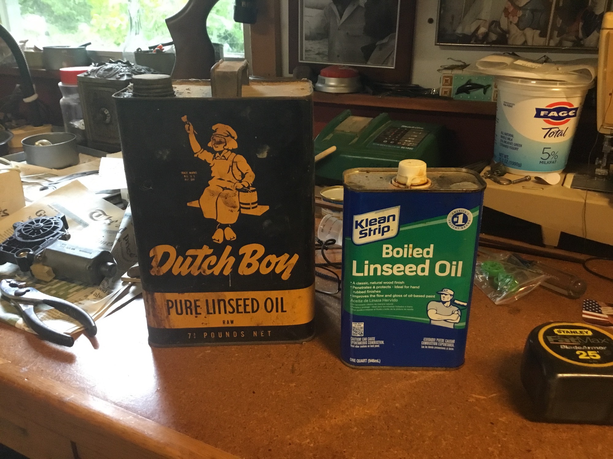

You mean Lowe's or food grade linseed / flax-seed? Can it be applied to painted plastic also? Do you wipe on and wipe off? Some use transmission fluid.
https://www.lowes.com/pd/Jasco-32-fl-oz ... l/50298071
https://www.britannica.com/science/linseed-oil

.Oro wrote: ↑12 Jul 2024, 23:32Even more dramatic on my original XC. This car looked just as good 18 months after the photo when rear-ended and totaled (I loved that car, still disappointed and haven’t found one as nice again in years).
Before:
After:

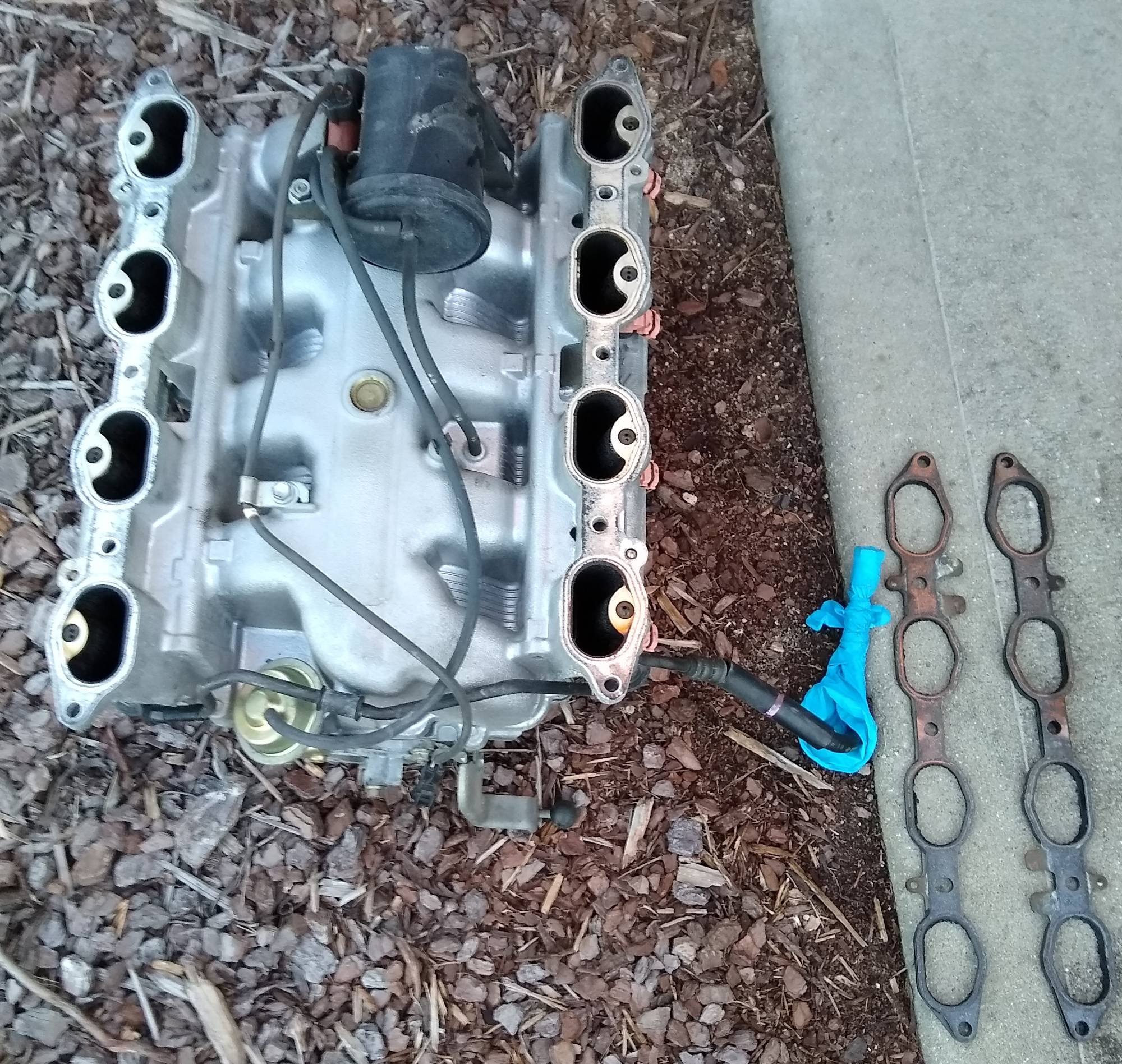

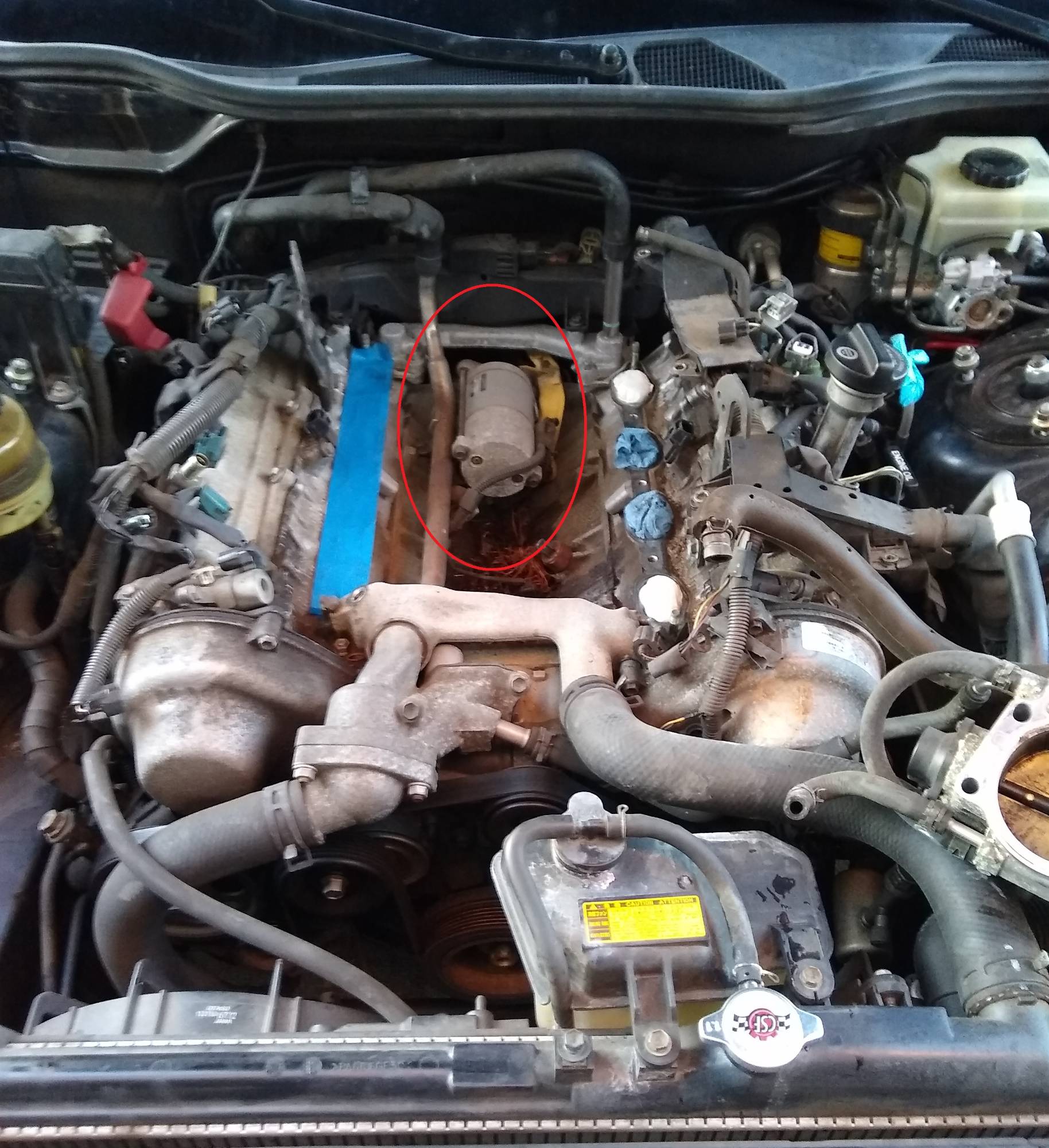

Reminds me I have to get to installing the starter and putting back the intake. Never would consider blue but wanted a V8 so CoPart_ed one. Last V8 was a 95 E420 handled down from parents after they stopped driving. Exceptional when cleaned up and very unique. Son drives it and likes it better than the 09 S60 2.5T AWD he is driving now till I get this back together. Unfortunately, it bit the dust from a Jeep T-Boning it backing up in a parking lot. Still driving it and feels like new as nothing had happened to it and no side curtain deployed. Hope to settle soon but it's going to be thinned from the herd at 118K

Reminds me I have to get to installing the starter and putting back the intake. Never would consider blue but wanted a V8 so CoPart_ed one. Last V8 was a 95 E420 handled down from parents after they stopped driving. Exceptional when cleaned up and very unique. Son drives it and likes it better than the 09 S60 2.5T AWD he is driving now till I get this back together. Unfortunately, it bit the dust from a Jeep T-Boning it backing up in a parking lot. Still driving it and feels like new as nothing had happened to it and no side curtain deployed. Hope to settle soon but it's going to be thinned from the herd at 118K.

RE: boiled linseed oil - yes, like you linked. Typically a wood finishing product. It is phenomenal for coating body plastic. You really want “boiled” and not raw. The boiled is already slow to dry, the raw is way too much. I have a can I’ve used on tons of gun grips, furniture, rifle stock, several cars - still got a lot left after 10 years. So it will last a while.
1 - Get the plastic clean. I used a magic eraser pad (I get the generic ones at Home Depot, cheaper), and some Goof-Off or other solvent if you have sap, over-spray, etc. on the plastic. This did not take very long really.
2- Then just go around and wipe the BLO on with a clean lint-free cloth (I used old cotton t-shirt/socks etc. I keep for things like this). It’s pretty quick, also.
3- garage the car a day or two if possible, or do it when the weather is clear and calm. The stuff takes a day or more to get touch-dry and will get dust, etc. in it. But when it dries, it dries with that “wet” look and lasts a long time.

Judging by the caliper of expertise of the posters I’m assuming that the boiled linseed oil is of course safe on these plastics and I was wondering if it is safe for the rubber weather stripping around our windows and other such rubber pieces. This to me is a marvelous revelation. I have a beautiful antique 1 gal can I inherited from my grandfather.
It’s the raw and what little was left is dried up but I remember that can sitting on a top shelf in his workshop a long time ago so I plan on dying with it sitting on the top self in my workshop. But I do have the right stuff.

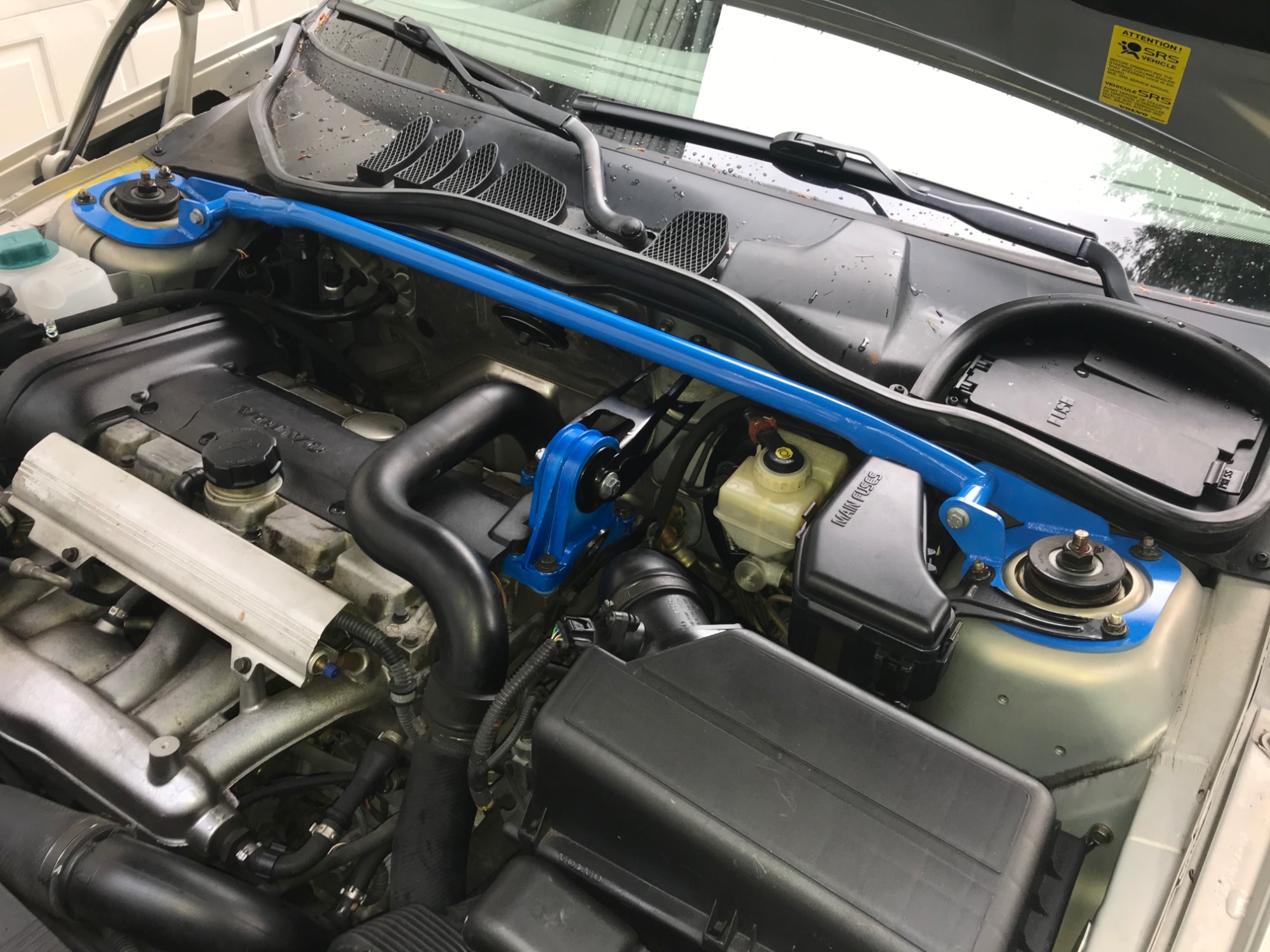

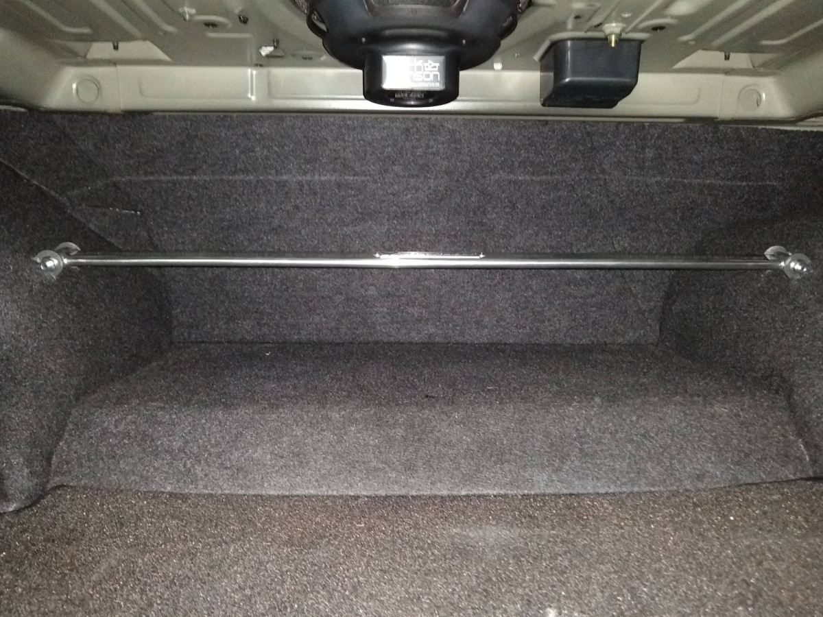

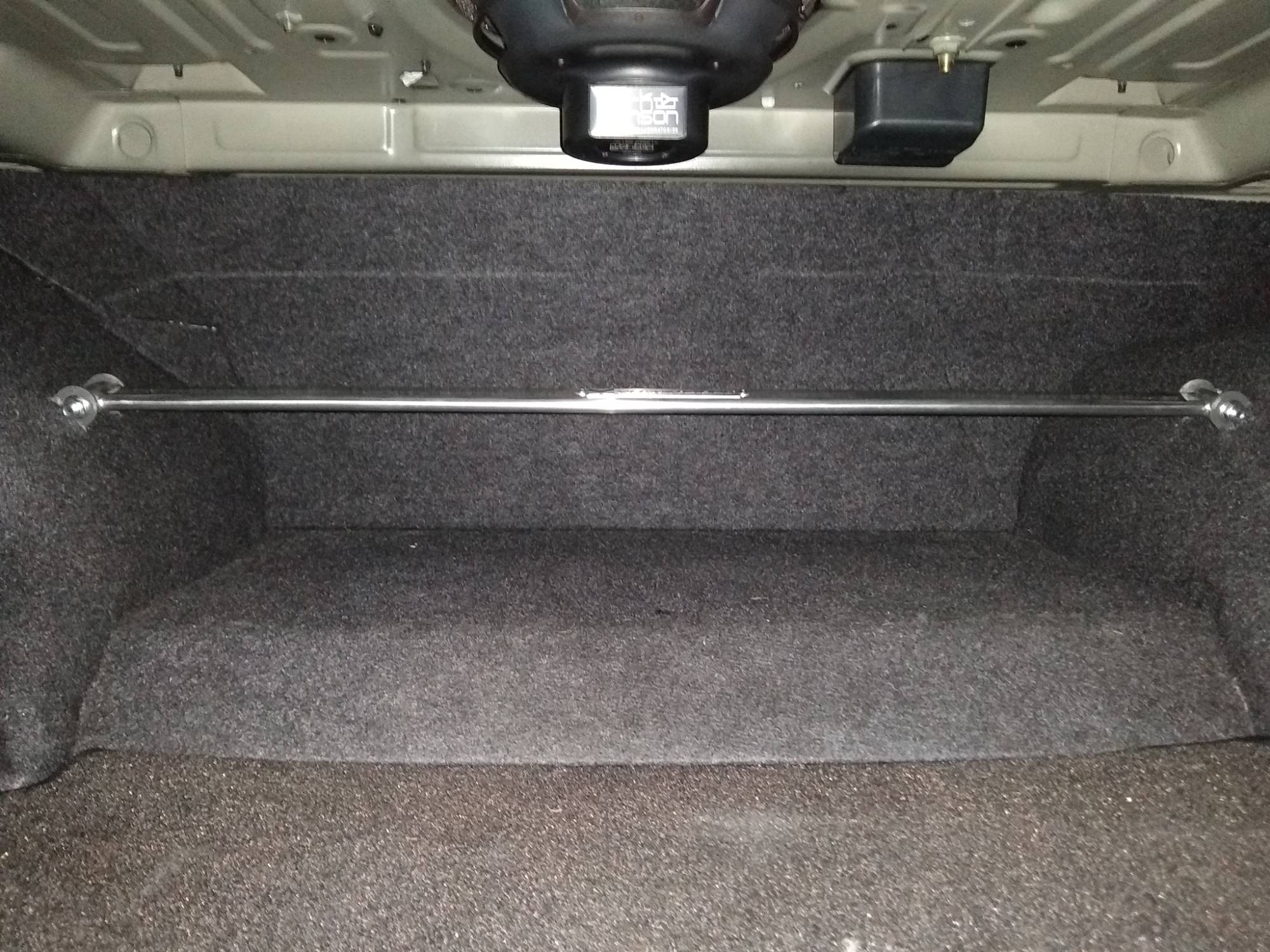

Have the blue Megan front strut tower bar also, not pictured.

1) That Kleen-strip BLO is what I used, exactly. I think the other antique can may be raw linseed oil.

This is even funnier, because besides a blue/tan GS430 being what I want, a P2 S60 awd is what I got for my step-son and he drives. I modded the suspension a bit - iPD inserts, converted engine brace to proper strut bar (aka, the “Bob Villa” mod). It handles really well and I really like driving it.

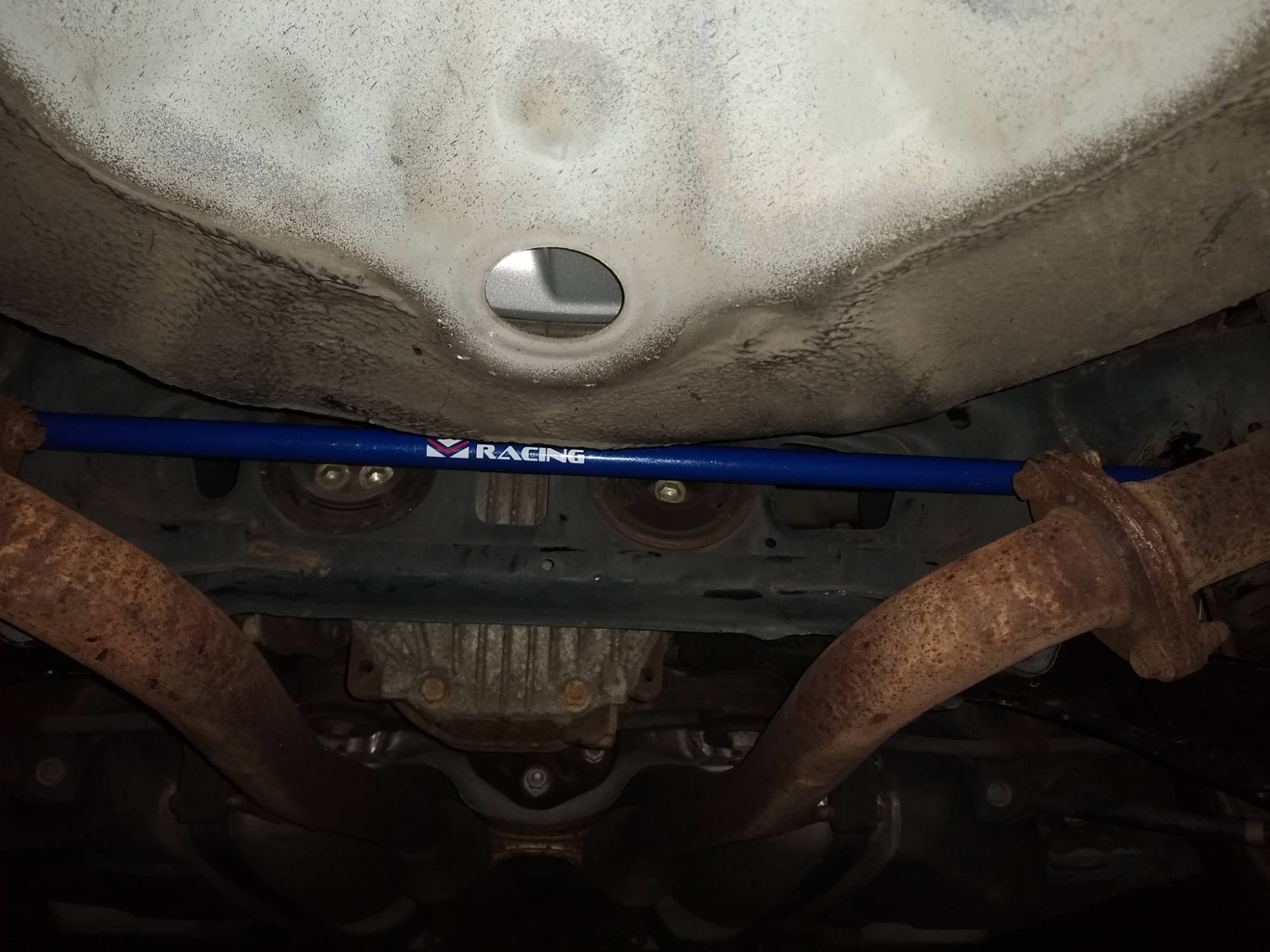

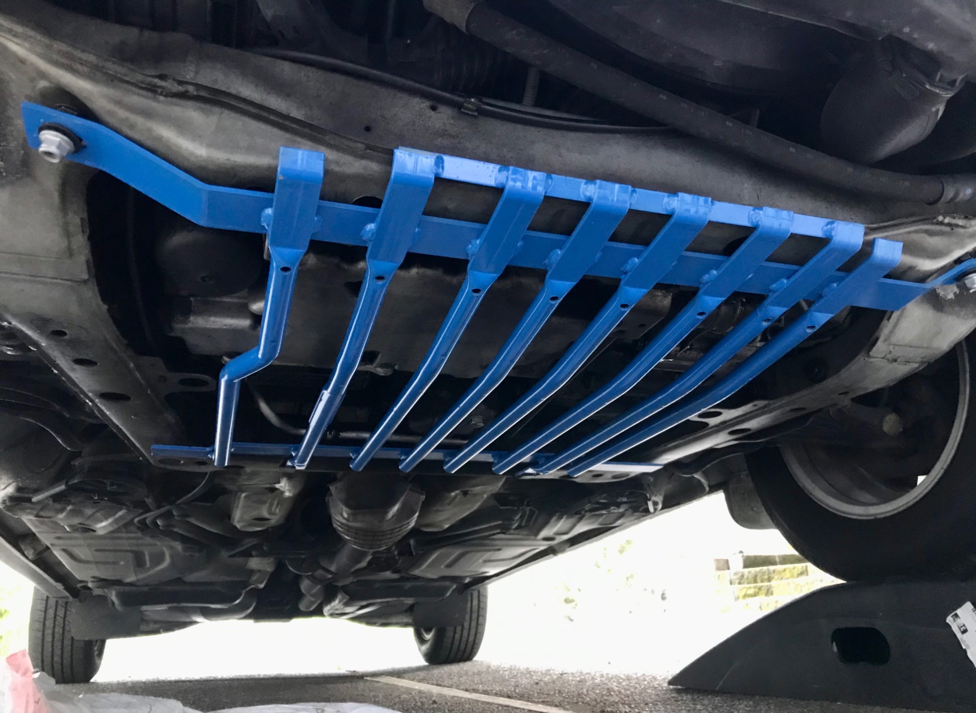

Those braces remind me of something relevant to P80 cars - there is a pretty cheap and very effective way to brace the front top/bottom.
1) Volvo offered an Ohlins strut brace as a factory accessory. A helpful dealer can still special order them and the prices are now lower than in the past. I got one for about $95 in 2021.
2) Volvo offered an “engine grating” for the under-body. When installed, it makes a VERY effective sub-frame brace and greatly stiffens up the front. They are aslo a special order item, but I got one for not much over $100 from Sweden. Smith Volvo in San Louis Obispo did the ordering for both, prices included shipping to my house in WA.
They come galvanized, I just painted them in Volvo colors for a kick. They really sharpen the handling on these cars and do not really compromise ride quality in any way. If someone wants to order these and see if still available, ask me as I’ll dig up the exact part numbers as on the grating, there is an error in the description. I know I have the details in some old emails w/Smith Volvo - who were exceptionally helpful.
Ohlins “factory” brace (I painted blue).
This is the factory engine grating. It is robust, and as you can see it bolts firmly on the front subframe cross-member. There are two slots in the rear cross-member it slides into; clearly made with this in mind. It is rigid enough it actually functions as an effective brace, too.
