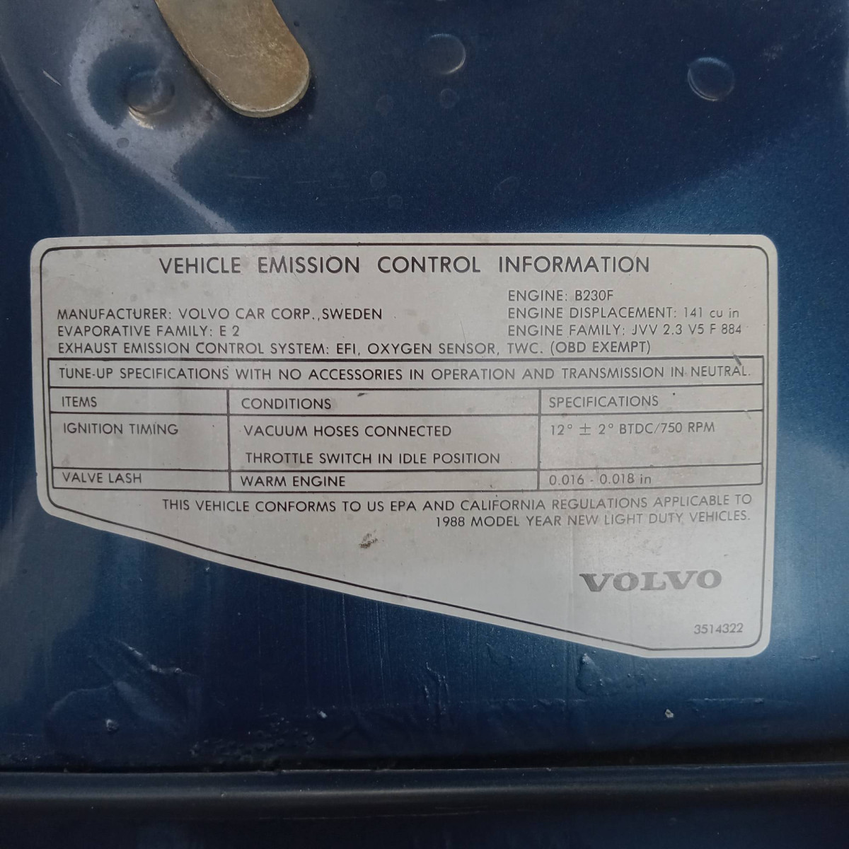

Check your ignition timing with a timing light. Should be 12 degrees.

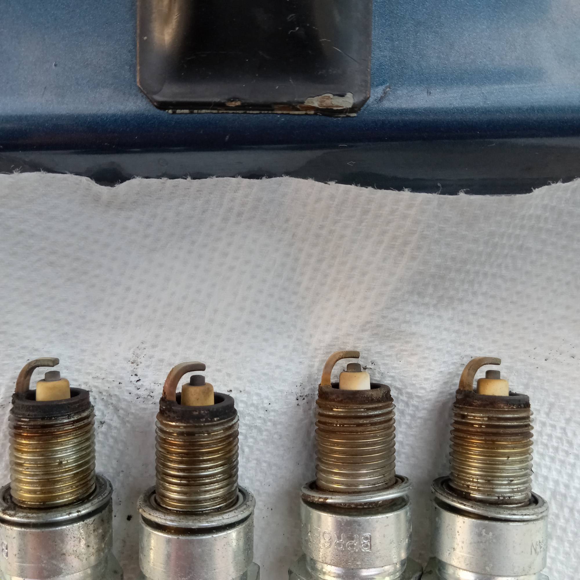

Pulled plugs, they don't look bad. Not what I expected.

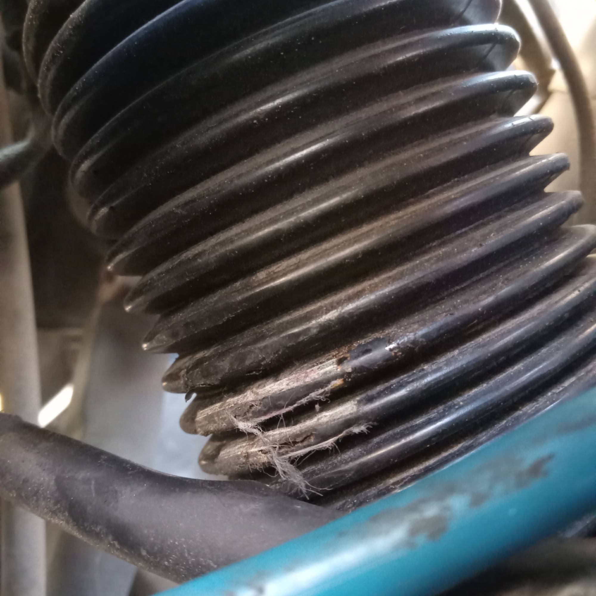

There's holes in the accordion tube from maf to throttle body.
Could that make this drastic of a difference?

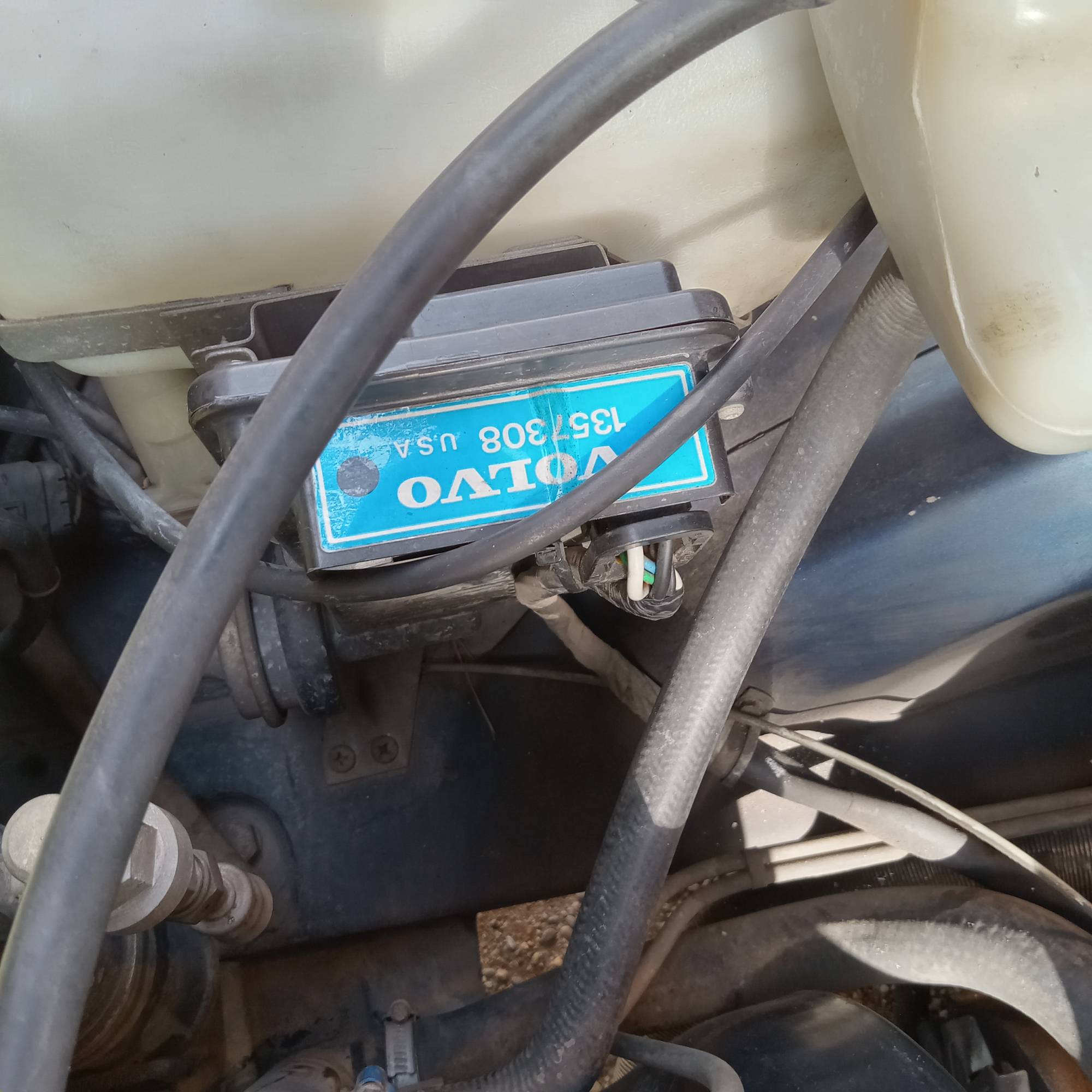

I don't think I have the kjet system, as that started in '89, and I don't have the control box on the firewall next to the brake booster that has. I have this(pic) scary box of magic.

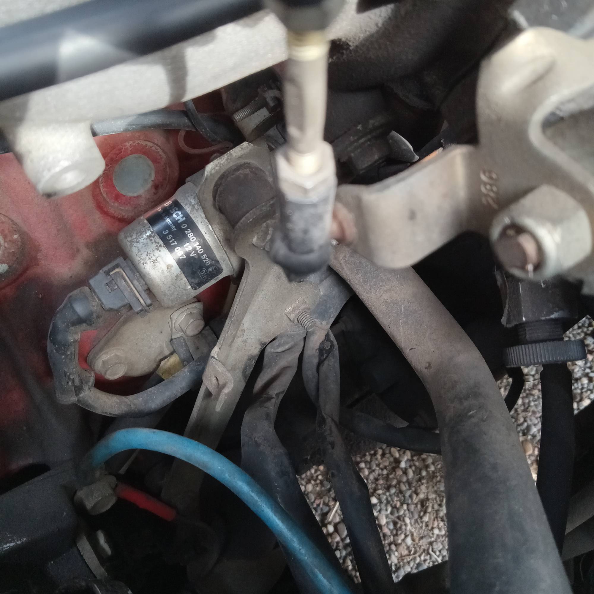

Also, what is this thing near the block? Some air control thing. ????

Yes! Tape up the tube and retry. I had this problem once and I think it would not start.
If it gets better, buy a new tube.

Your plugs look great. Excess fuel is not likely going through the cylinders. Look for a leak in fuel system? Rusty lines?

Check your plug gap. It looks big. Should be 0.028 to 0.032 inch. They also look worn on edges.

Gonna pull it and epoxy, ( plus get a new tube of course) and see.
