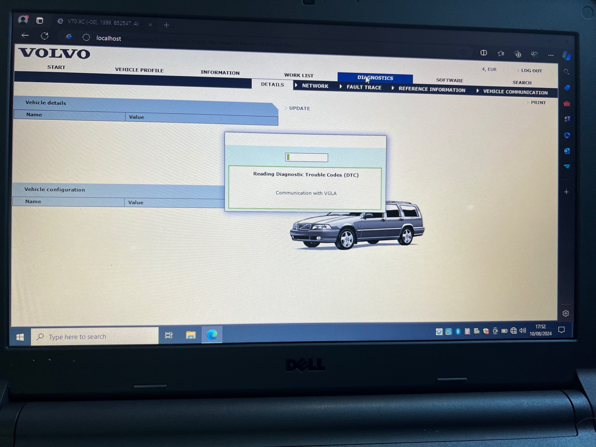

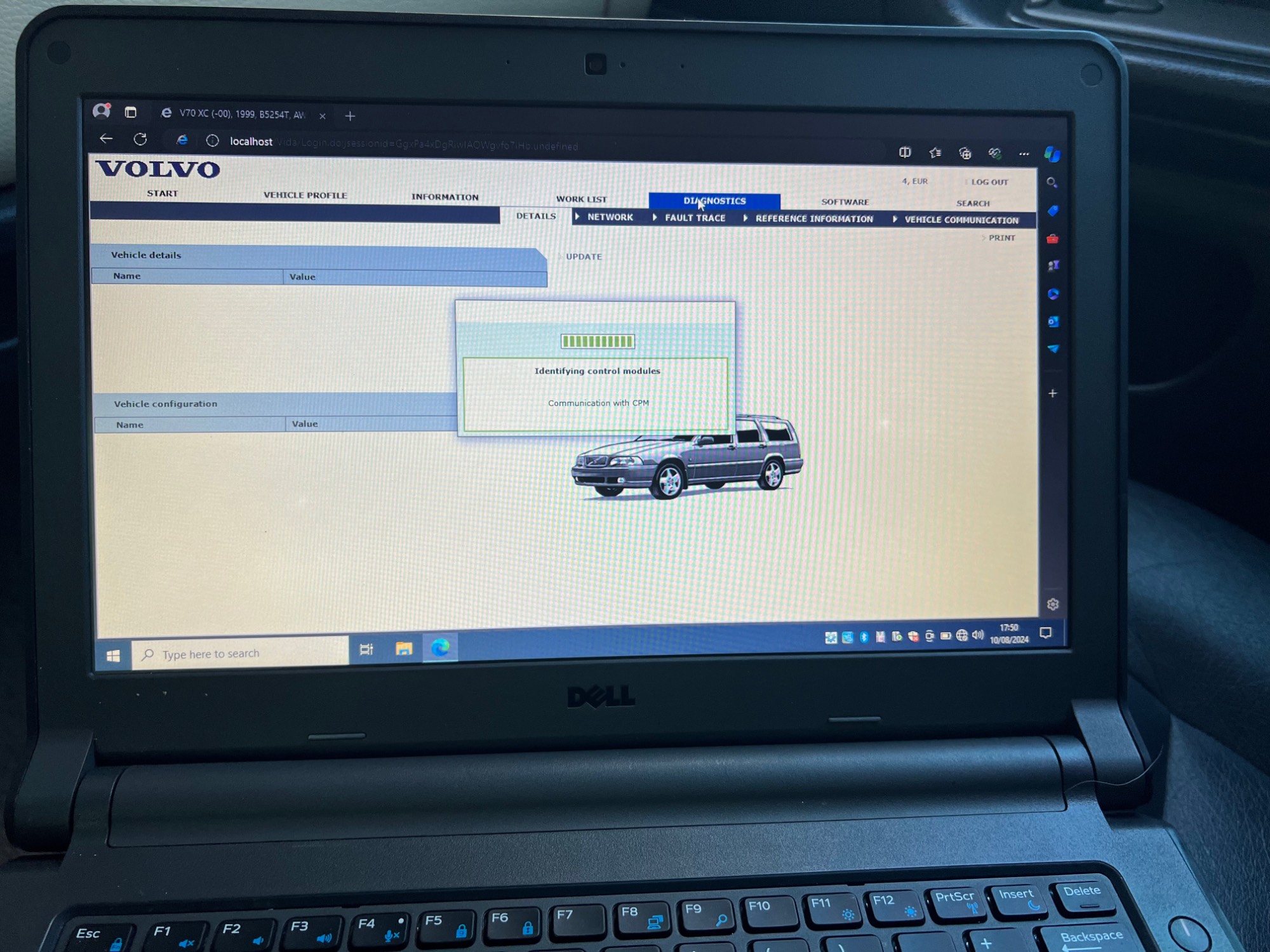

Unit arrived yesterday and after charging the laptop I went out to Yeti and plugged er in. Unit scanned perfectly and gave me all my vehicle info and ran a diagnostic. Hurrah it works!!! Found the fault in my SRS. Pretty sure it has to do with me swapping the seats out from my donor car, but I don't have time right now to dig deeper, I also will be swapping the seat belts out for the units I harvested from my donor car so I will do that before trying to track down the issue.

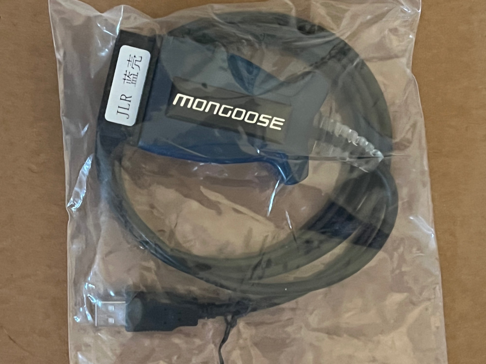

So far very happy and feel the purchase was worth it (especially because it also contains additional software and a Digital Hayes Manual)

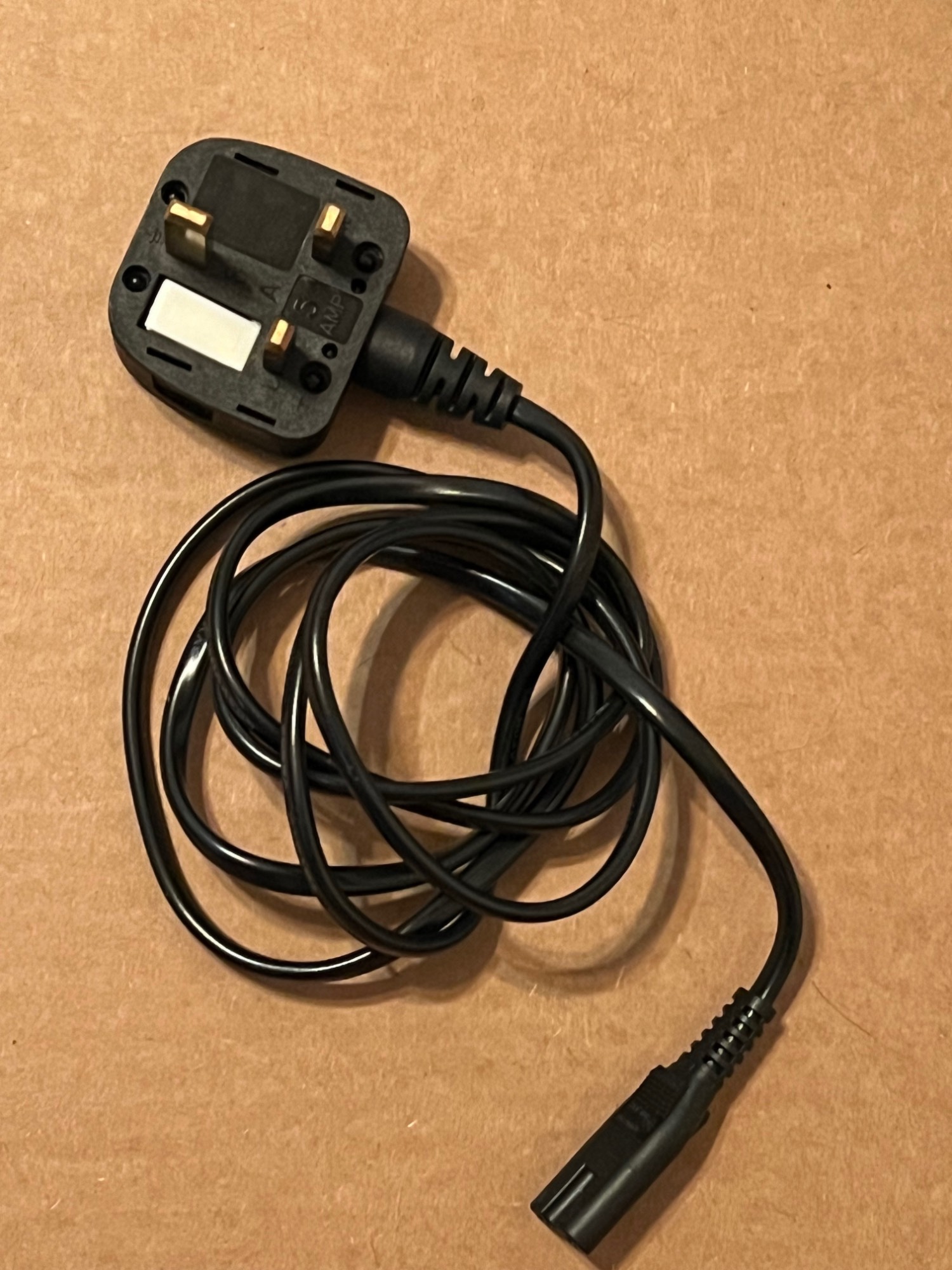

Once caveat - the power adaptor did come with a European style plug - but it was easy to swap it with the 'Merican version - a standard cord I had lying around from some other power adaptor from the past. No biggie.
