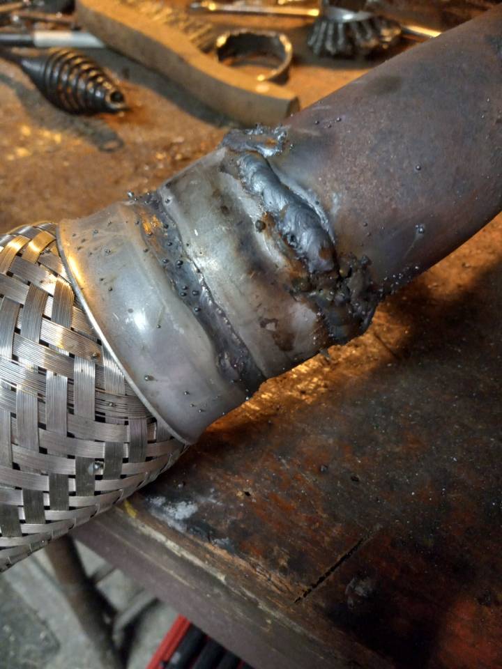

a $15 elm327 from amazon, using free Torque app on your phone, will show the actual coolant temp at 70 mph.
if the temp sensor was changed recently , unless genuine volvo ... its very likely crap.
I bought 2 that were useless, ended up reinstalling the original with 230K miles.
I traced my trouble to the coolant bottle, white dusty deposits were remnants of boiled off coolant,
tiny cracks in the plastic were the source.
loss of pressure = higher temp .
o2c sensor problem is caused by the flex pipe leak, $45 for new flex pipe, (double walled only).
drop the pipe , make a simple wooden jig to bolt it , front and rear, to the bench. Then cut the old flex out.
It can't be done in the car, its totally inaccessible.
Weld the new flex pipe in, tape the ends closed and use compressed air and soapy water to find air leaks and weld them up.
I also found numerous holes in the cat to hanger bracket welds which I ground out and welded closed.
- flex weld.jpeg (81.32 KiB) Viewed 267 times
