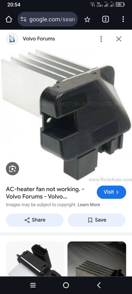

Are you aware that there are two types of power stages...for mcc & ecc?
The one for ecc is power stage with aluminum coolers...the other one for mcc is a simple resistor.
Is the replacement exactly the same like old one?
They also look different...if they are different.
MCC:
https://www.google.com/search?client=ms ... sid=mosaic
ECC power stage: Do you have a proper power stage installed?
MCC:

There were if I recall different part numbers over the years, so please check your replacement is the correct one. If you can't confirm the part number here and we can check for you.
