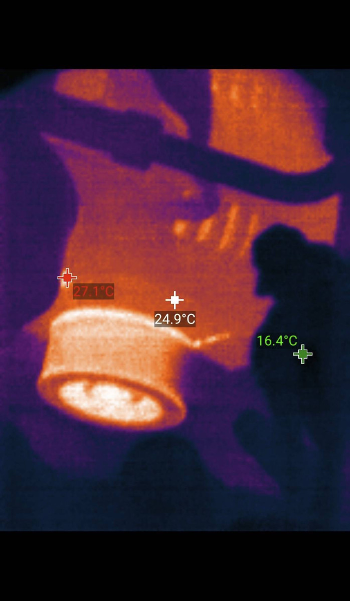

Put new fuel filter and fixed fuel relay back on 850 > No start, read codes and have one for RPM sensor no signal.
(To repeat.. car stalled previously and did run weakly so might been same problem all along)
It is being crumpy and asking more attention after 4 months sitting clearly. I will name it Karen if more comes.
Edit: False alarm.. measured and there is something else going on now as need notify my dashboard i dont get all lights when i turn on. So yes i started doing things when it stopped aka stalled and didnt try again so it can be already existing problem now got triggered to be a problem. Lets continue digging.
Here tested cables at starting. Plus cable way more hotter than ground cable does.
But why would my alternator get warm so quickly just at starting? Suspicious.

xanthefin wrote: 18 Sep 2024, 10:56 Put new fuel filter and fixed fuel relay back on 850 > No start, read codes and have one for RPM sensor no signal.
Well, your alternator is pumping out a lot watts to replenish that battery after starting , probably 30 amps or so
That’s about 400 watts of electrical power, and at 90% efficiency, that’s 40 wats of heat.
Touch a 40 watt incandescent light bulb. Do it quickly so you won’t burn your finders!
