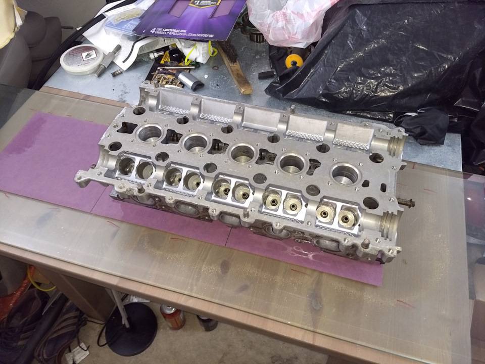

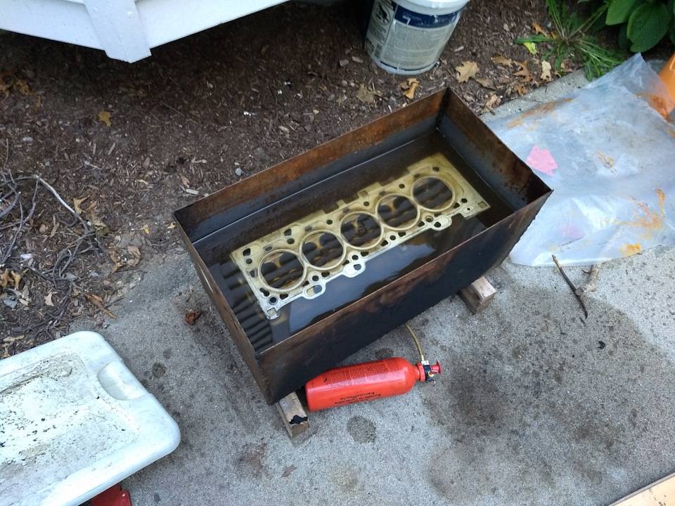

I would refrain from using a high PSI pressure washer, like 3000. 1700 PSI didn't do any damage. But it won't do any good without hot tanking.
Weld your own hot tank! I got 4 or 5 pieces of 2"x1" zinc plated steel sheets from Home Depot and stick welded a tank. MIG would be much easier. Also don't breathe fumes, zinc plated steel is not for welding and highly toxic.
MSR camping stove heats it up to 160-170 F, compressed air agitates the Simple Green + water solution. Take it out from time to time, let it air cool a bit, power wash what you can, put it back. When satisfied with the result, rinse with water well and spray with non-aerozol WD-40 or PB Blaster to prevent oxidation. I managed to clean all the parts very well and for cheap.
