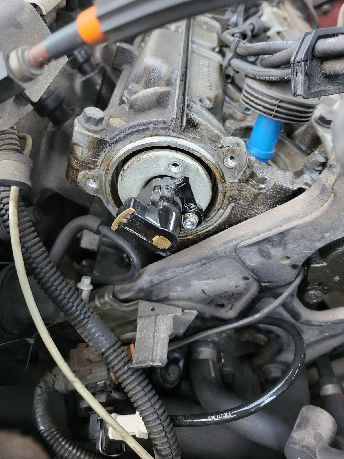

hausmeister wrote: 27 Sep 2024, 09:47 Regarding distributors, the last one I replaced (bosch) I tried to clean the contacts and it honestly looks pretty good and solid still. I kept it for a rainy day, but really - could it be reused for an extended period? Just curious, if the contacts are not worn out, are there other considerations?
(You know, keeping the ex as a spare ;) )
They are quite expensive now, I almost feel stupid for throwing 1 or 2 away when I replaced them as a tune up item.

That cap doesn't look to be worn, but rather it has deposits on it. I'd bet the rotor is what was worn. When I re-newed my ignition, my new cap hadn't arrived yet. I cleaned the original cap, but the rotor had metal missing. The car ran fine with a new rotor and cleaned cap. I did eventually get a new cap installed.

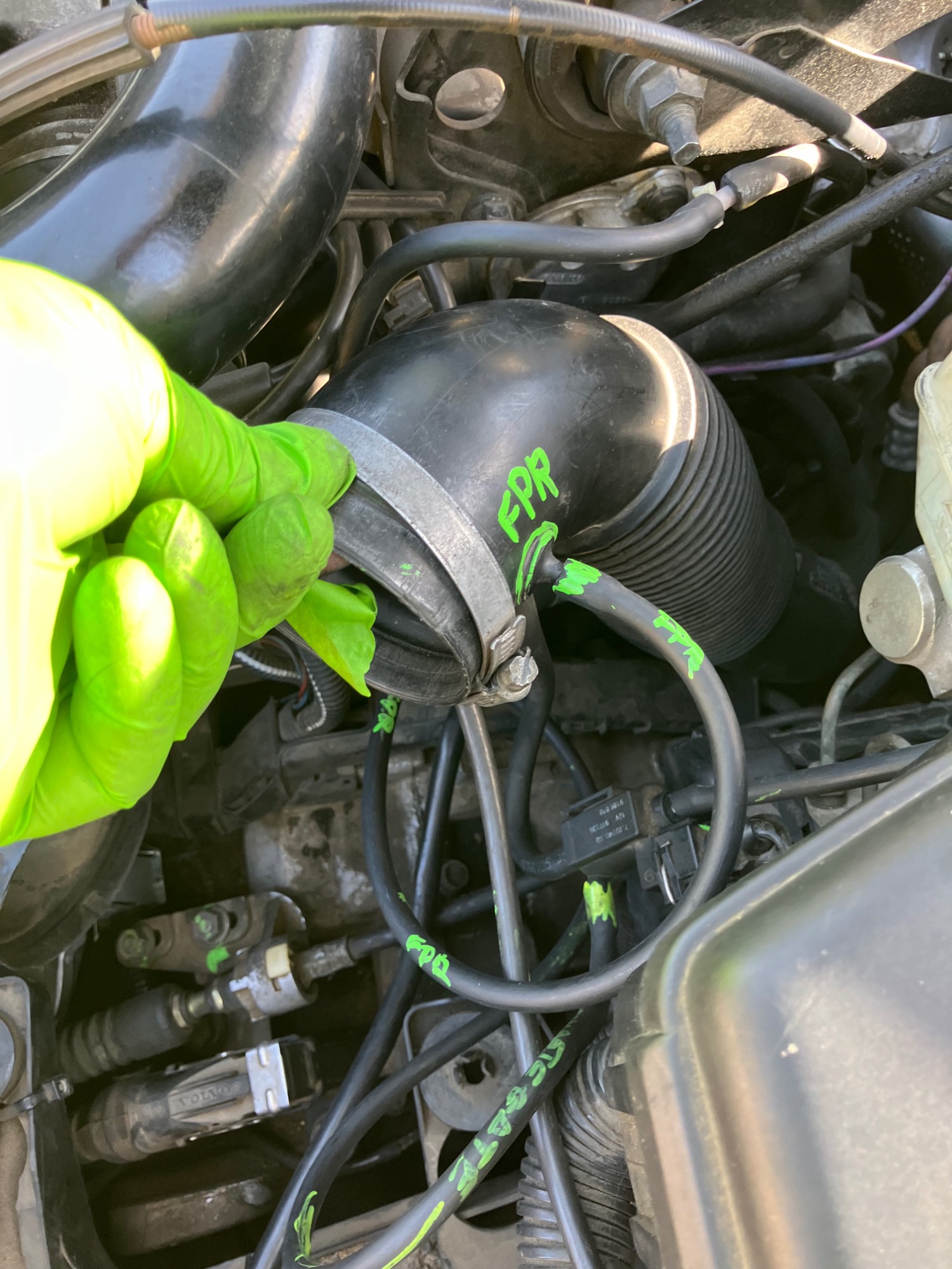

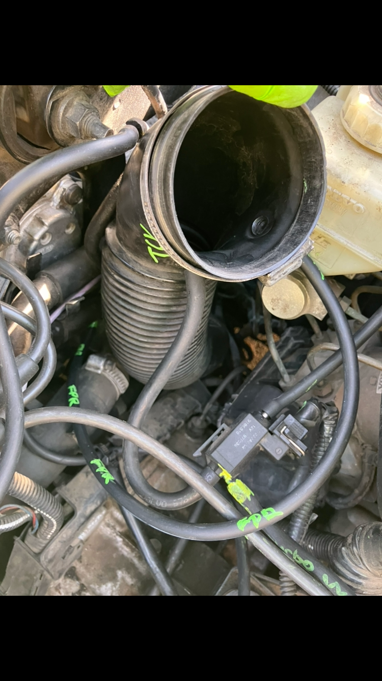

Replaced some vac lines. Couldn’t find good pictures of the intake to fuel pressure regulator line so here ya go if it helps. Helps to take the box out and lift the intake tube to access the nipple
