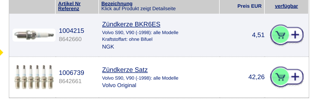

My engine vibrates unevenly when under 1000 RPM and am thinking of changing the spark plugs. But, there are many different spark plugs, first and foremost different by price. Some cost 4 euros per piece, others, like the OEM, cost 40. In my manual it says that i should get for normal use the P/N 271636-3(oder similar) which have electrode distance of 0,7-0,8 millimeters. On Autodoc most have bigger distance and on Skandix the OEM spark plugs cost 42 euros each. I added a screenshot of the spark plugs from Skandix.
Can anyone tell me which to get in order for my car to drive well and me not needing to sell a kindey?!

Well the higher price is a kit so slightly over 10EUR piece.
I am cheap and on 850 i recently went on cheapest Denso K20TT spark plugs. Technically slightly incorrect gap.
But my problems of not starting in the end was at distributor being "gone" and rotary too inside it. My weared spark plugs definetly had bigger gap due wear but were still okay-ish running. There is too times spark plugs can break internally and then there is fake spark plugs with internal resistance being all over place.
I would in your case personally maybe not right.. suspect some cylinder doesnt have any spark / lost spark or fuel injection having problem if such clear problem.

Hey, Thanks for the answer. As soon as i change the plugs ill see where and what can be the issue. For now i bought the set for 42€.xanthefin wrote: 06 Oct 2024, 13:39 Well the higher price is a kit so slightly over 10EUR piece.
