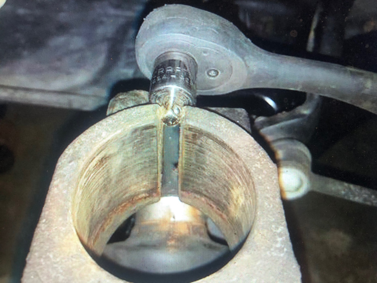

Actually in hindsight. I did this:
Used a 3/8” to 1/4” socket converter.
Twist the square end into the knuckle slot. Worked great!

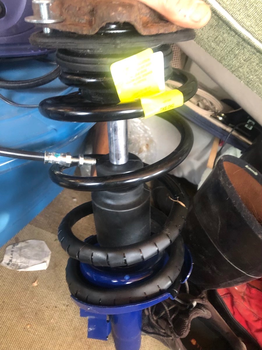

Just did this same trick yesterday, worked great. Finally had a day off to try to swap in this Mazda strut.
So my strut spring was destroyed.
I removed the entire unit. When I saw the new unit had instructions I skimmed them, and saw I should have (?) marked the orientation of the upper mount thingie of some kind to orient the new one in. I did NOT do that.
HOW DOES one - does one need to - ORIENT and new strut and / or strut bearing / strut cup whatever it's called into the car? I know the strut itself only goes in one way with the steering knuckle pinch bolt, I'm talking about all the gack above the strut and spring. All that turn-y stuff. At a glance it appears that some of that upper stuff is slanted in one direction. I don't have the stock setup to compare as it's largely now a pile of parts (I had to angle grind off an ear so I could get enough vice grip bite to remove a bolt that broke the insert out on the strut bearing.)
I also broke two bolts and two inserts which made the removal and reuse of some parts a lot more time consuming.
I thought the new strut came with everything, but I have to reuse the very first metal piece that sandwiches at the highest spot on the strut and goes directly against the car's unibody.
The Mazda strut looks like it's going to be a winner. If ride height is a tad off or if it handles stiffer on one side I don't really care at the moment I just need to get this d*mn car on the road again. It's been down probably 40% of the total time I've owned it for 5 significant repairs. Mostly front end suspension stuff.

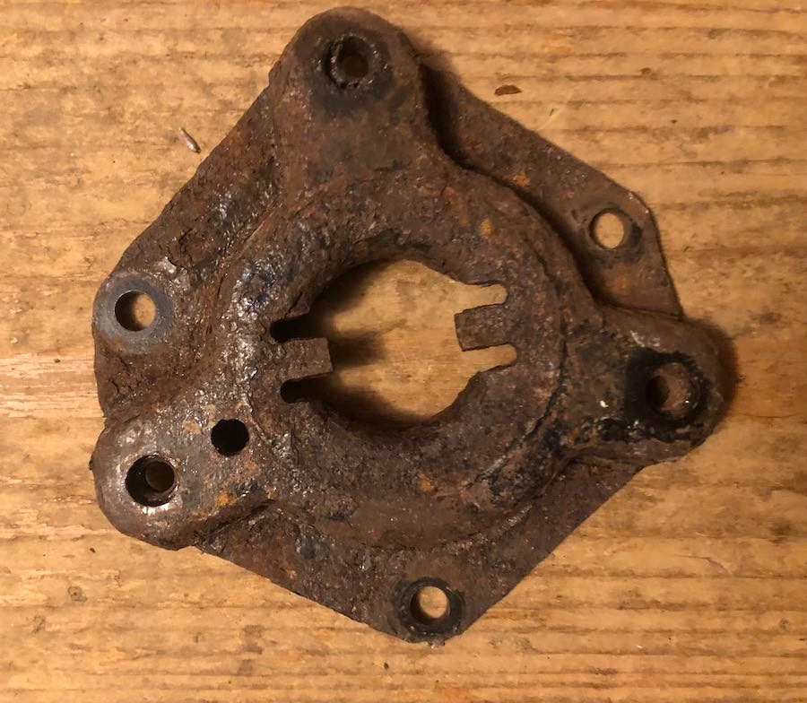

Here's some pics of that spacer I'd be wanting to post, and also how the spacer mounts up and is oriented.
It turns the regular strut for FWD vehicles 180 degrees backwards from normal. If you look at it all - it all eventually makes sense how it has to go back in. (yes, notice how 'rust free' my AWD spacer is. again, it's listed as about 3/4" thick to raise the front end that much for the AWD V50 Volvos compared to FWD).
This Monroe kit came with huge washers. I angle ground cut them down to fit in the spacer. No big deal, but had to cut it 3x to get it right. Could use other washers, or hacksaw as they are not thick.
These Mazda 3 Monroe shocks fits very well here. A great option part to look for.
