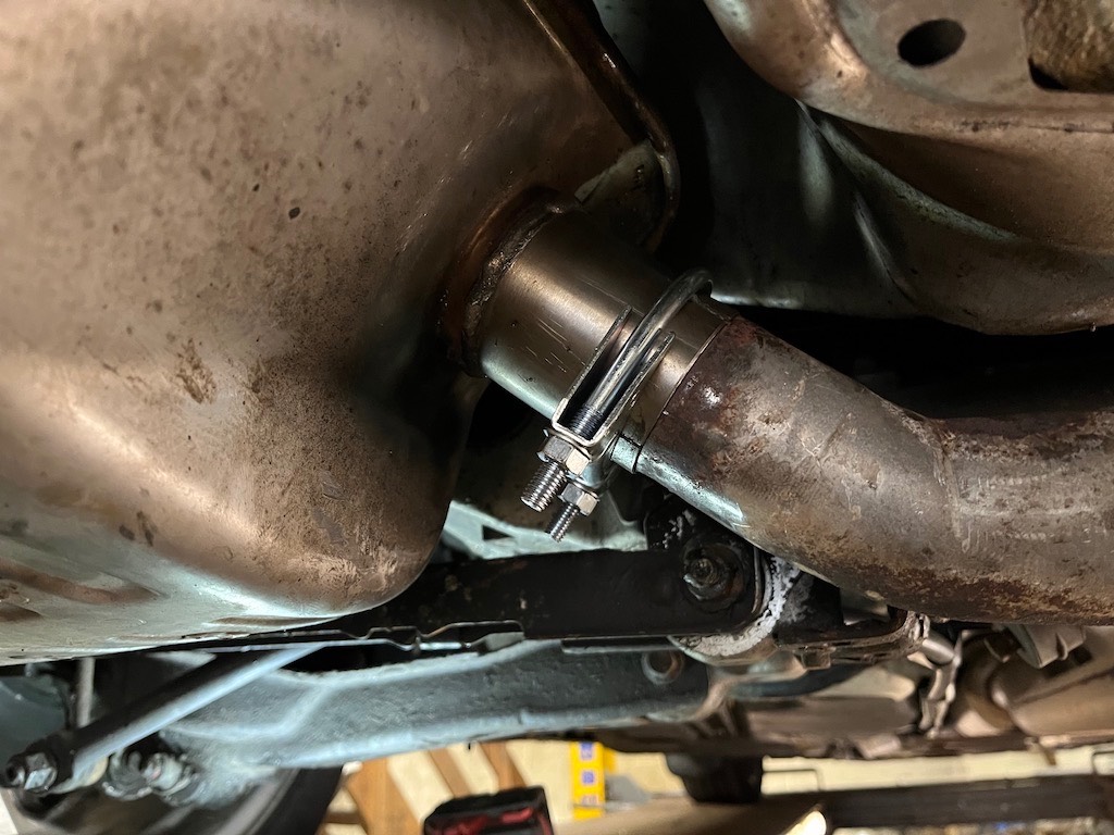

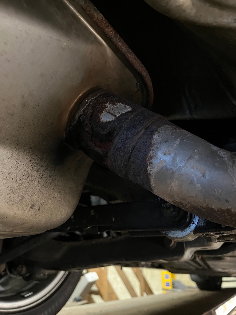

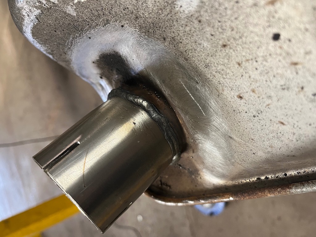

One of the items my MOT guy pointed out was an exhaust joint that was starting to look a little crusty so today it was repaired at C&C Exhausts in Hillington. I've been using their services for around 20 years now and highly recommend them for any exhaust work.
Clamp removed to determine what action was required New pipe welded onto the rear silencer box All back together

Nice job indeed!

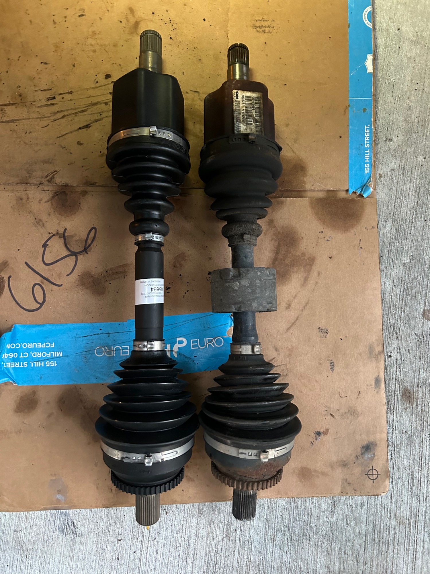

On the green 07 XC70 we had been getting increasing vibration under load at all speeds but especially on the highway. Given repair history and symptoms, driver's side axle (196k, factory part) was most likely the cause.
Couple days ago after work I swapped the driver's front CV axle with a rebuilt GKN unit. Bought from RockAuto as it was $100 cheaper than FCP.
I'm getting too familiar with P2 axle swaps, working slowly it took 2 hours from jacking up the car to having it back on the ground and off to test drive.
chock wheels
remove axle bolt
jack car up put on stands
take wheel off
remove top end link from strut 15 mm
remove ABS sensor 8 mm
unbolt brake caliper by slide pins 8 mm hex, zip tie to coil spring
remove both strut to steering knuckle bolts 18 mm and 21 mm
press axle out of hub with the back end of ratchet
pop out of transmission with 5/8 chisel and a tap with a 2 lb hammer (hooray, this went easily)
visually confirm a match with the new part
No vibration damper on the rebuild but otherwise looks good. lightly grease trans splines of new axle, install into trans, into hub (hub still has anti-seize on it from recent control arm job)
make sure the axle dust seal is in good shape and properly installed
replace strut to knuckle bolts, hand tighten
while pushing top of brake disk to max out negative camber, tighten the strut to knuckle bolts
re-sand and re-grease caliper slide pins, install caliper and remaining parts, torque down fasteners, install wheel
drop car down
remove plug from end of new axle and install and torque new axle bolt
Test drive went well - axle was the source of vibration.
