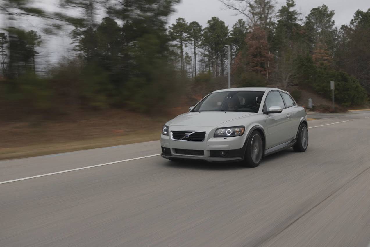

Having owned our 08 C30 for, just checked it's 6 years and doing all the work ourselves, may I suggest having the rear adjustable camber arms installed now in order to eliminate camber wear on the rear tires. Our car when purchased had heavy cupping, inner edge wear and tire noise from the wear. A set of Bilstein in the rear and replacing all 4 tires the car was quiet.
Soon after I installed the 1AAuto rear adjustable camber arm kit. After 25K miles 5 years on a set of Michellins they were still evenly worn when replaced. Best to take care of this now with your mechanic so you don't have to change the rear springs as he will have to do another alignment if and when you can find the springs you want. Meanwhile the rear tires will wear unevenly if left alone.
2008 Volvo C30 Rear Driver & Passenger Side Upper & Lower 4 Piece Control Arm Set TRQ PSA62119
https://www.1aauto.com/ford-mazda-volvo ... 07765/2008
