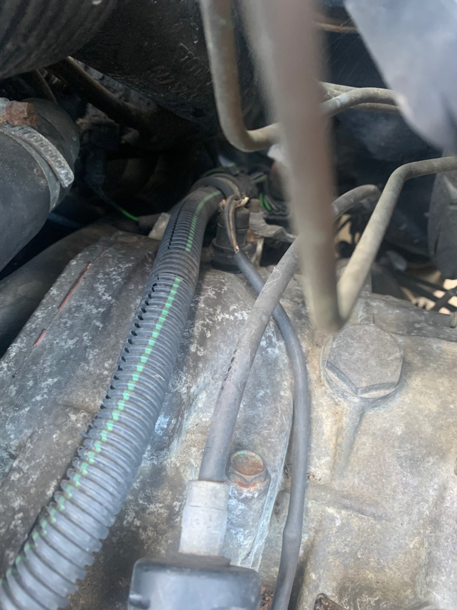

It's throwing the code P0016, and idk if this is my crank sensor or not. The only reason I'm unsure is because the one I ordered (Part Number 907-962) is way to short compared to what I believe is my sensor. The one pictured runs about 2 feet to a cluster of plugs at the front of the car.

There are 2 options for this sensor in 2002. That is the sensor. P0016 also can be the cam position sensor and a bad CVVT solenoid and valve. I have been fighting this one on an 02 XC70. Only recently discovered the code can be the crank sensor. Not swapped that one yet.
https://www.rockauto.com/en/catalog/vol ... ensor,7196
If you check this link you will see the 2 different sensor types.
This issue can also be caused by dirty oil and filter. I believe if none of these work, it will be time to remove the oil pan and replace the O-ring seals that seal the oil feeds to the head.
