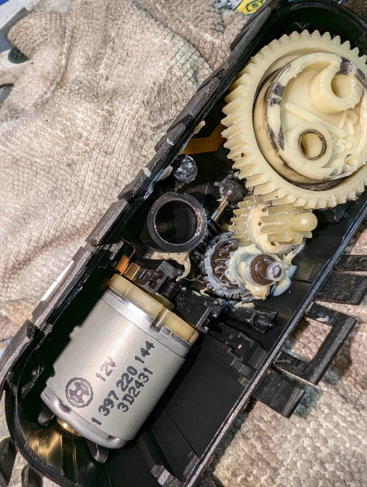

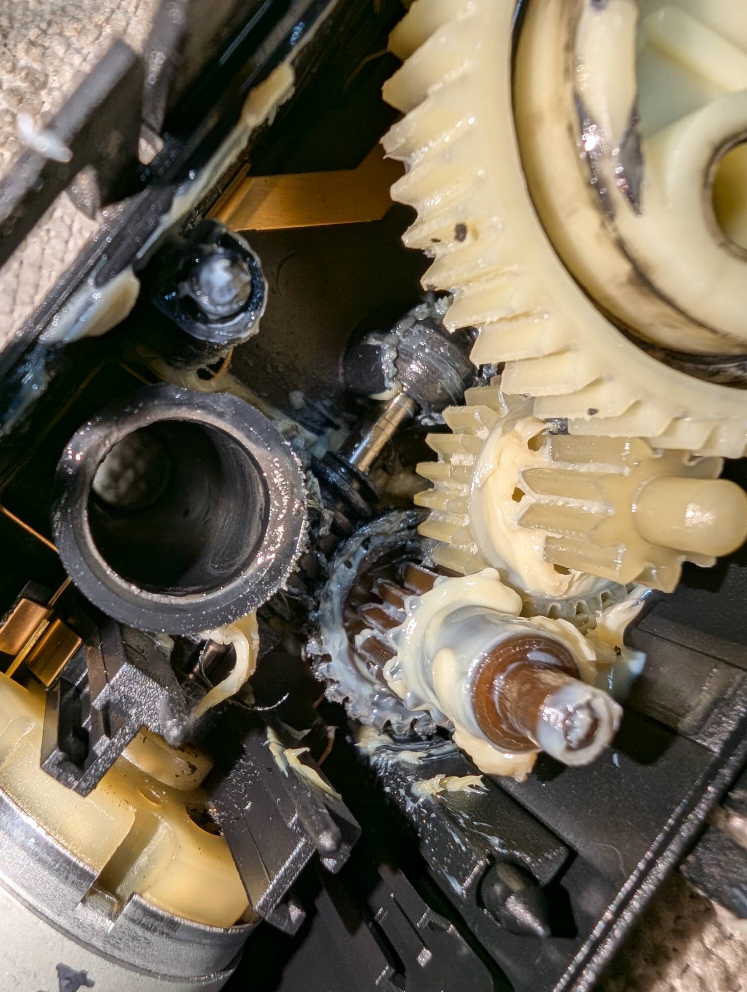

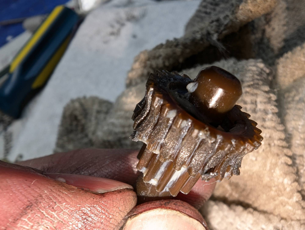

The usual fight to open the case and hope not to break the multiple plastic tabs in the process. I opened the first unit. The video guy showed the issue with the plastic/nylon large cog wheel which attaches to the wiper arm spindle. The first unit this was totally free to move and no issue, so looked further in. Yikes, the worm drive gear on the motor shaft had stripped. Um, so had the teeth on the gear it attaches to.

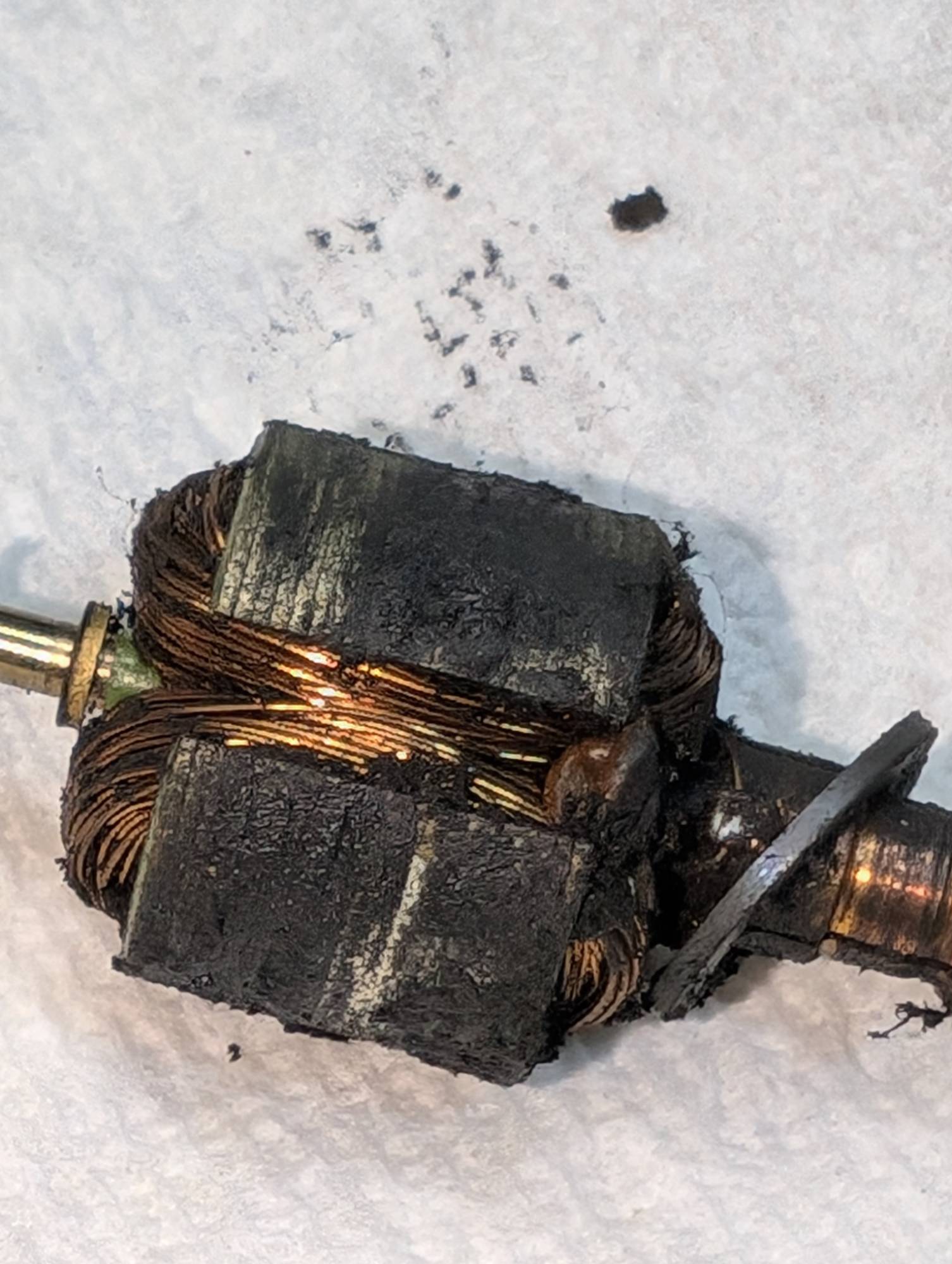

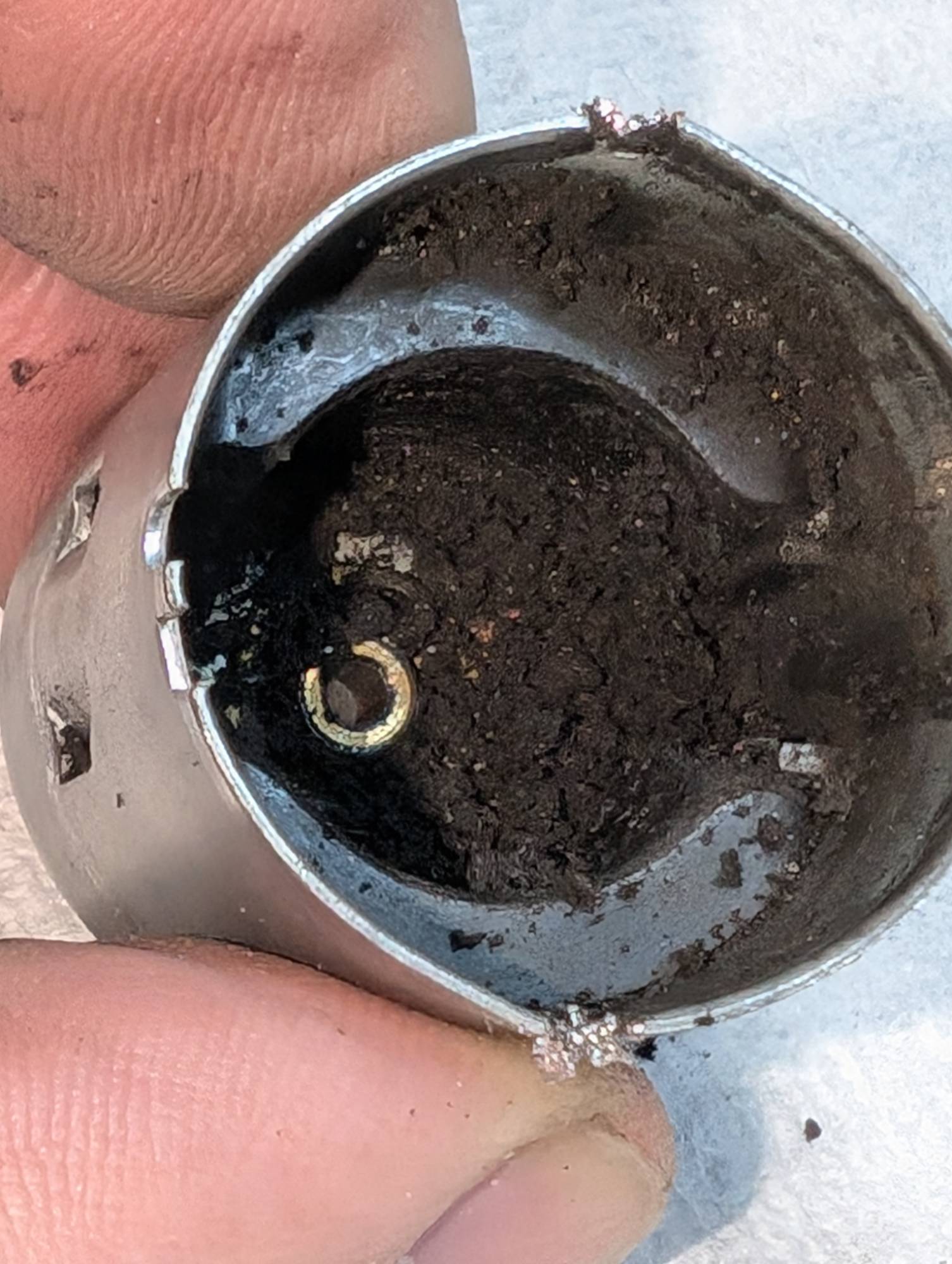

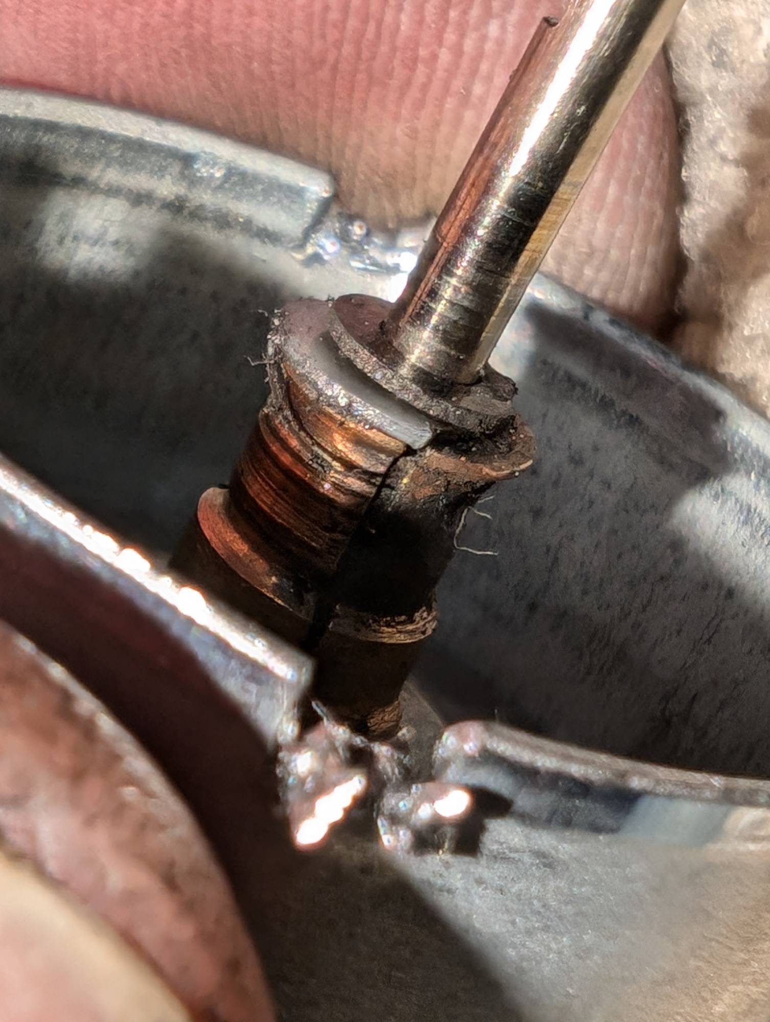

Well that unit is junk. Can't return as mentioned above. So thought I'd open the motor to see why it does move. Wow!! It was totally full of carbon brush material. I guess the brushes were done. As was the contact face on the rotor where it fitted to as half of the copper/brass contact surface had disappeared. So the motor is dead as well.

If you look closely at the black worm drive, the center position the ridges are much wider due to being almost worn off in the middle.
