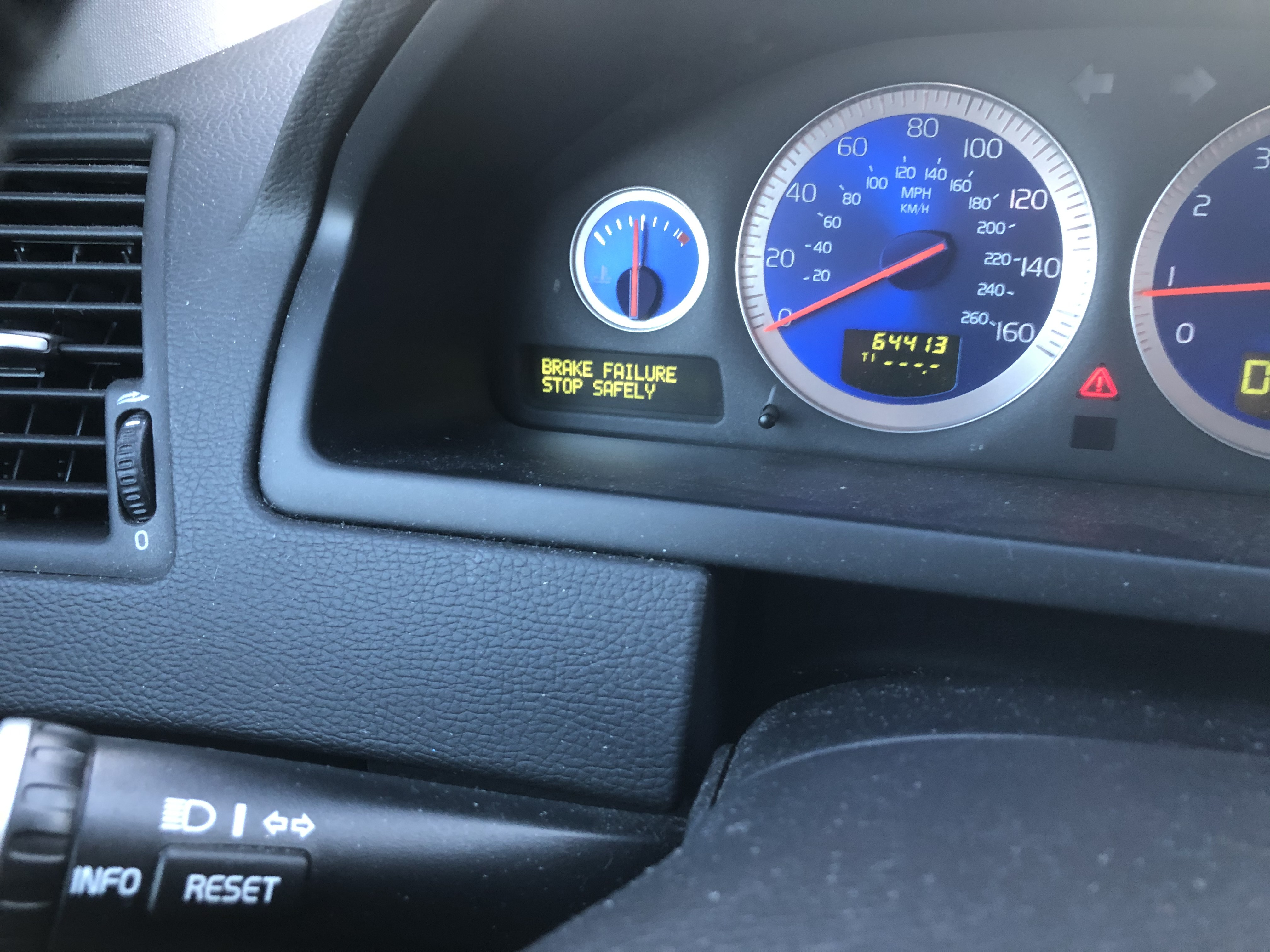

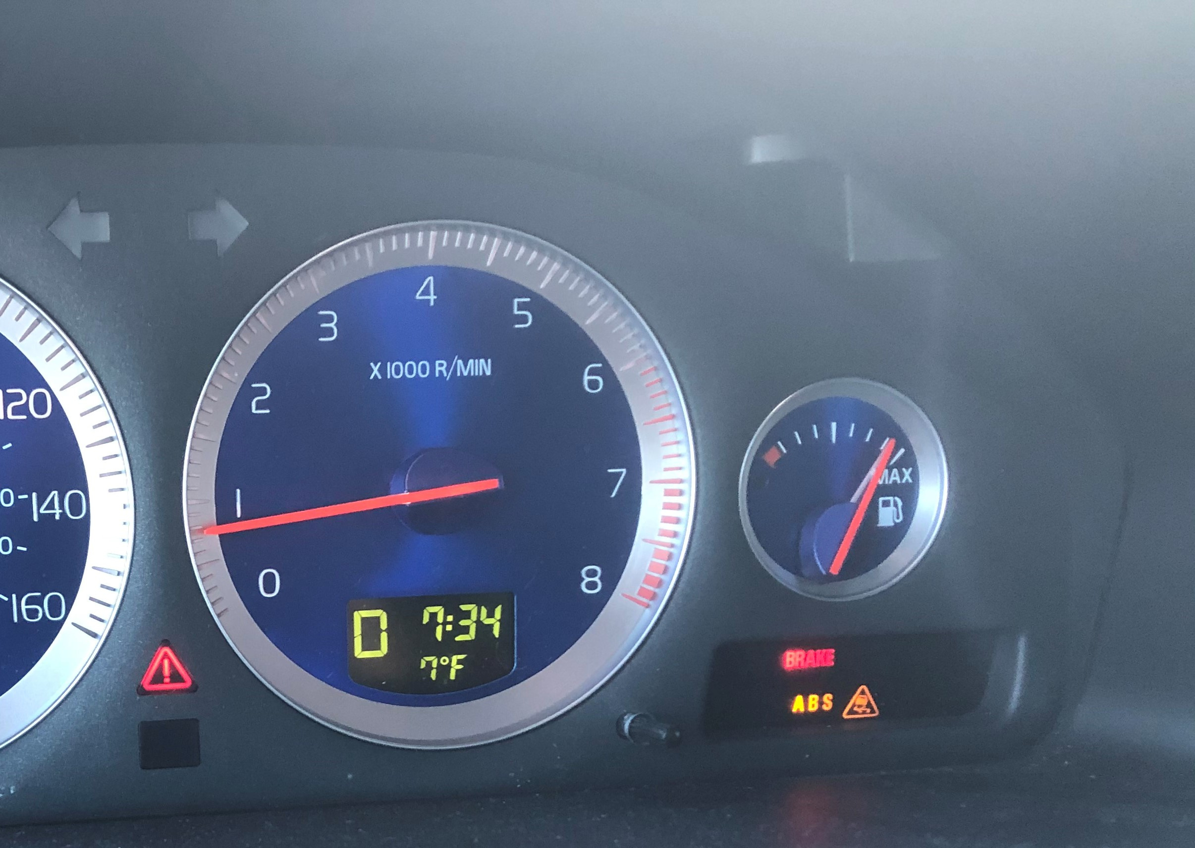

1. "ABS" and "BRAKE" light came on dashboard. Truck brakes fine but haven't had a chance to see if ABS works.

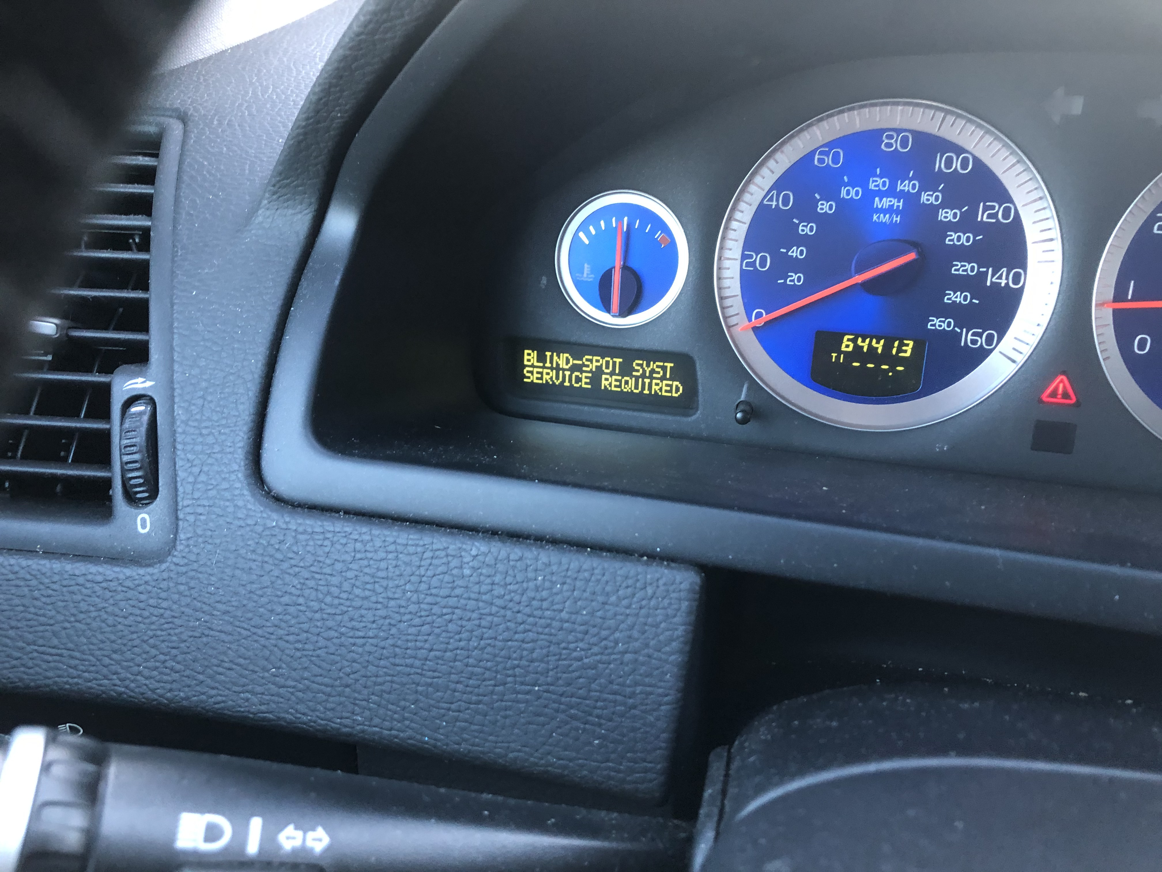

2. Same time "Blind Spot syst service required" light came on.
3. Same time mileage counter stopped working (speedo works fine)
a. Trip odometer not working either. Shows " - - - -"
4. Same time power steering became sluggish/hard to turn. Still some assistance being provided but not all of it.
Trucks appears to have full power. Isn't limping on reduced power as I read sometimes is the case with braking/ABS issues.

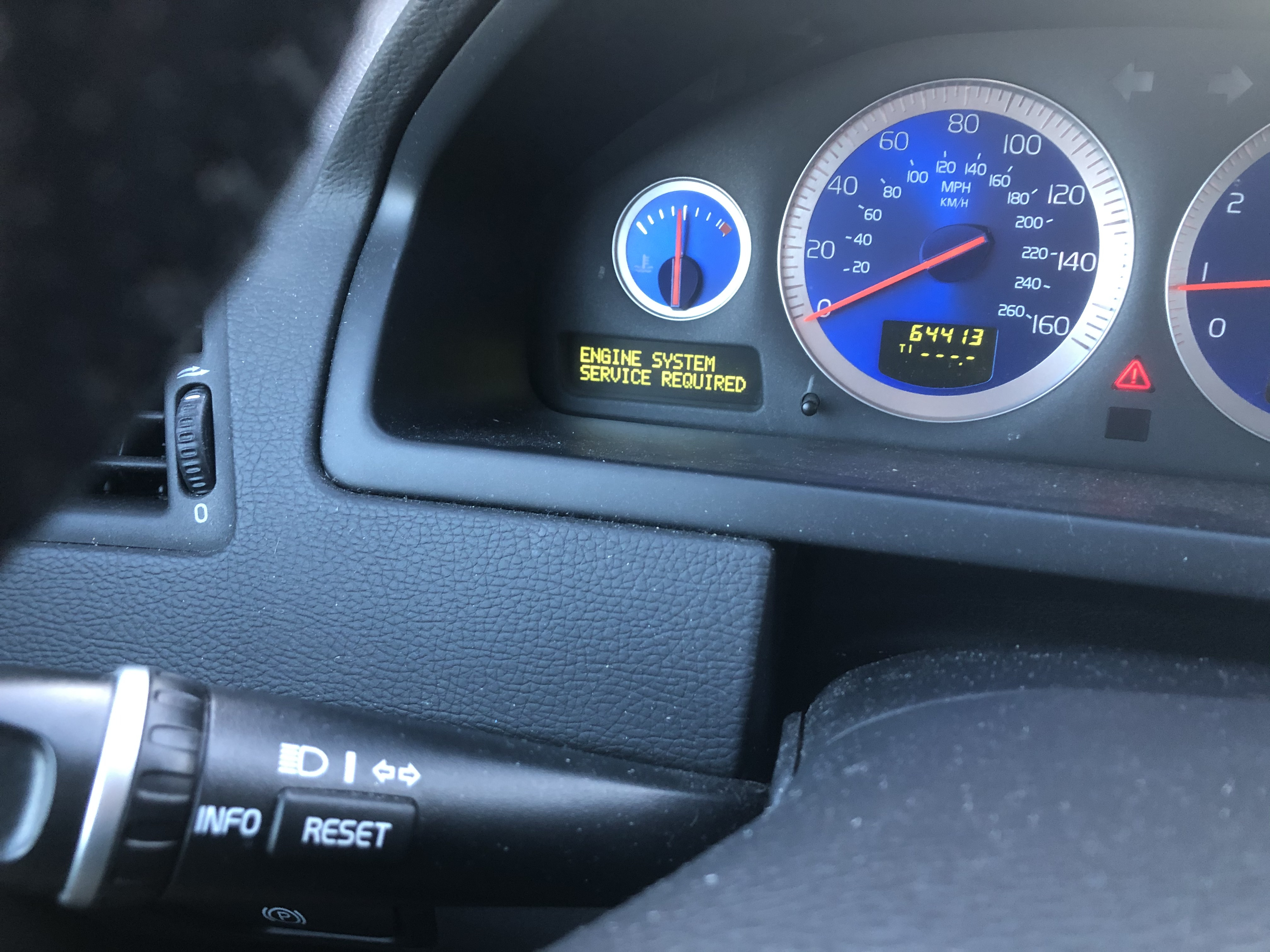

Next morning (today) still all the same as 1-4 above with the added bonus "Engine System Service Required".
Please help! Seems like this may unfortunately be a more common problem.
Thank you so much!!
