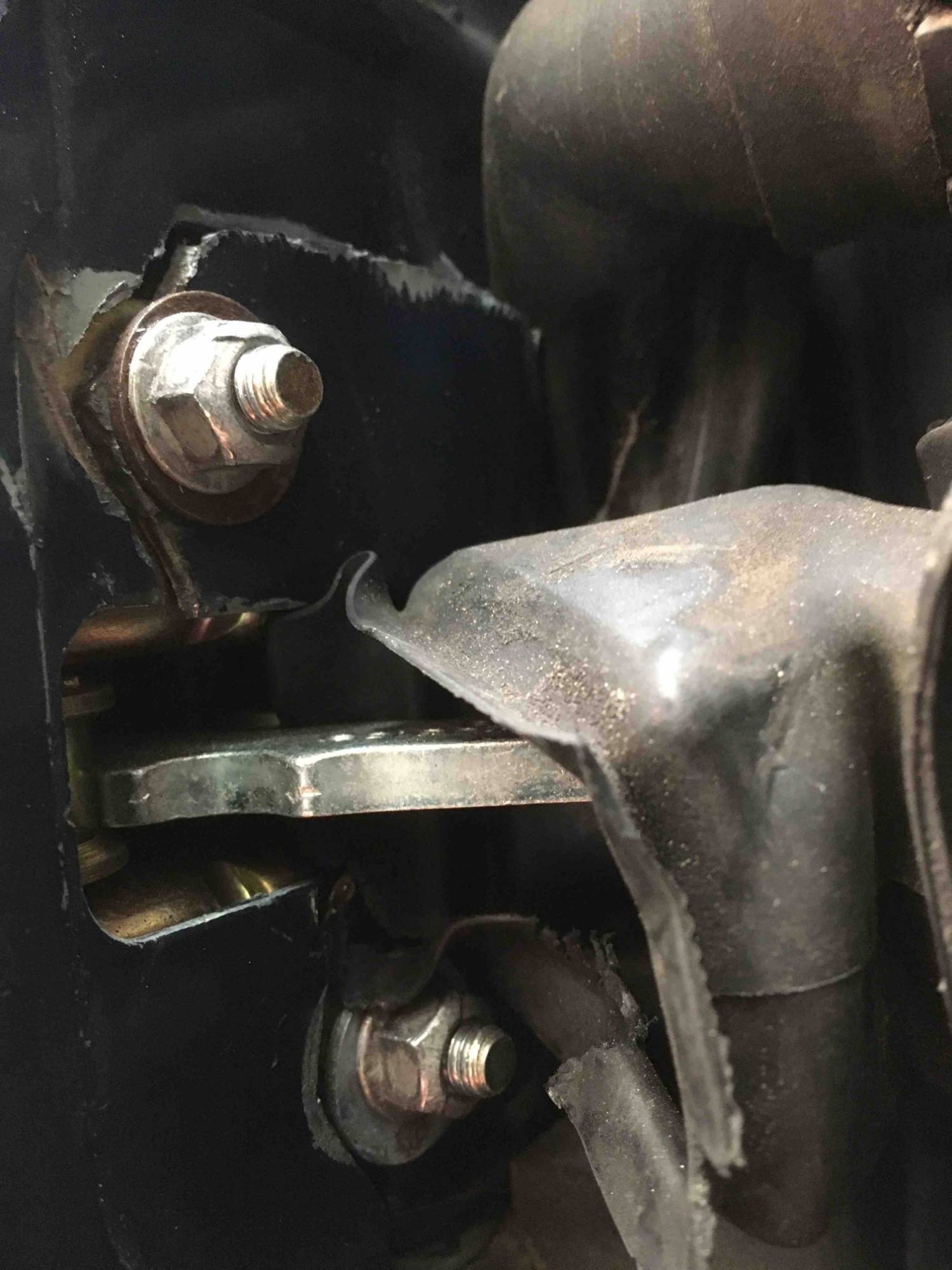

What I did mainly though was address the missing bolts on the rear trans/engine support bracket. Tried loosening the front mount and then putting a piece of wood so I could jack the right side using the big flat area where the trans and engine meet. It got the holes to align more or less but very frustratingly I couldn't get the bolt to start threading. Cue several hours of going back and forth, adjusting the jack a little, checking the hole with a stick, and trying to thread a bolt in.
To add to this, I'm 98% sure the old bolt has broken off inside the transmission for the upper hole. Considering that the car has been running with just one bolt for who knows how long, I'm thinking two out of three bolts should be fine until the engine needs to come out of the car, because I can't think of any way to extract it in place
Lower hole
Upper hole
