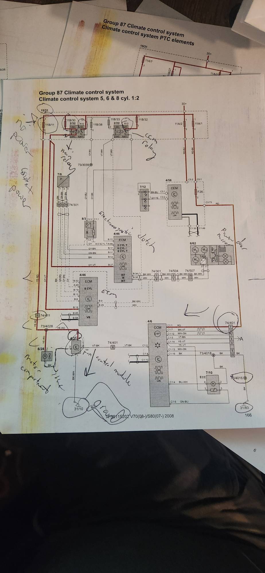

Action #1: So I decided to remove the CCM from the equation(I think). I just removed its electrical harnesses.
Results: Blower keeps blowing.
So to the EWD and I would assume that the signal coming from the CCM would have to be consistent for the resistor to relay what to do with the fan speeds all else remaining equal. Although I will admit I have never looked at an EWD before or troubleshot this type of issue on a car before, so it's possible I'm missing something really basic.
Action #2: I decided to disconnect the resistor.
Result: Blower stops blowing.
I think I would expect this based upon the diagram where the blower motor receives its instruction from the fan control module(or resistor).
Overall: Could it be that I bought a resistor and/or the fan motor was having issues and therefore it blew my resistor? I'm still somewhat baffled, but hope someone would be kind enough to provide some help.
