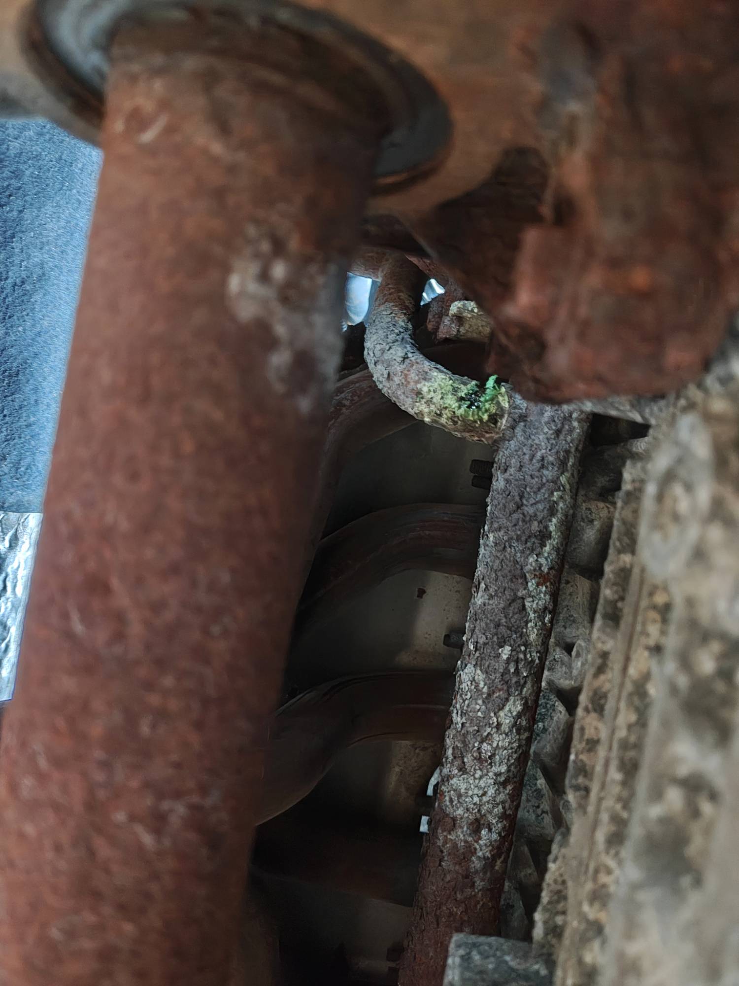

Hi folks,
I'm chasing down a coolant leak on our 98 S70 T5. While investigating I found the metal cooling line that runs between the engine and the turbo in not so good a shape. This is the metal line that runs across the backside of the engine and is above the exhaust manifold heat shield. I've searched and cannot find a part number or anywhere that carries the part itself. Help please!

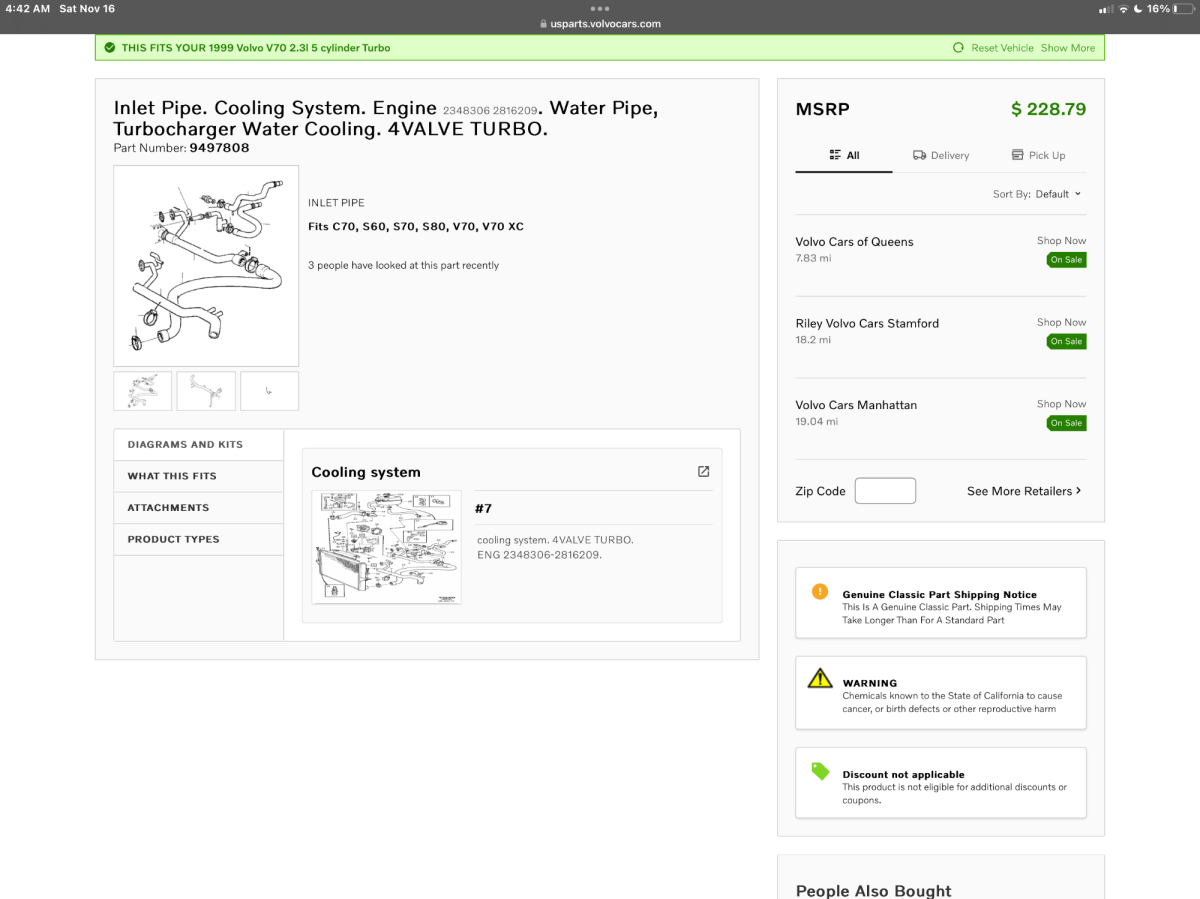

Can you see the part on this drawing?:
https://www.volvocarstorontoparts.ca/a/ ... 66722.html
Sveedy
Posts: 2069
Joined: 11 November 2019
Year and Model: 96 850 Turbo
Location: N. Arizona
Has thanked: 417 times
Been thanked: 457 times
Post by Sveedy »
Yep, at $335 I'd say it's defiantly a junk yard part :lol:

I am also looking for the same pipe for my 1995 855 NA. The section that goes into engine block has a tiny hole which leak coolant out, Volvo discontinued this part for 850.
Posts: 35320
Has thanked: 1507 times
Been thanked: 3824 times
You migh be able to use the 99- pipe
9497007
9497078’
For this application. You would need to replace the lower rad hose for the longer 99 and perhaps block off unused turbo ports
Still available new
