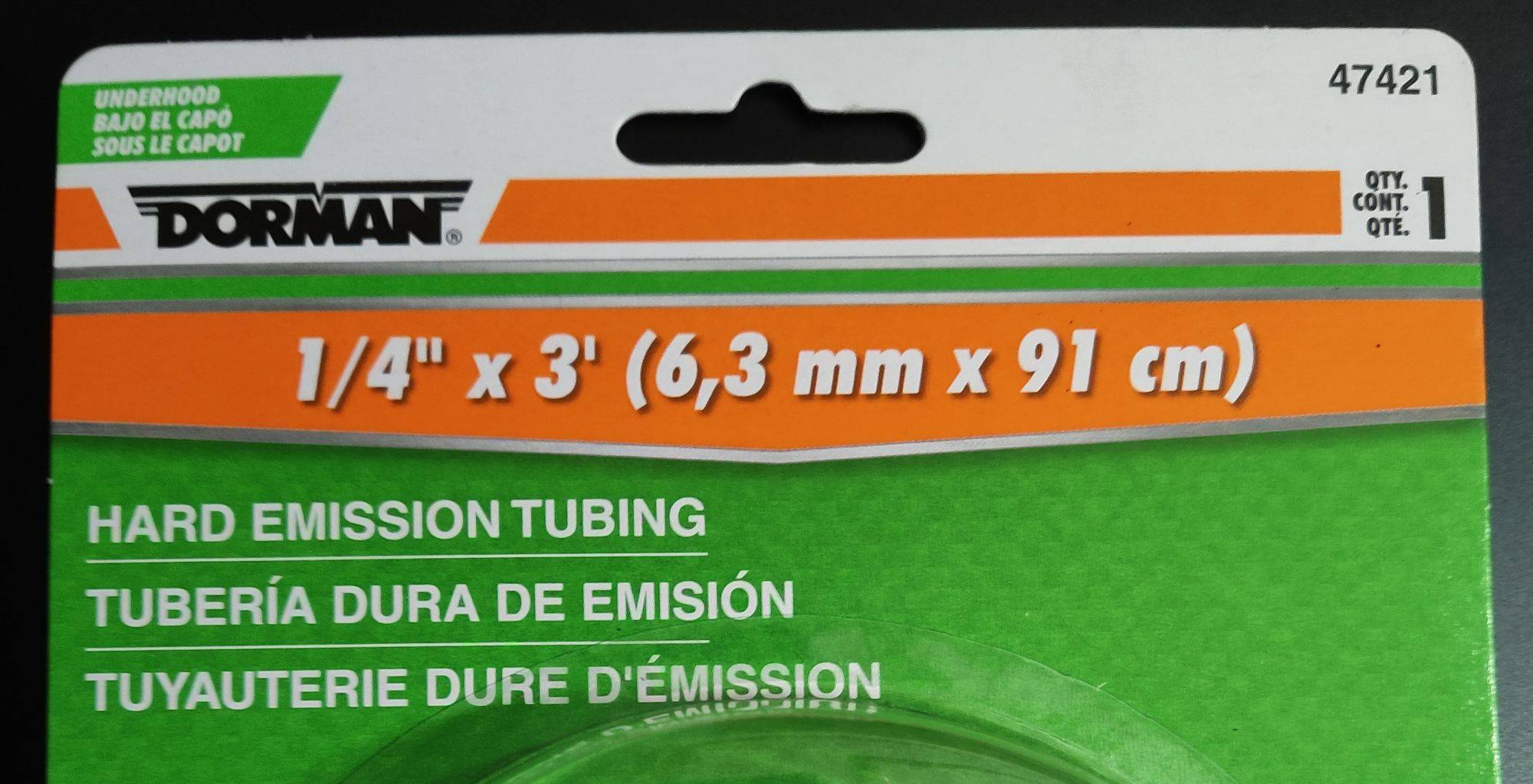

I wanted to post a quick follow-up that the 3/16 is not correct unless the proper connector/coupler tags along. The post (link) that I referenced in my OP turned out to be a 1/4 inch (6.3mm). The latter will fit over the nipples (airbox, CC vacuum) without connectors/couplers. As the referenced linked post shows, a zip tie will do the trick for extra security.
I've attached a pic of the line that I picked up at Advanced Auto Parts:

I have had good luck using thick wall silicone tubing, diameter 4, 6, 8mm to cover different hoses in the engine bay on my 1997 855. One good source is https://www.verociousmotorsports.com/ve ... y-the-foot
