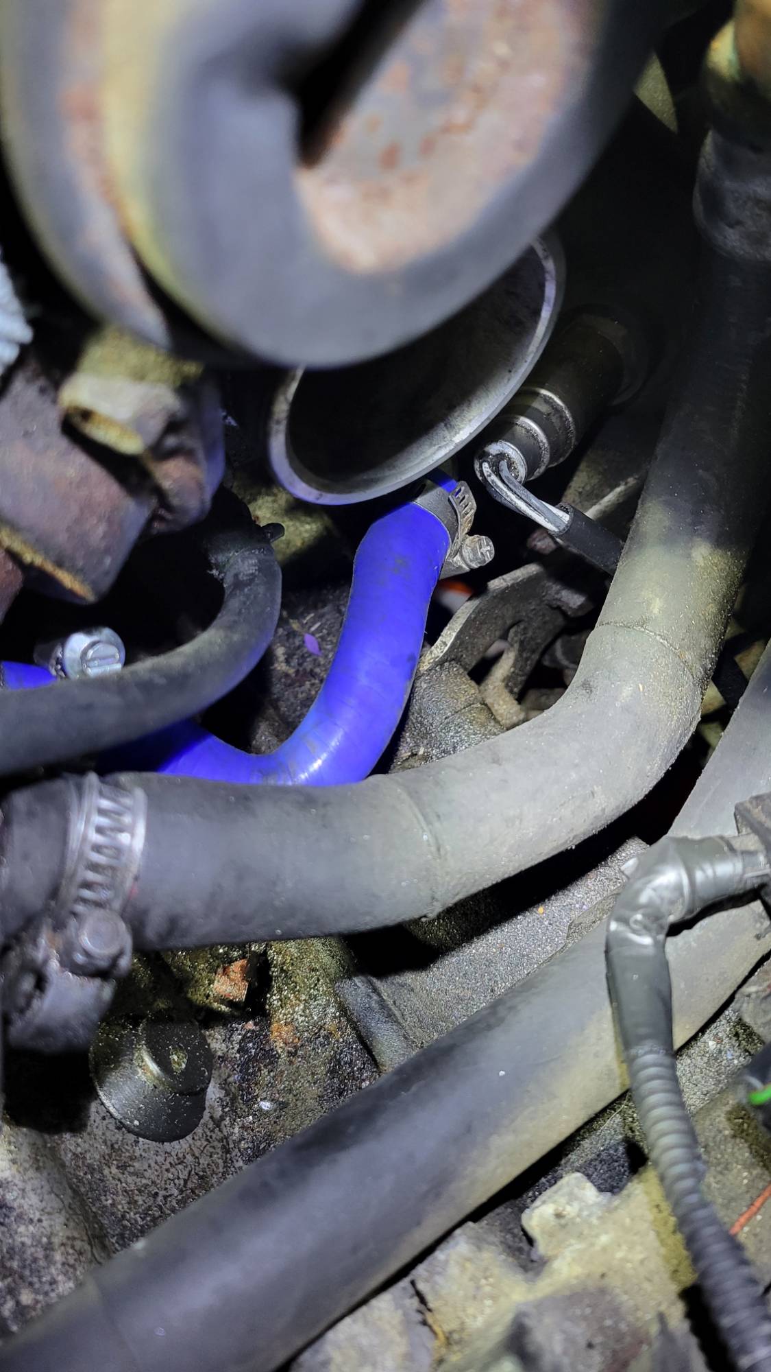

Turbo coolant line, what a pain in the butt silicone hoses are. Almost made me wish I picked up the Volvo OEM rubber hose for $100 before they went on backorder.
This one is from IPD, and seems a little long even though it should be the right size for a 98, a 99 would require trimming.

Did you heat the ends in hot water first?

Yes I did! I boiled the hose as suggested in other threads, sanded and steel wooled the gunk off the pipes, and placed a dab of dish soap on the pipes. It's on there, just a bit twisted. The Volvo OEM hose was much easier on the other car.
The smaller side, the pipe that is attached to the turbo, did move on me under the force of installing the silicone hose. Does this mean the banjo bolt needs to be tightened?
I had pictures of the old hose, and absolutely scary sight when I was under the car at how bloated and soft it was, I think I actually kept the hose itself it was so comical.

You can try and see if the banjo is a little loose. Don't go all Tarzan on it. Just check it is not loose.
You have highlighted why I don't like silicon hoses. In a pinch I'd use them but not my first choice.

Unfortunately for people with pre-99 cars, the options are silicone hoses or aftermarket rubber hoses. This would not be the place I'd like to roll the dice with Uro rubber hoses, especially when I've had their evap hoses split and crack after a few months.
Also found out the exhaust studs are non-magnetic, just a little tidbit. The nuts and washers are still magnetic though.
Trying to clean the block off before putting the head back on, and there is a lot of staining that isn't being removed by acetone, but as long as I can't catch it on my fingernail, I should be good, right? I went through my pictures for the last head I did but didn't take any without the head gasket on.
Also while showing my dad the gaps between each cylinder that are shimmed by people chasing higher performance, I noticed a lot of buildup that kept the feeler gauge from passing through. I ran the gauge back and forth along with a razor blade and seemed to have cleared it out, but it seemed like it had been some type of stop-leak, it was much harder than dried coolant residue.
This is an odd application because one side of the hose is noticeably larger than the other side
