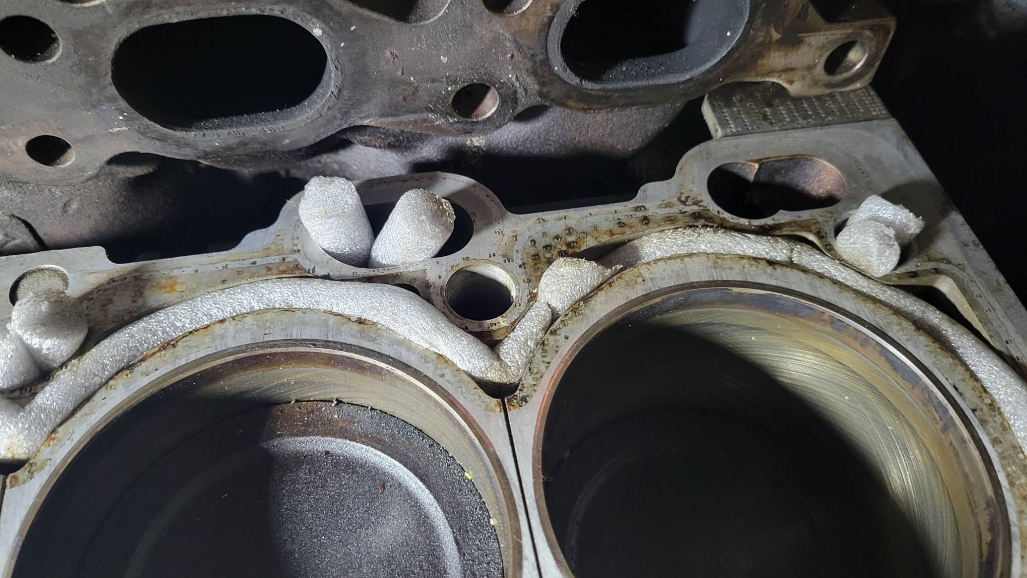

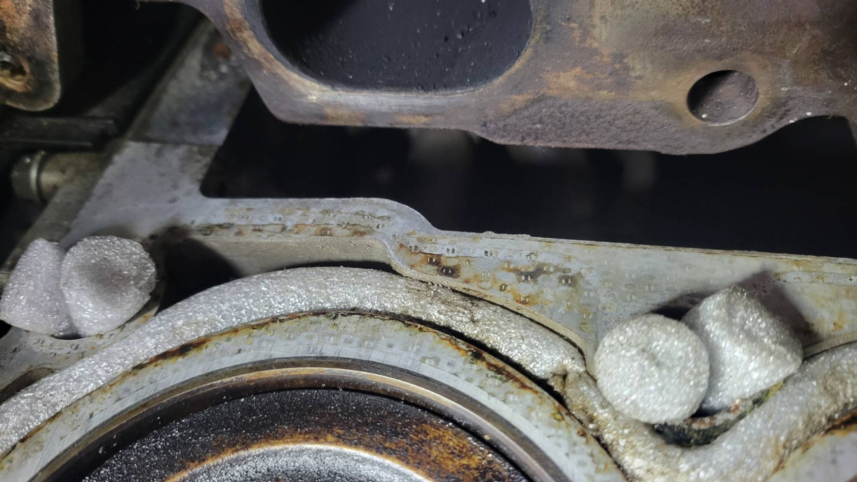

Update on this car, I have the head back from the machine shop with the Volvo steam seals installed, he said the exhaust valves were only holding 8psi in his test, spec was over 20. Valves ground, now cleaning up the block and there are these stains.
Can't catch them with a fingernail but I just don't remember the last block being this dirty. Looks like stains from the graphite gasket.

Scotchbrite pad will clean those up and they will seal fine
Use the Volvo or Corteco gasket.
