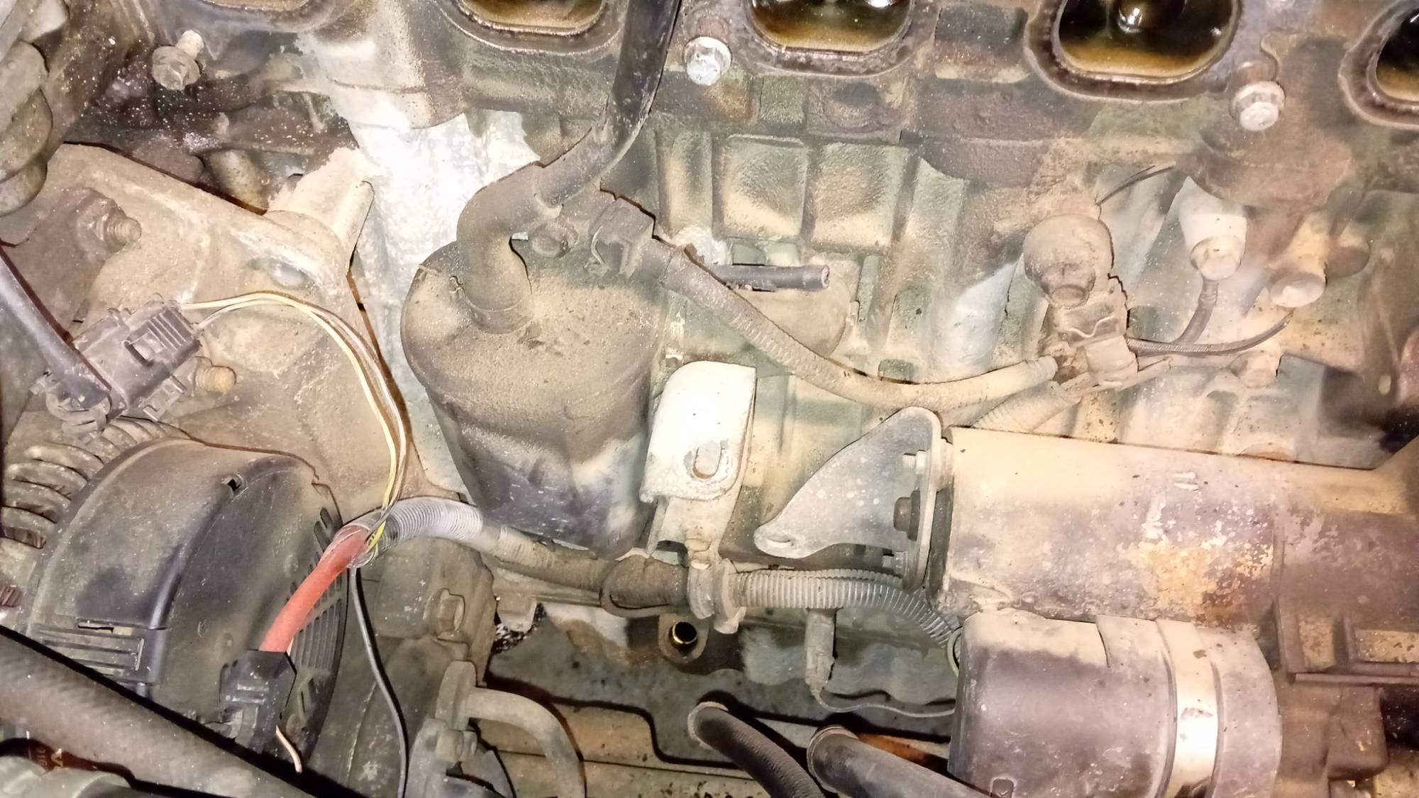

850 1995 pcv system without hose to the head from the oil trap

It should connect to flame trap housing or big plastic hose which goes to throttle plate.

Pcv breather box have only one output?
I can't see clearly....knock sensor connector is blocking the view.
What about that little hose which looks like it's cut?

I see only one port on the breather box from your picture.
Those from the link have two ports.
There is a Volvo part # on your breather box.
Can you read it and post it here?
