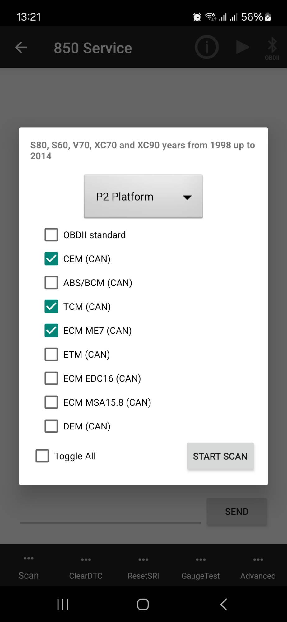

With 850 OBDII App can read from your ECM and TCM at moment additionally to CEM your odometer ("Total Distance") when you do a Scan at Service on P2 Platforms.
Be noted not all ECM ME7(and 7.01) or TCM save and the save location is blank on late model P80 models but on P2 Platform many does save and App will show it then at Summary view very top and when you click on reading i written does it come from TCM, CEM, CEM...
So in Service >> Scan.. just select these and Press Start Scan
P.S. If have 2005 or newer P2 Platform model then in App Settings need change CAN Bus year setting so App can get contact to modules as i didnt make it automatic per design of the App being individual per module.
