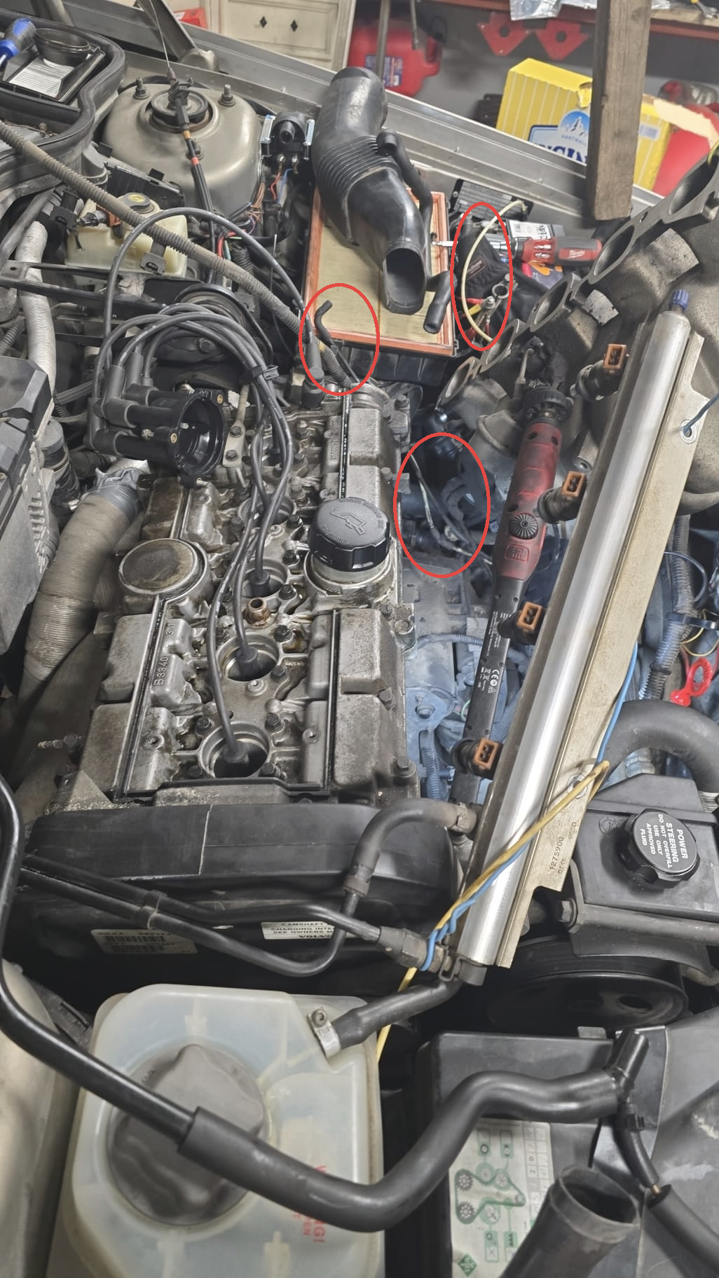

Question: Should I replace all the vacuum lines as well? They’re old and some are cracking. Can I use 5mm silicone hoses and clamps to replace all sizes instead of buying 3mm, 4mm, and 7mm hoses separately? (See attached pictures for reference—yellow and black vacuum lines.)

I believe those lines you are highlighting are vacuum lines so may not work with silicon pipes. Others may have had experience of using silicon pipes on those.
As for the gasket, you may experience some possible reduction in efficiency due to the smaller intake holes, but is the gasket uses all the original bolts/stud holes it looks like it will work in terms of sealing for now.

I would replace all the vacuum lines yes. I've never used silicone hoses so I cannot really say except I know a lot of people use silicone so it must work, still I would get the right size hoses.
I've used rubber vacuum lines instead as they are cheap and I can buy them by the meter. I've also used smaller rubber fuel lines as vacuum hoses, on my 850 in particular.

I think all of those vacuum lines you looked at can be replaced by silicone, but yes rubber works well too. Just don't use silicone where it's exposed to oil. This thread has some tips viewtopic.php?t=65002

erikv11 wrote: 28 Dec 2024, 10:26 I think all of those vacuum lines you looked at can be replaced by silicone, but yes rubber works well too. Just don't use silicone where it's exposed to oil. This thread has some tips viewtopic.php?t=65002
I read the instructions, and they suggest removing the SAS, but I’m not confident enough to tackle that yet, so I think I’ll leave it alone for now. I’m unsure whether I should use a single 5mm or 7mm hose for everything and just tighten them with clamps, or if it’s better to buy individual hoses in the correct sizes. Would it be a bad idea to use a single size for all, or should I manually get each one to fit properly?

As long as the seal is tight on the end, e.g. with a zip tie or a clamp for silicone or a clamp for rubber, then small differences in diameter are fine. I think for the ones you are looking at, 4 mm would be best. If you need something bigger use 3/16 rubber like you will for the "line 3" from the flame trap, or 1/4 rubber if you replace "line 6."
